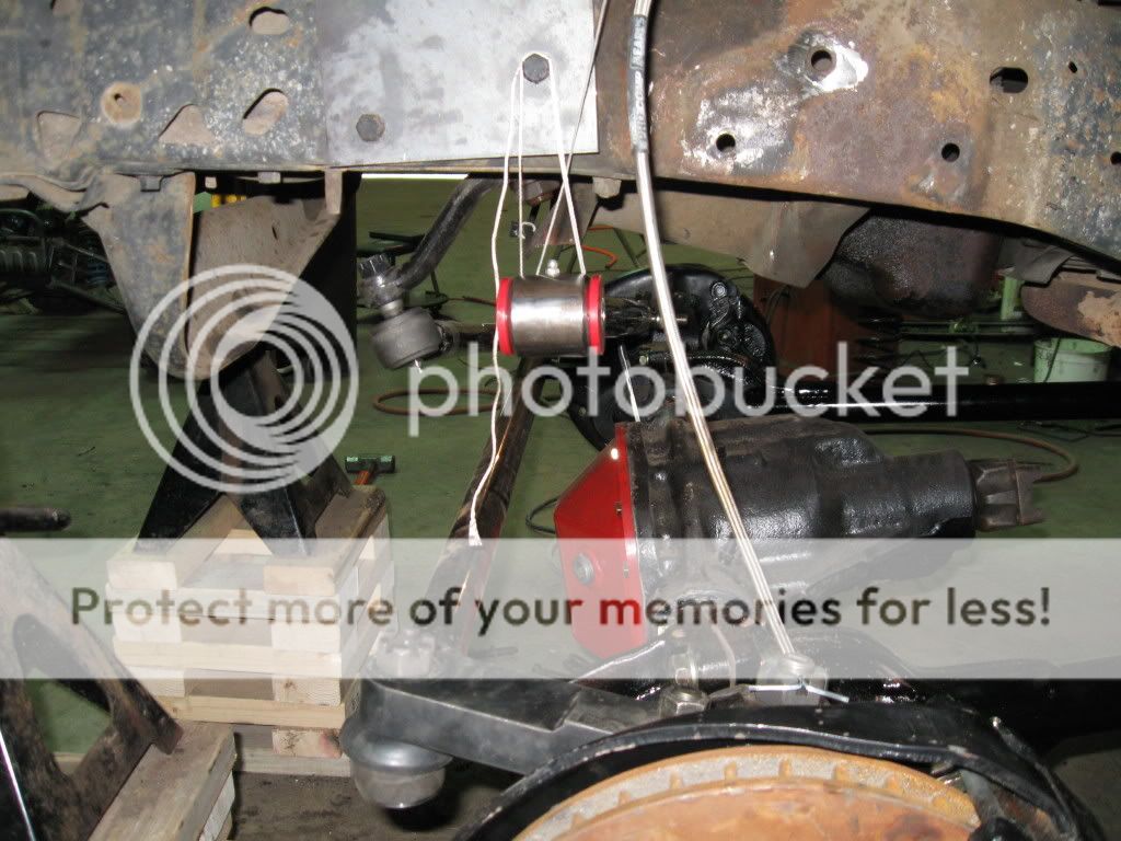

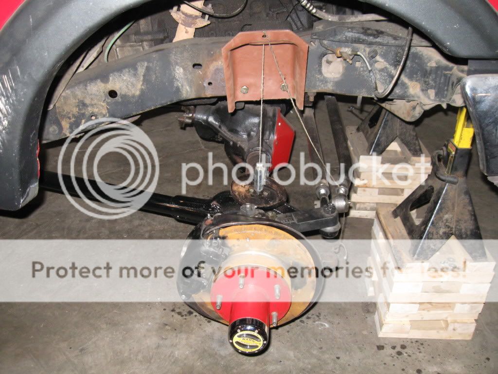

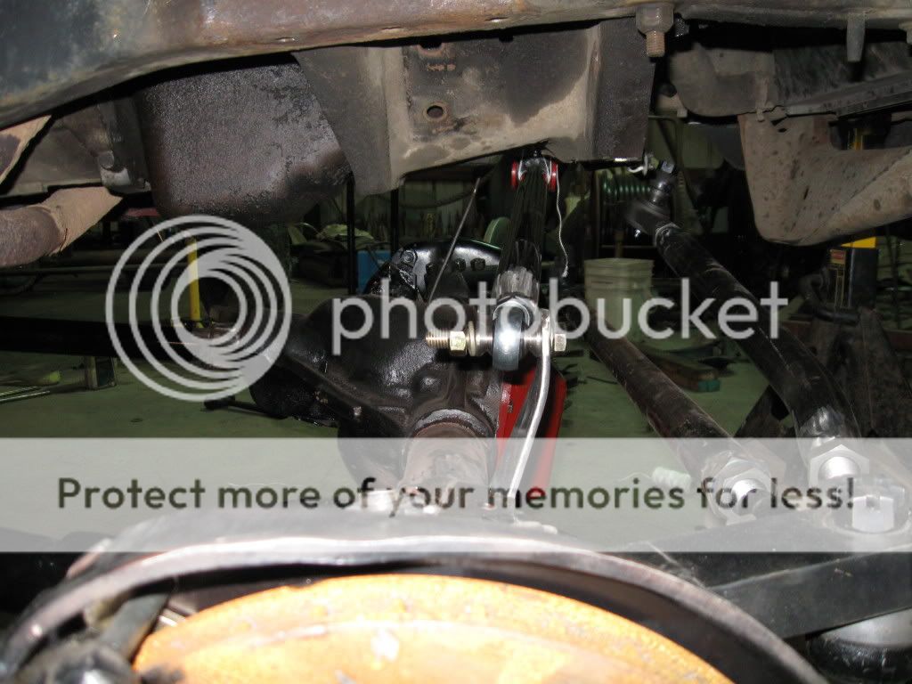

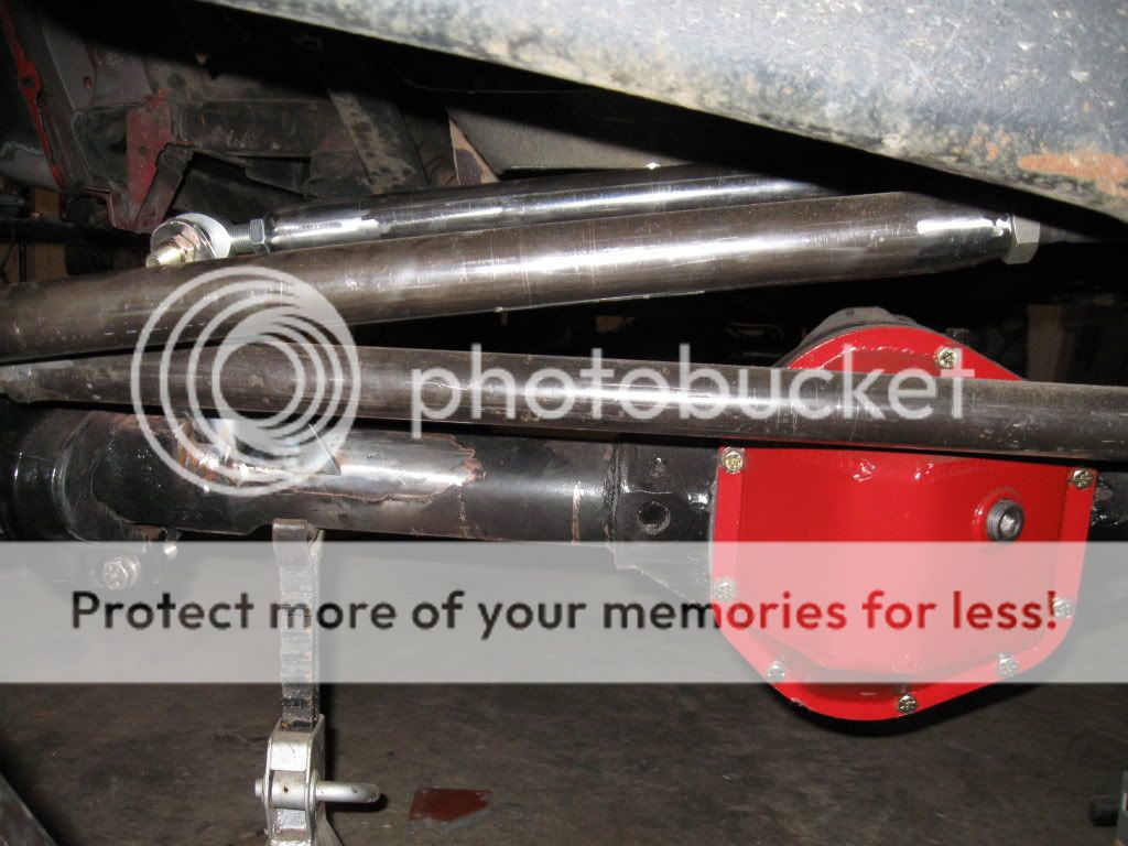

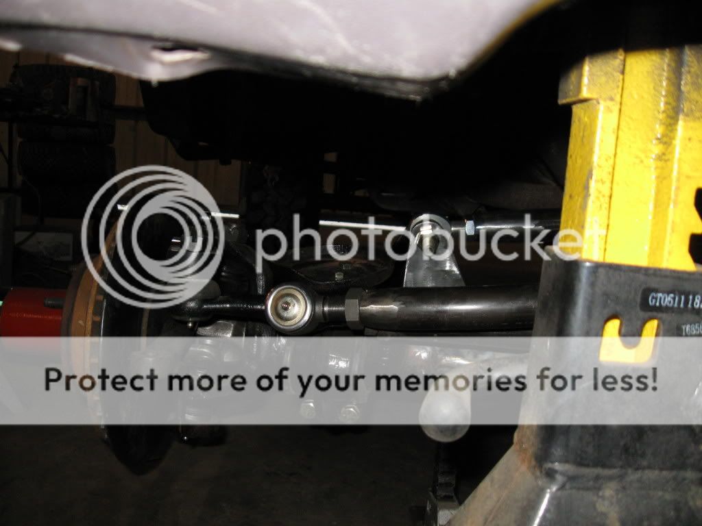

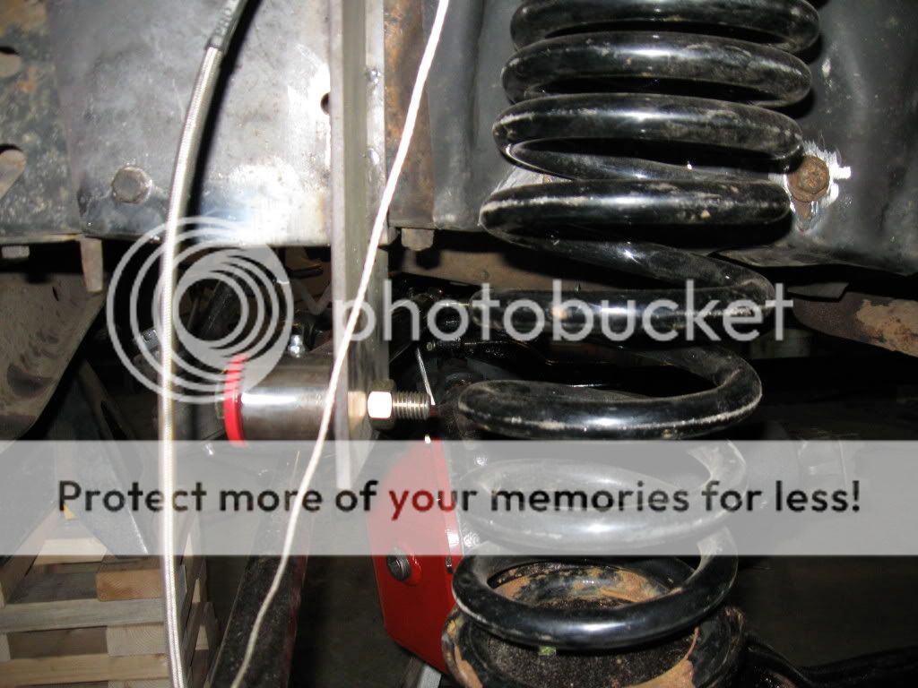

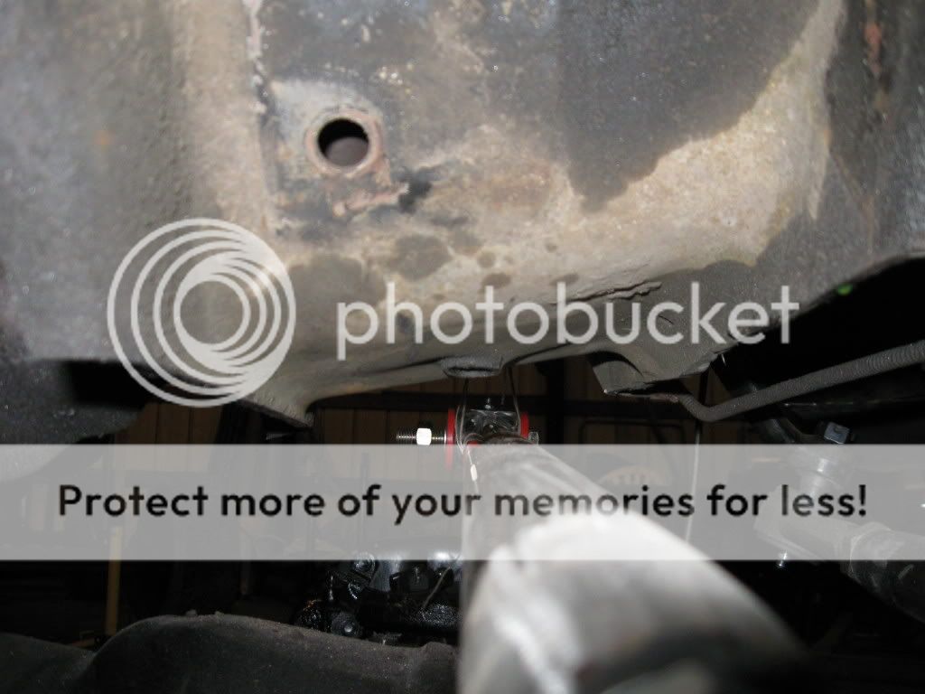

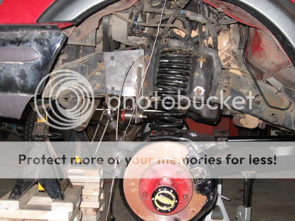

Thanks guys. Well I ran into my first real problem today. Seems there's been little problems around every corner but this is the first one that I haven't been able to come up with a decent solution for. Here's some pics of how I have my track bar mocked up for now:

Its at more of an angle than that after I got my frame side mount built. The right side of the bushing is right below the right side of the right-most steering box bolt (follow that?). I had to push it out that far to clear the coil spring (not shown in pic). This puts a decent angle on the trac bar.
When viewed from the front, the frame side bushing's mounting hole sits almost right below the face of the frame, leaving ~1.5-2" of the bushing past the frame. This would interfere with the coil spring if I mounted it in the center of the coil bucket (to make the track bar on the same plane as the axle).
I guess I have a couple options.
1) Rotate the axle side bracket so the joint will be more forward - helping with the track bar alignment. Doing this will require me to trim the front of my engine crossmember off as the bar will interefere during compression.
2) Cut the track bar down, and mount it centered with the coil bucket. This would put the track bar in the same plane as the axle and make it so I would clearance the center of the crossmember, keeping the strengthening lip at the front. Down side is my track bar would be ~2" shorter than my drag link and bump steer would be inevitable.
I'm not sure what to do. I'm tempted to just mount it like it is - since I have the frame side bracket halfway done (mounting plate is done and one side of the bracket is welded on) and the axle side tacked. Run it like that, observe what needs done, then revise the track bar design later. Only problem with this is I'd really hate to have to cut the axle side mount off and build another one, that'd be a lot of cutting/grinding/cleaning up housing, and I'd rather weld on my housing the least amount possible.
Mounting it under the coil would clean up the front a lot, its pretty tight with it mounted at the angle, being that length. Depending on the amount of uptravel, I may run into problems of the steering contacting the joint at that location.
Any ideas?
i would put it in line under the bucket with double shear on both ends, shortening it slightly to do that and possibly putting a small bend in it doent usually give bad bump steer.
from the pics i dont see a problem with that.
Thanks for the reply bobby. I think I'll knock the axle side mount off, notch the bottom of it and move it back so it's halfway on the cast and half on the axle tube. That way it'll be as long as possible, but mounted under the bucket. I measured yesterday, and it should only be ~1" shorter than the drag link if I do that.

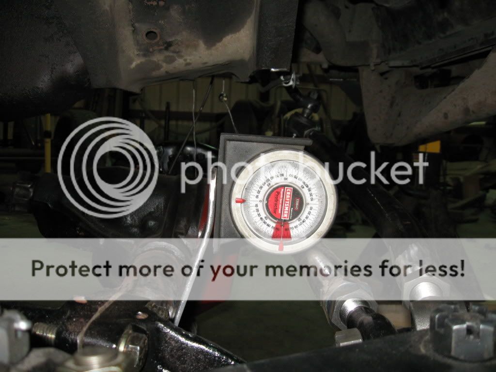

Good tech on the pitman arm. I knew I would want a shorter pitman (I had a drop arm), so I got ahold of a stock one before the build. That's what's on there now. At ride height the drag link is at ~ 9.5*.

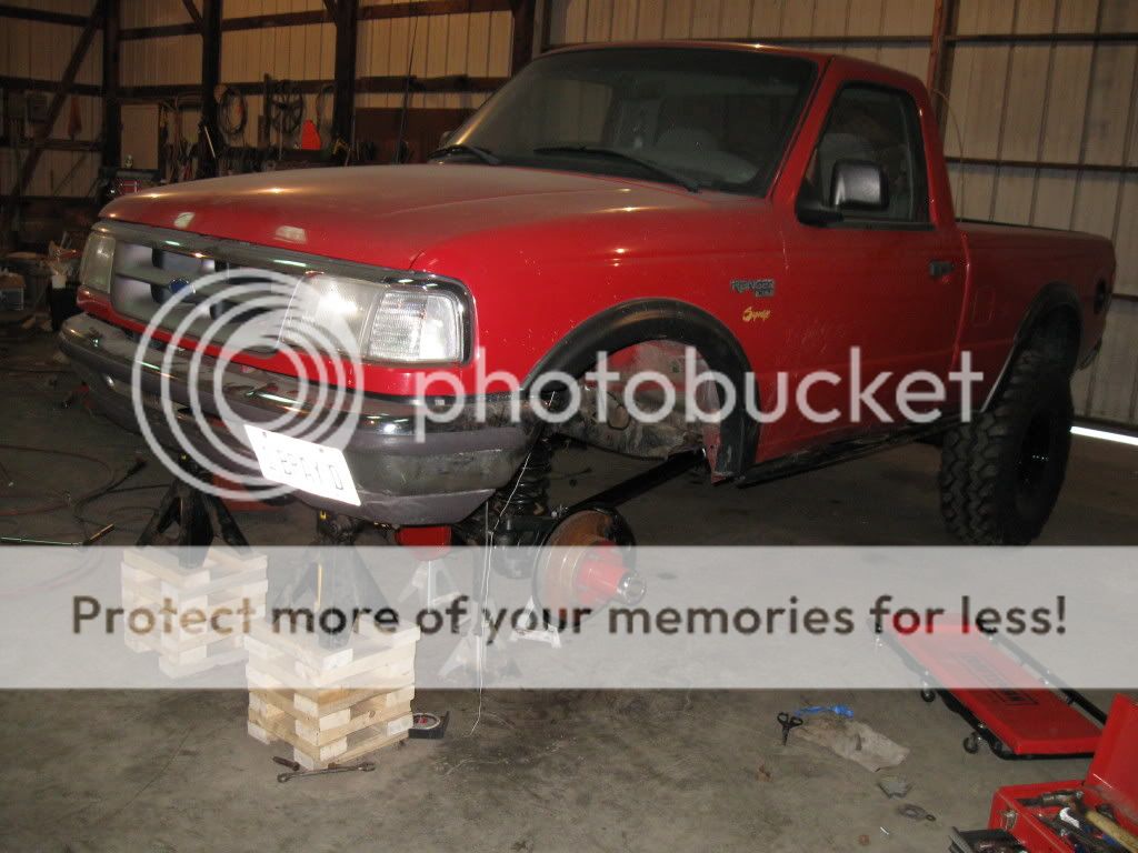

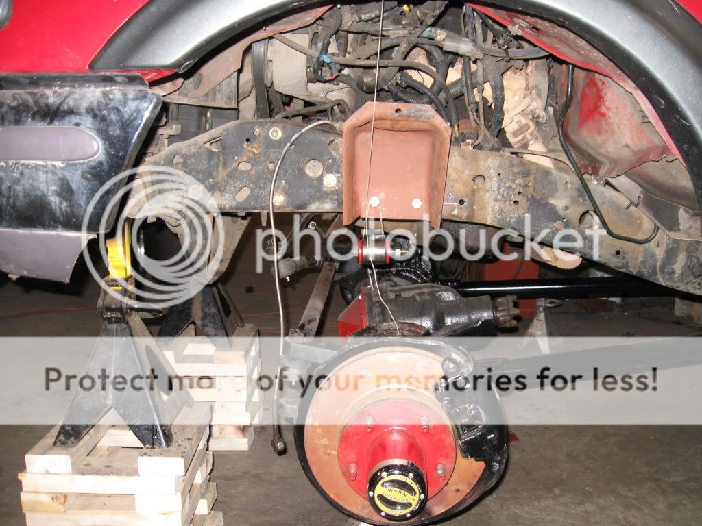

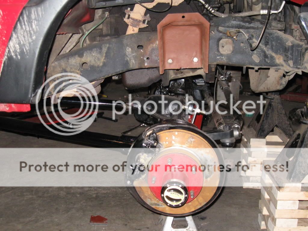

Ok here's the pics
I started by bolting up the stock buckets, and getting it to support its own weight (with the old track bar setup). Once it was on the springs, I could see where it was gonna sit and modify the full size buckets accordingly. You can see how much I pushed the axle forward with this pic

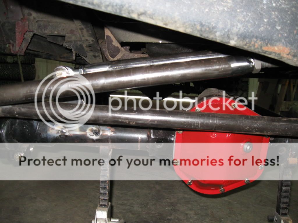

and a pic of the track bar path

I went ahead and knocked the old track bar setup off, then cut the full size buckets, drilled and installed.

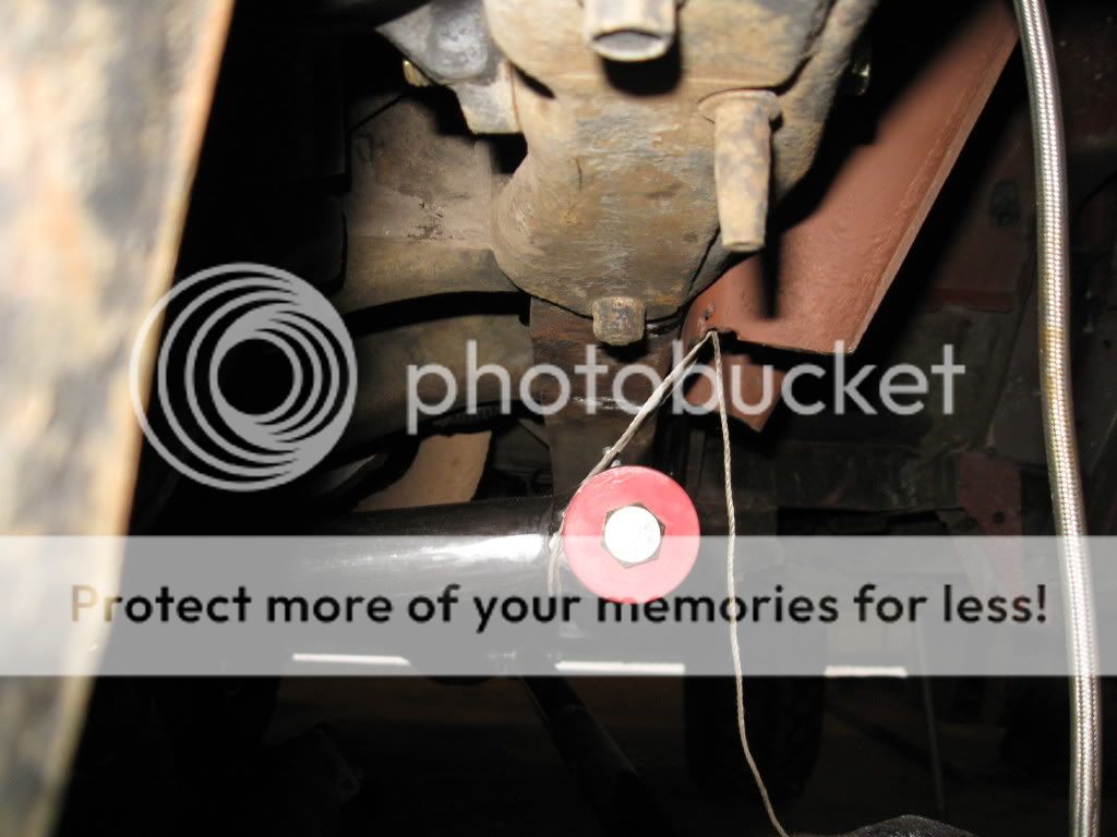

How close it is to the pass. side spring
daily doubler build
and the frame side
daily doubler build
daily doubler build
and the path.
daily doubler build
the whole in the middle of the engine crossmember is where the oil pan drops down lower. Staying at or in front of this hole will gain some clearance for the track bar at full compression, after clearancing the crossmember of course.
The buckets aren't done either, I'm going to add the piece that attaches under the frame as well.
For the frame side trackbar mount, rather than having it angle around the frame, and bolt over the bucket, what is the down side to integrating it into the bucket itself - so the mount and bucket are one piece? This may cause problems if I need to service just the mount, or just the bucket, but how often does that happen? Any thoughts on that idea?
I'd do it that way. When I fab new buckets, thats what I intend to do as the factory buckets mount under the frame as well as the sides and the fullsize's do not. Tying the track bar mount into the engine crossmember and the coil bucket should help support everything.
