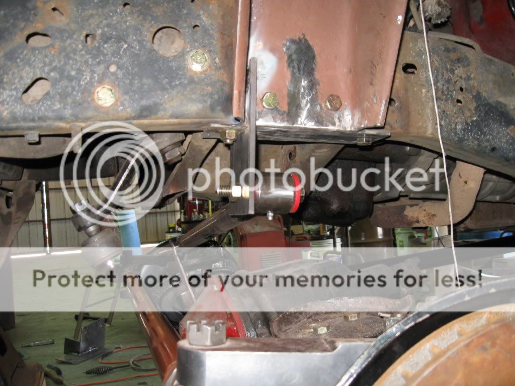

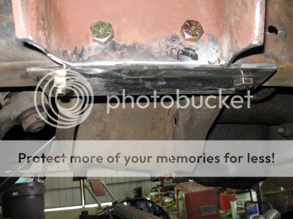

Added lower plate to the buckets. I used the factory holes in the frame, as seen by the offset

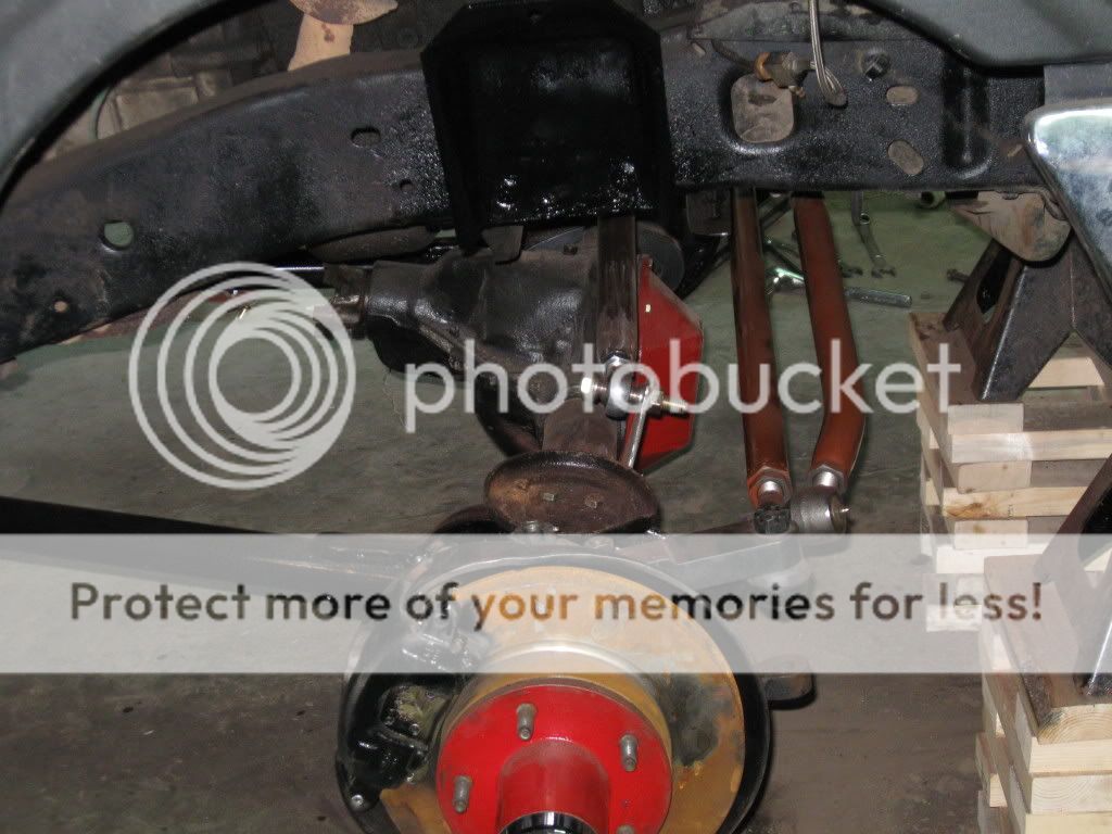

Tied the driver's side into the engine crossmember
daily doubler build

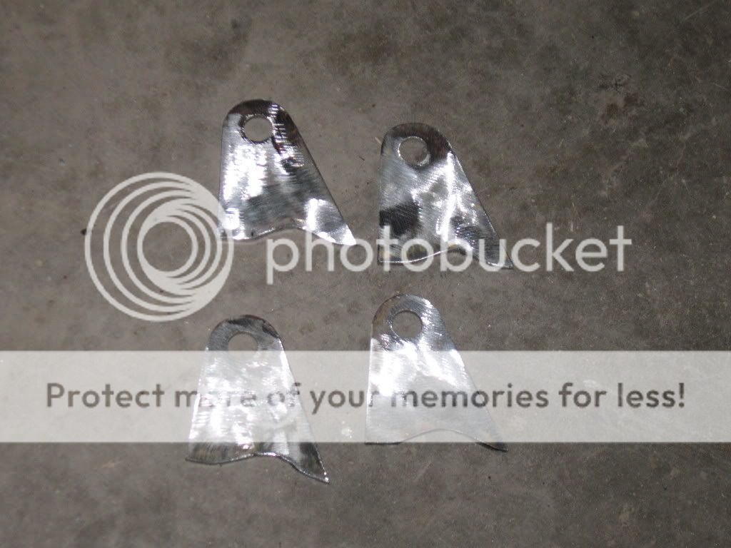

And tacked up the frame side track bar mount. Primed the drag link/tie rod so they'll be ready for paint tomorrow. Turns out I didn't need to shorten my track bar at all, lucky me.

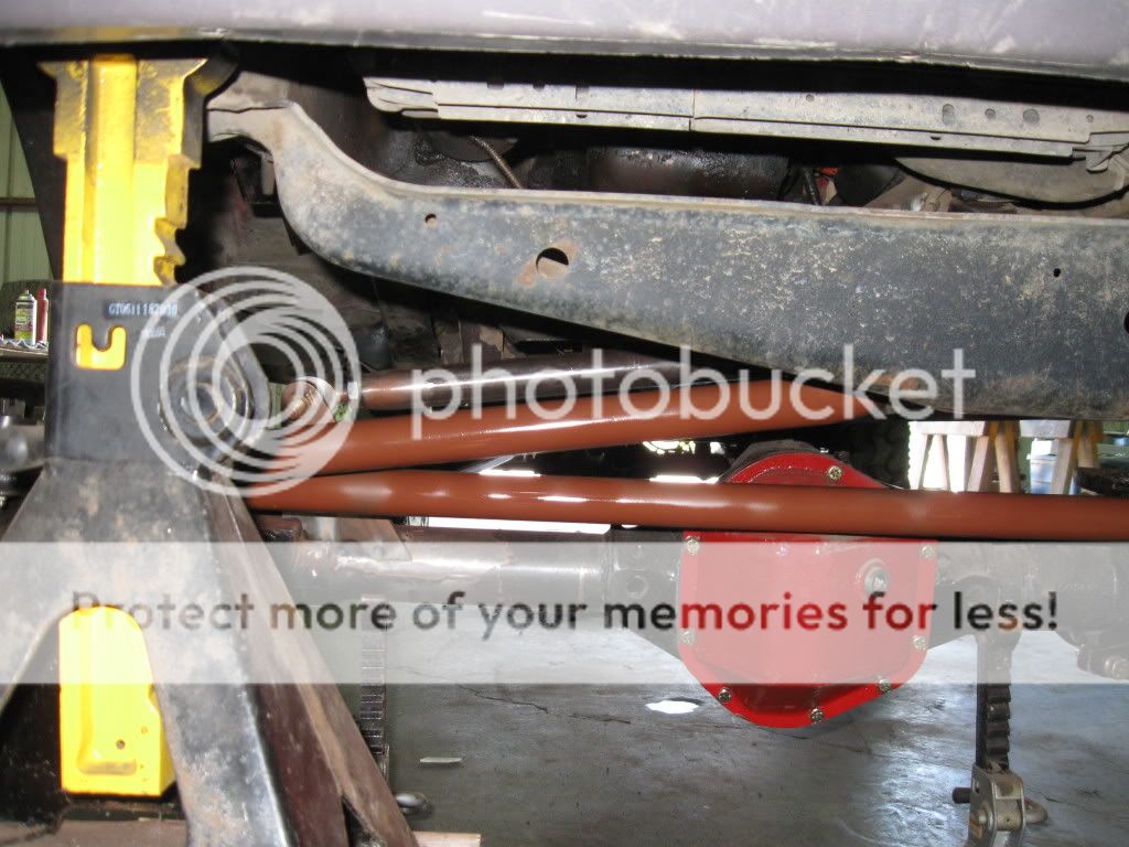

Ok, more progress. Slowly but surely.

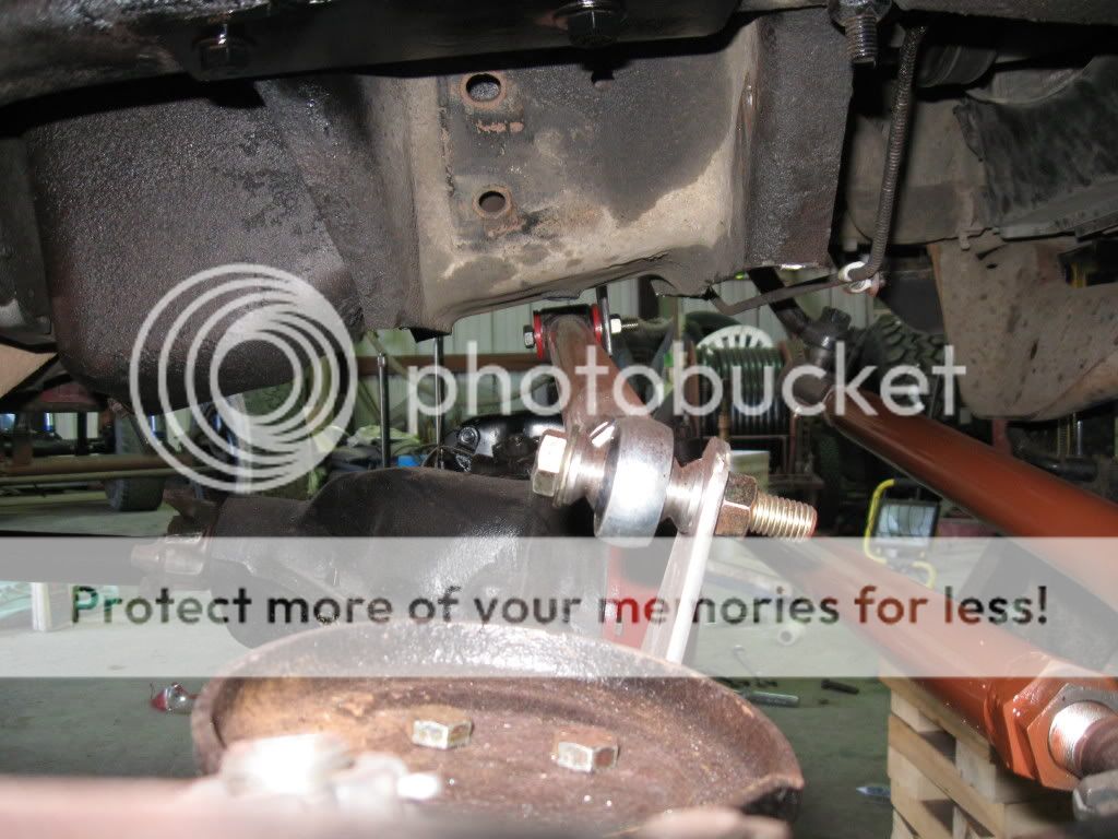

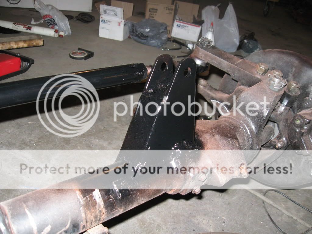

Started by pulling it back out, and finishing the axle side track bar bracket
daily doubler build
daily doubler build

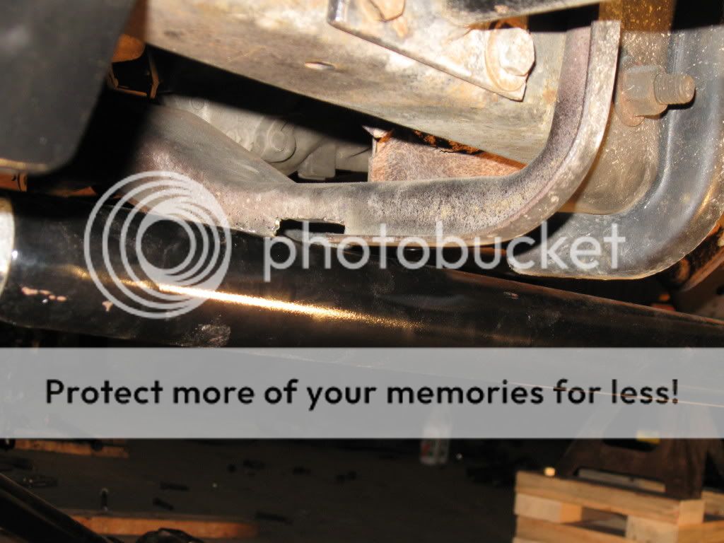

Trimmed the tranny crossmember. I'd plate it now, but I'm not sure if its gonna be enough. I'll finish it after I get my suspension figured out (bumpstops/limit straps)

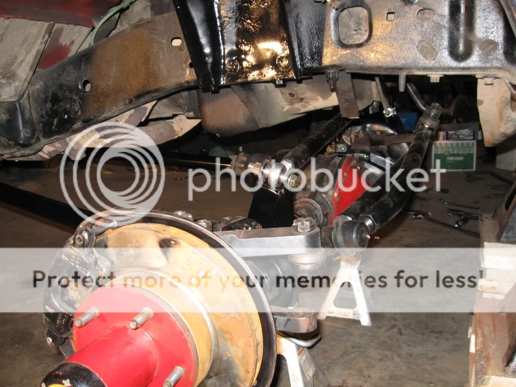

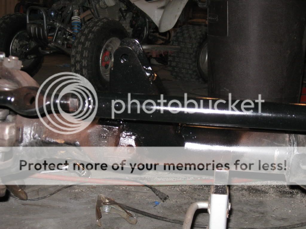

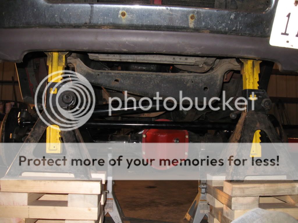

Painted drag link, tie rod, and track bar and reinstalled everything
daily doubler build
daily doubler build
