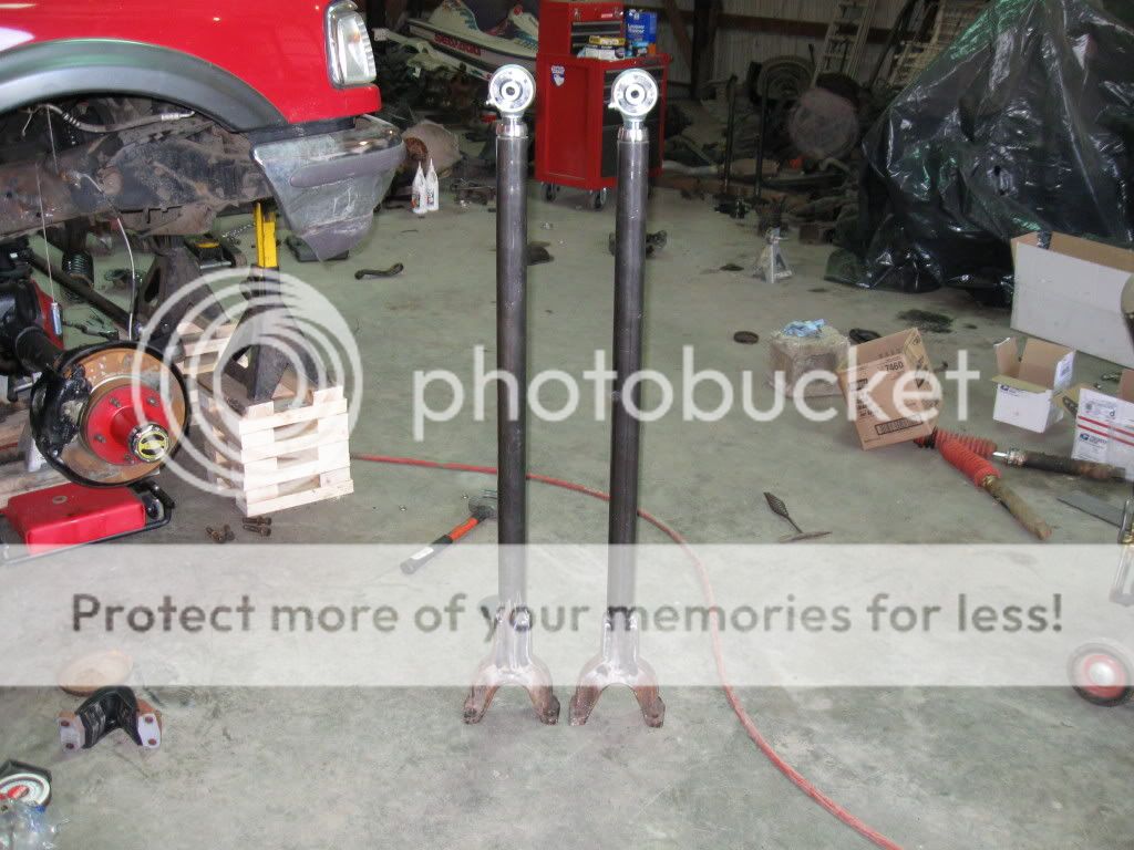

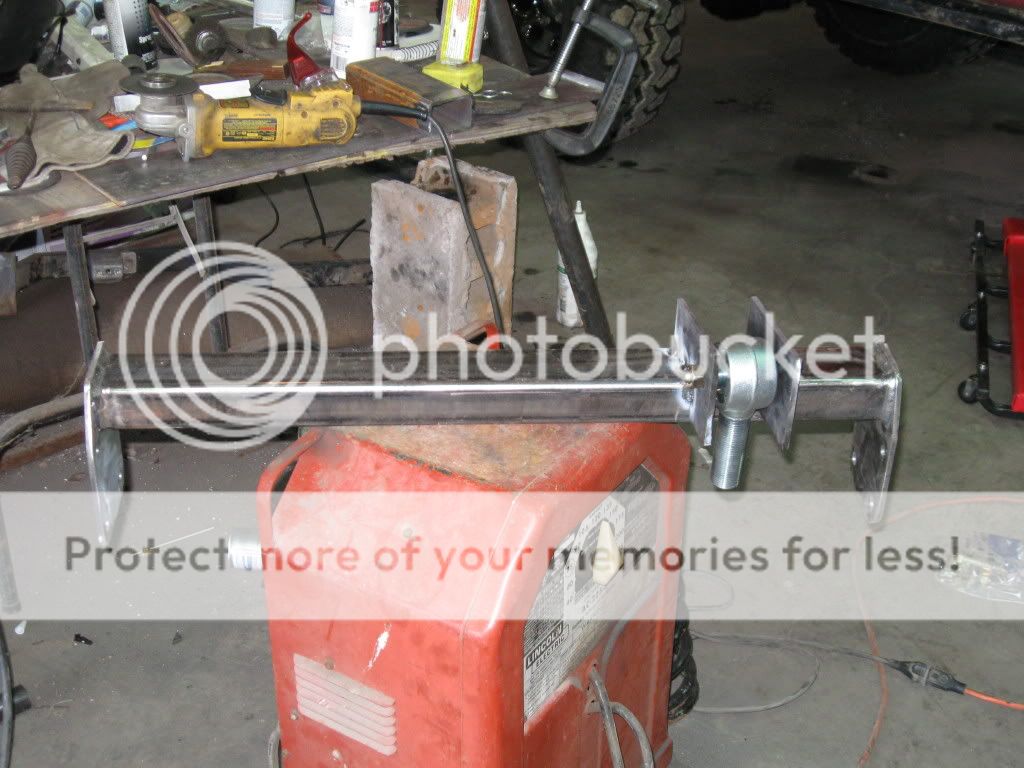

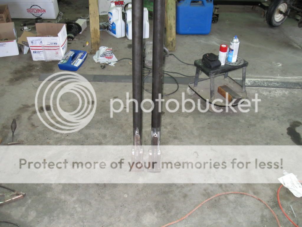

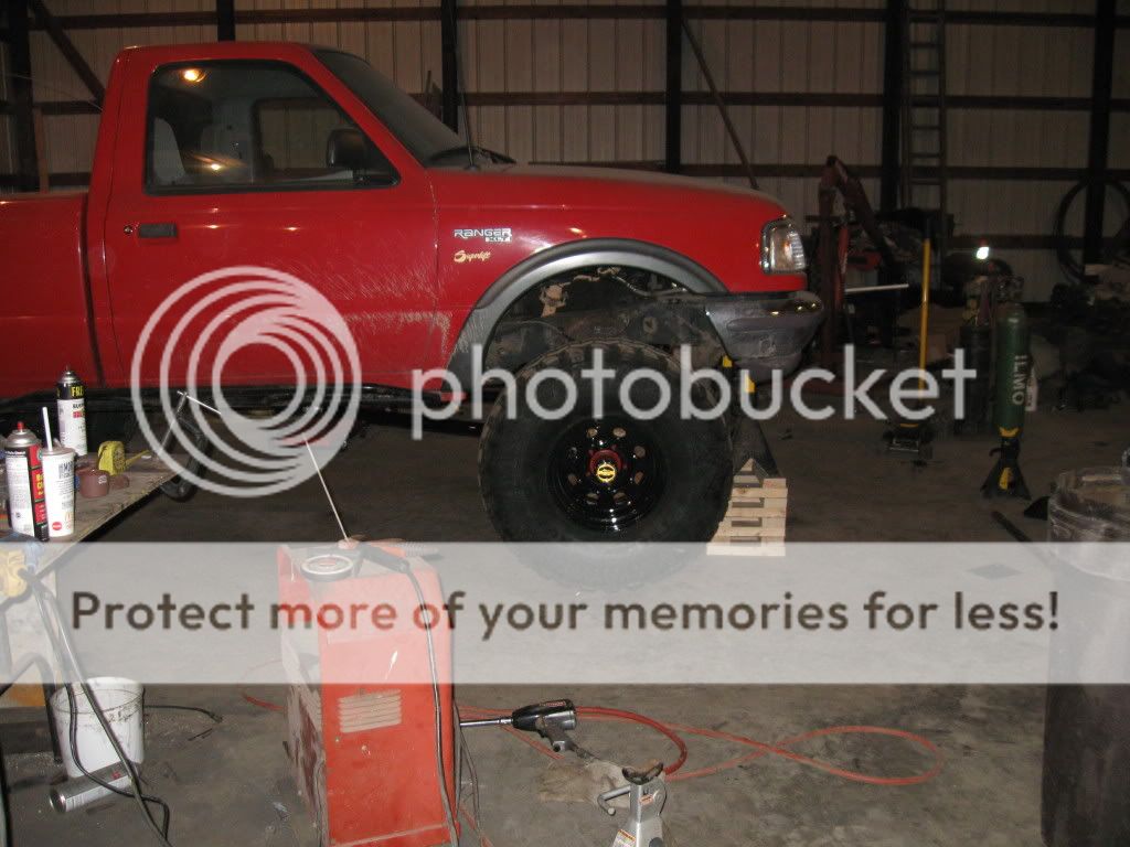

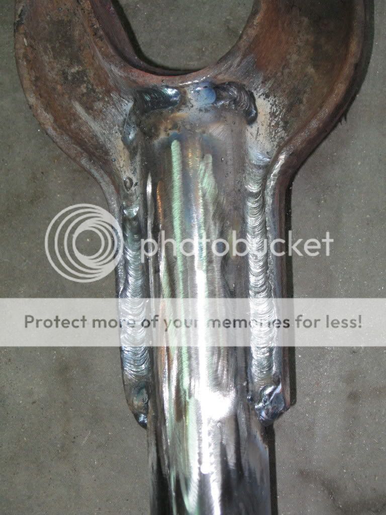

Radius arms ready to be welded
daily doubler build

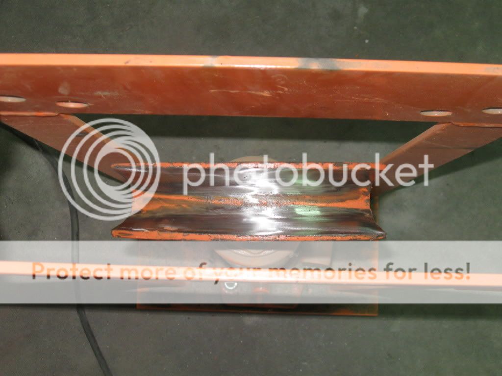

Should I take another pass or call it good? This was welded up on 135 amps
daily doubler build
I might have to build a set of these for the BroncoStar. RB
Meh, I'd say it burned in pretty good judging by the undercut seen on the original radius arm piece. Like I said I took 2 more passes on em, no worries now.

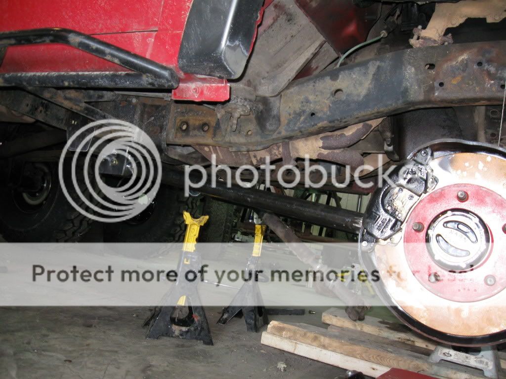

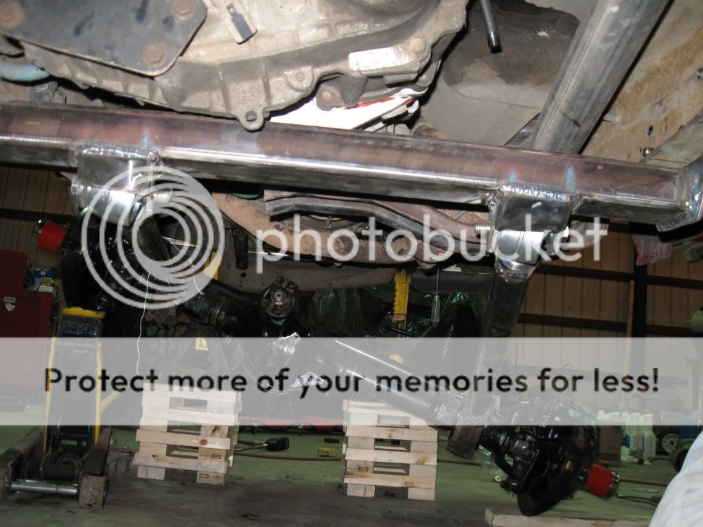

Decided what I'm gonna do for coil buckets/axle position and cut the RA's to length
daily doubler build

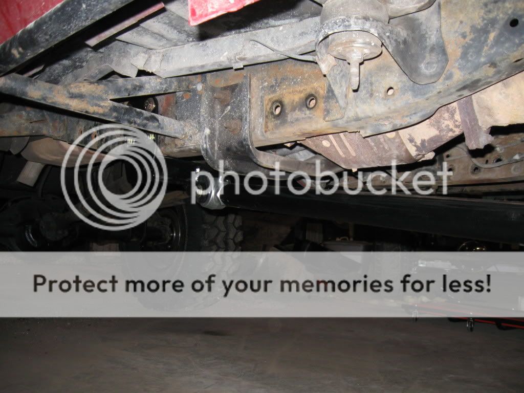

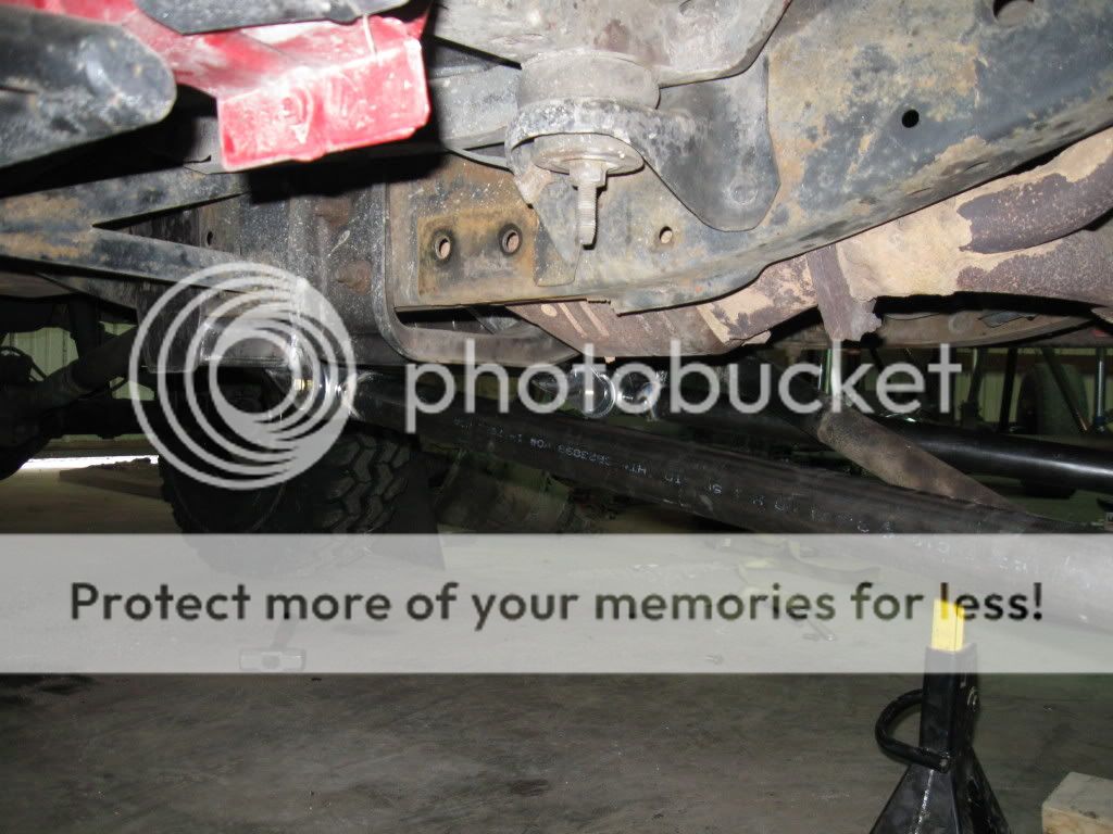

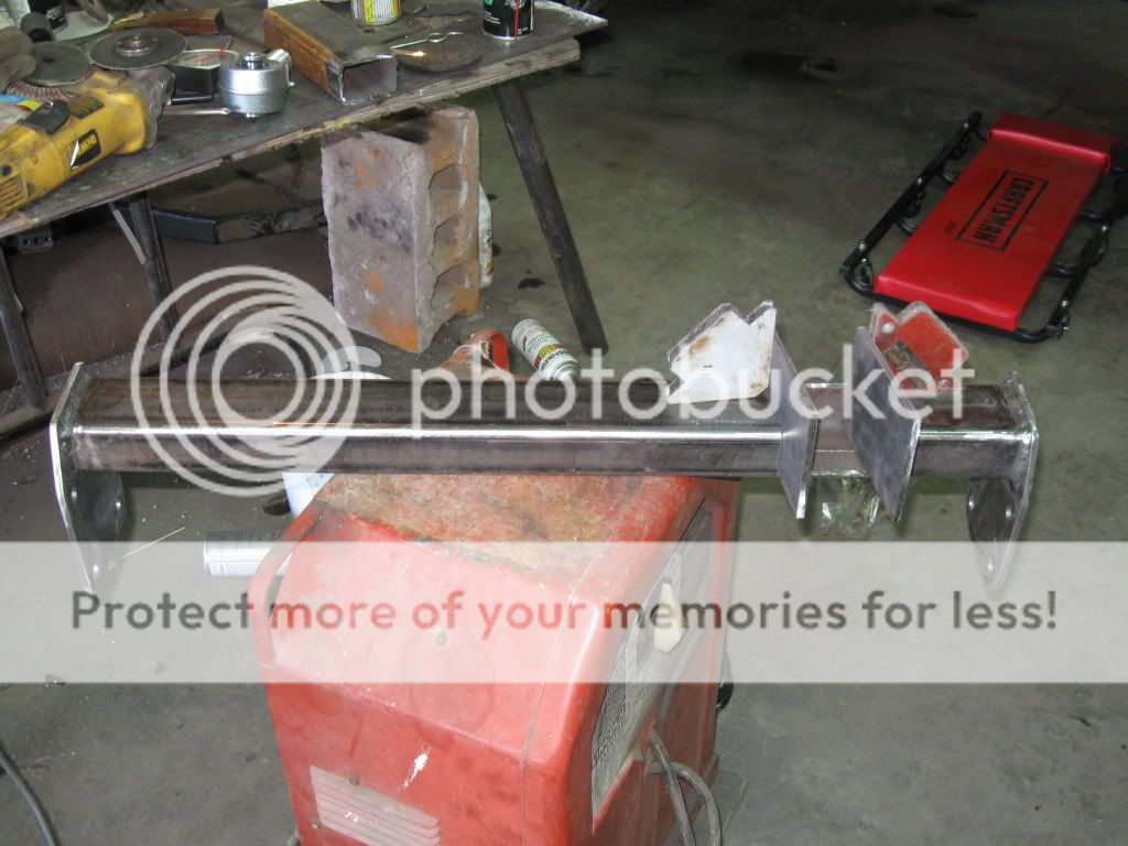

Then to tie the arms to the crossmember

checking the one side
daily doubler build
did the other side
daily doubler build

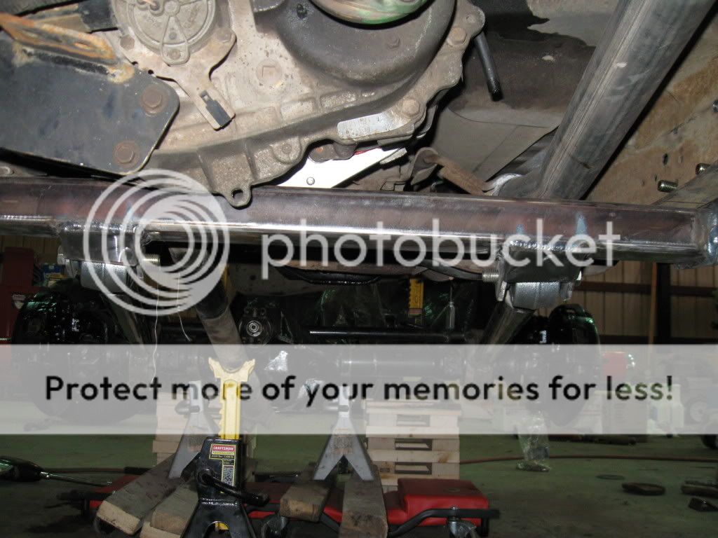

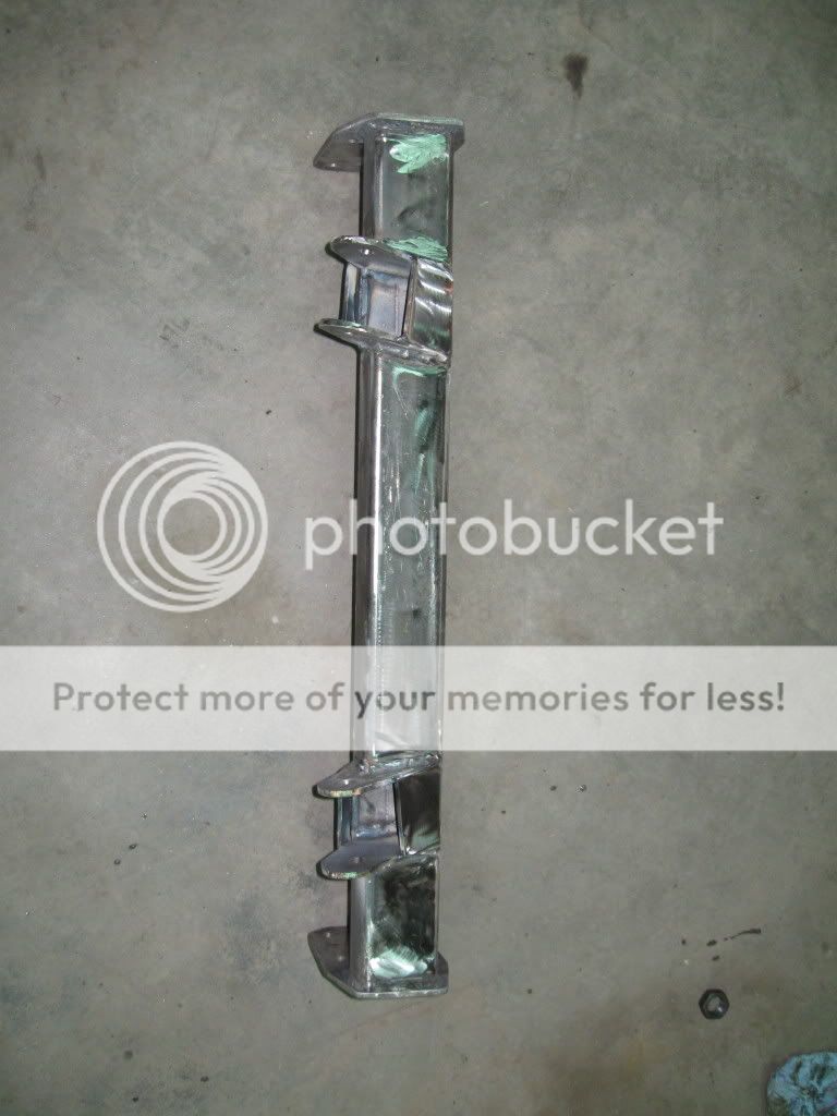

cleaned up the crossmember/added plate

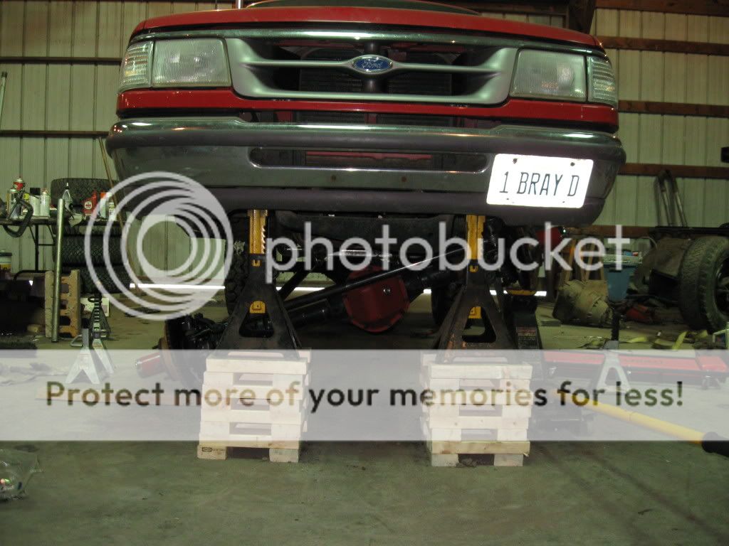

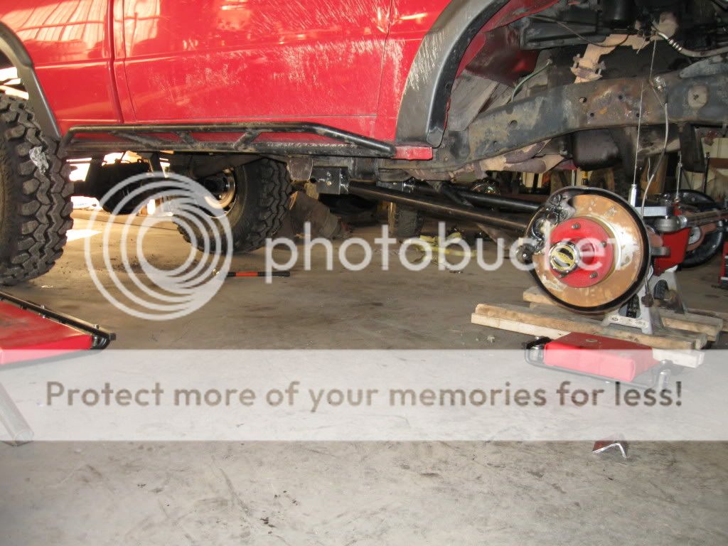

I'm still keepin halfass busy without having my pitman arm reamed. I feel like I'm just kinda spinnin my tires though, without having the exact location of my drag link I can't really make any progress. I did play around a little today though.
Had to remind myself why I'm doing this swap - talk about motivation
daily doubler build

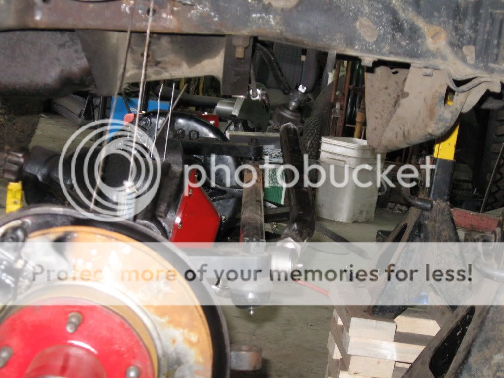

The jack was maxed, look at those flex joints work :D

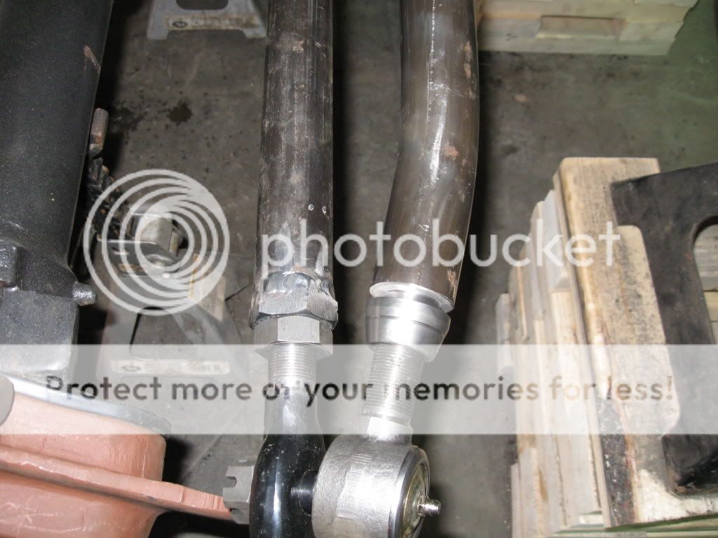

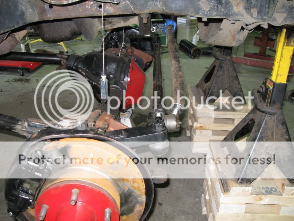

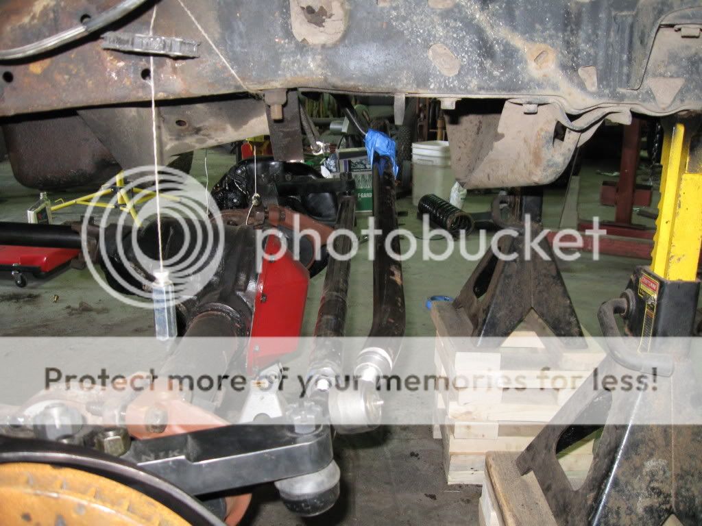

Ok enough fawkin off, back to buildin. Steering is a bit tight using 1.5"x.250 material
daily doubler build
daily doubler build
Had to grind the poop pipe die to fit the tube
daily doubler build
And the real deal
daily doubler build
daily doubler build

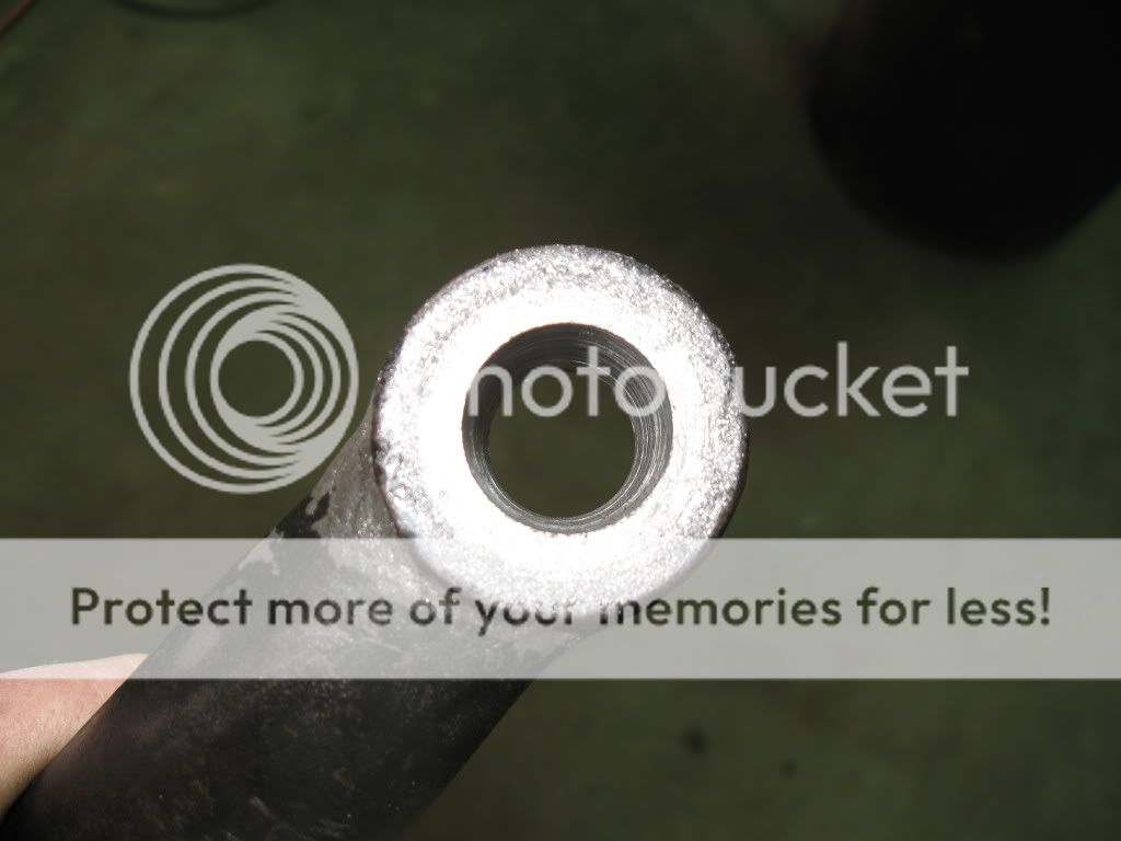

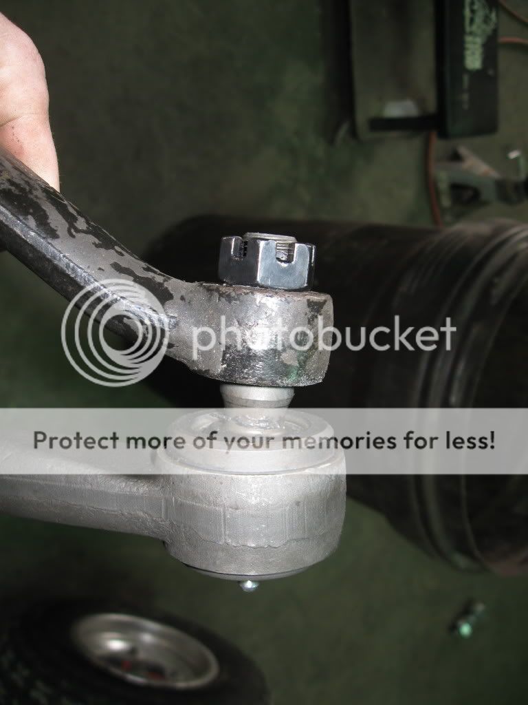

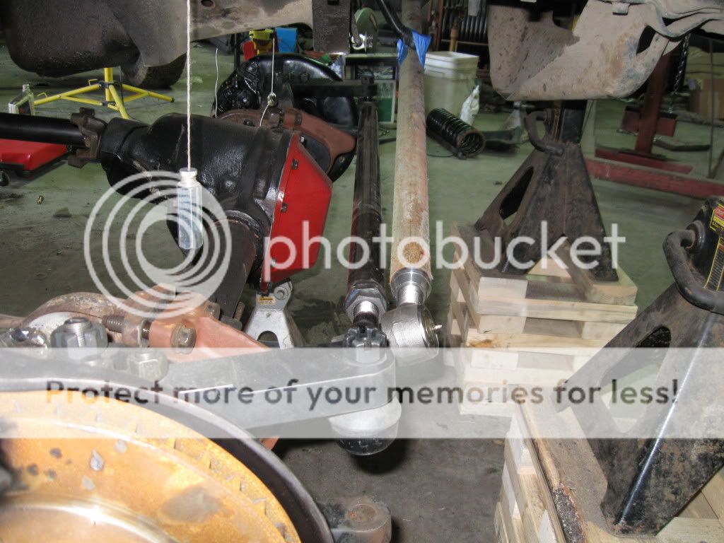

Here's this evenings progress. My reamer finally came in so I got that taken care of. Here's a pic so you can see how much material is left. More than I had anticipated.
daily doubler build
daily doubler build
Once I had that done I could finish my steering
daily doubler build
daily doubler build

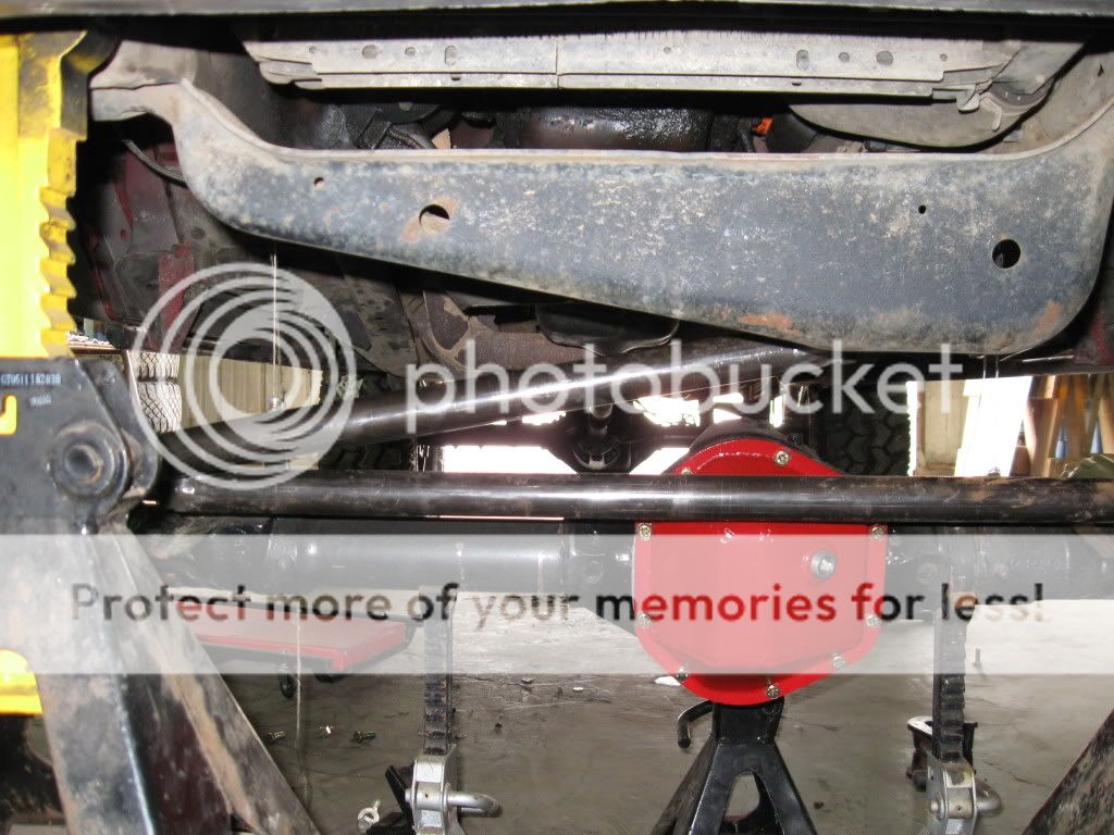

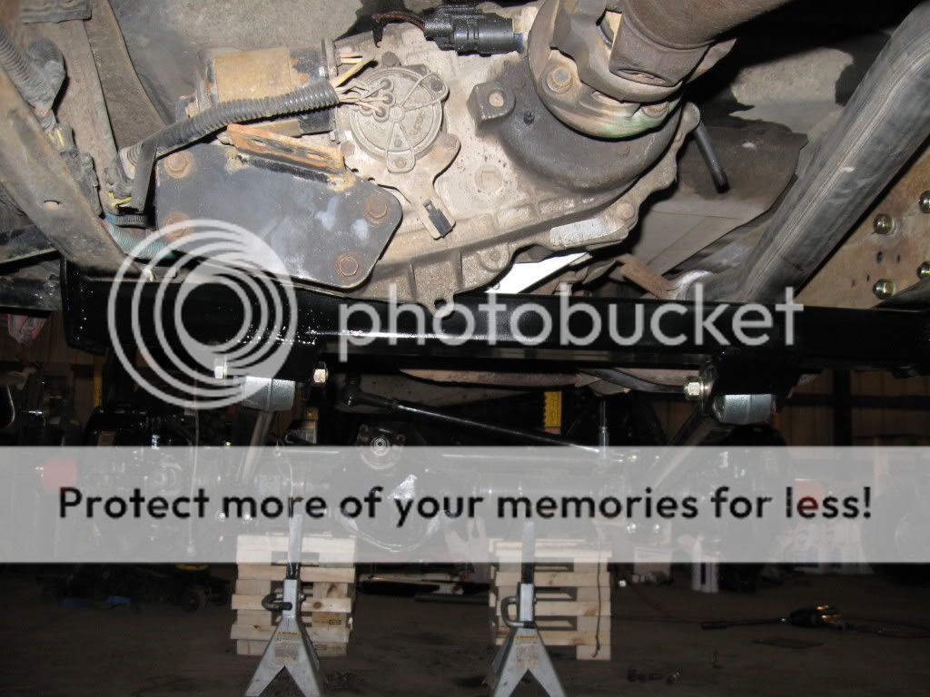

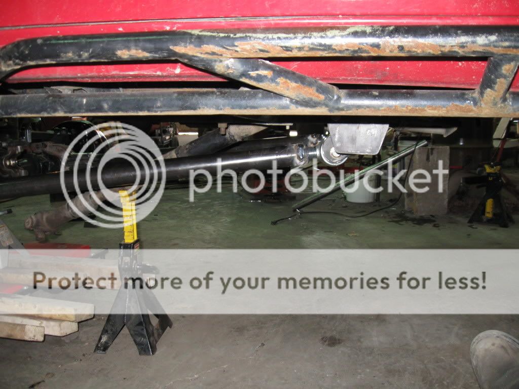

Slung some paint and installed the RA crossmember and RA's for the last time (hopefully)
daily doubler build
daily doubler build
daily doubler build

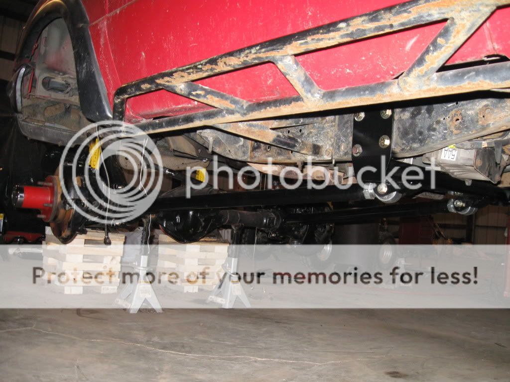

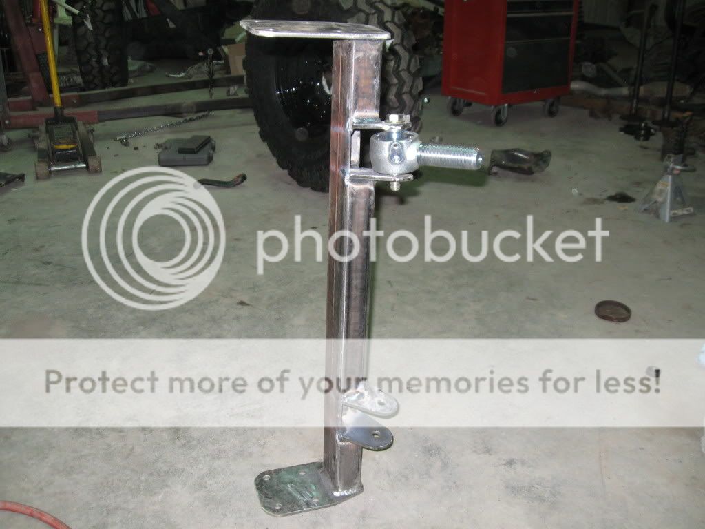

I got the plate drilled that utilizes the steering box bolts and will be the base for my track bar mount. I also mocked up the axle side mount, I think I know what I want to do for it now, gonna be little tricky but I think I can do it. Now that the steering is done tomorrow is "operation track bar".
Here's a pic with a tire, just for kicks
