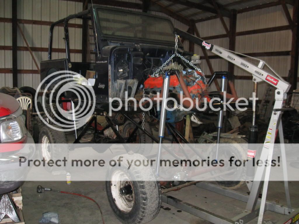

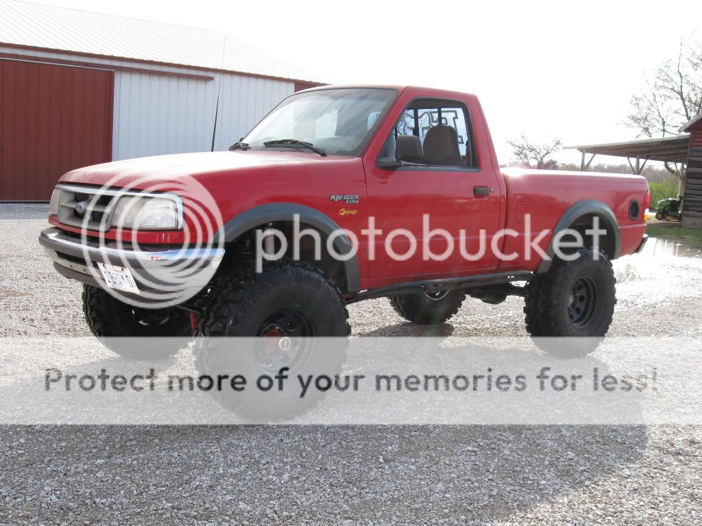

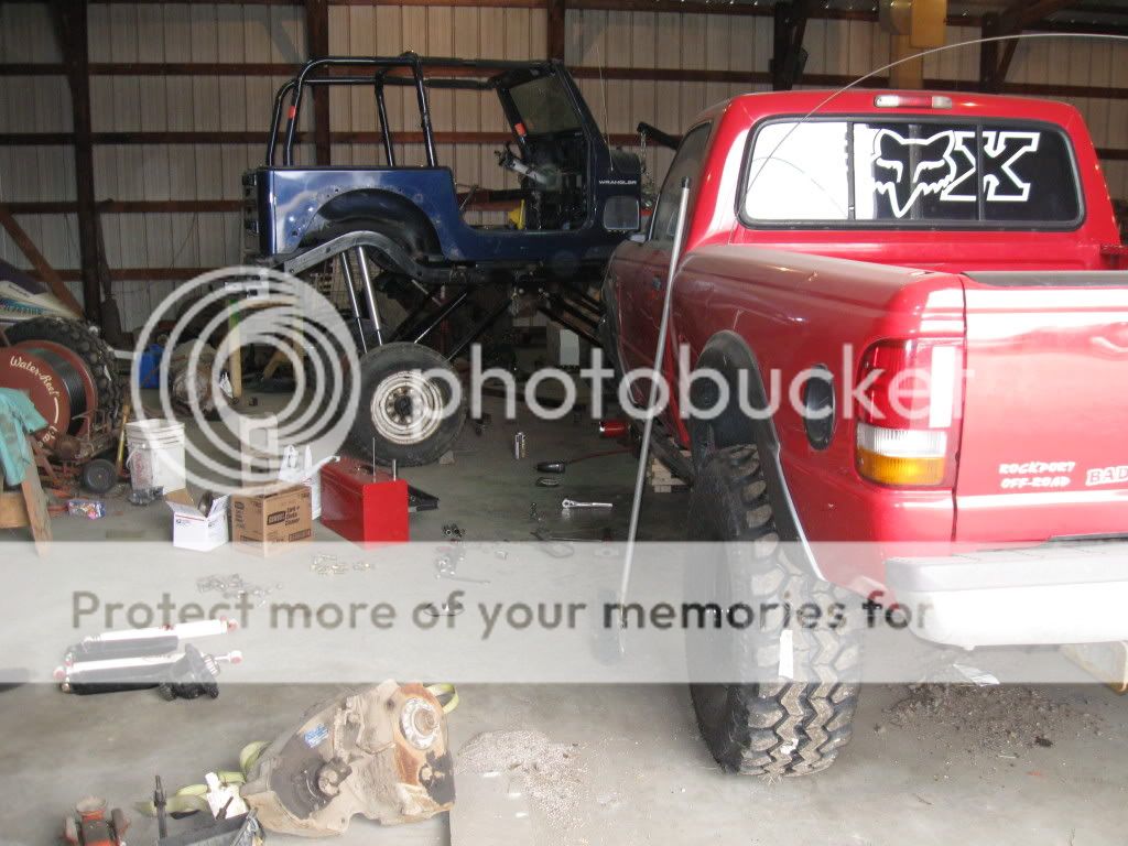

First I thought I'd display my bro's jeep project. Sittin on 32's, mockin in the big block. Damn jeepers

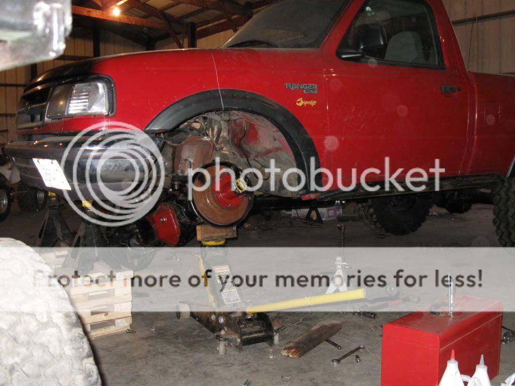

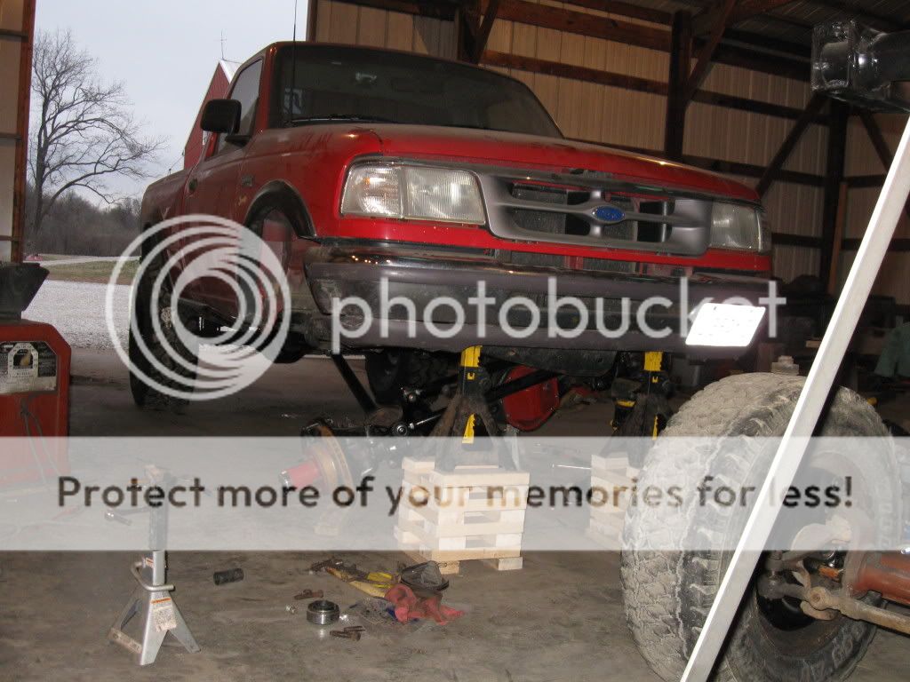

Relative to my truck's size
It'll be 14" lower at ride height, the air shocks haven't started to compress in those pics.

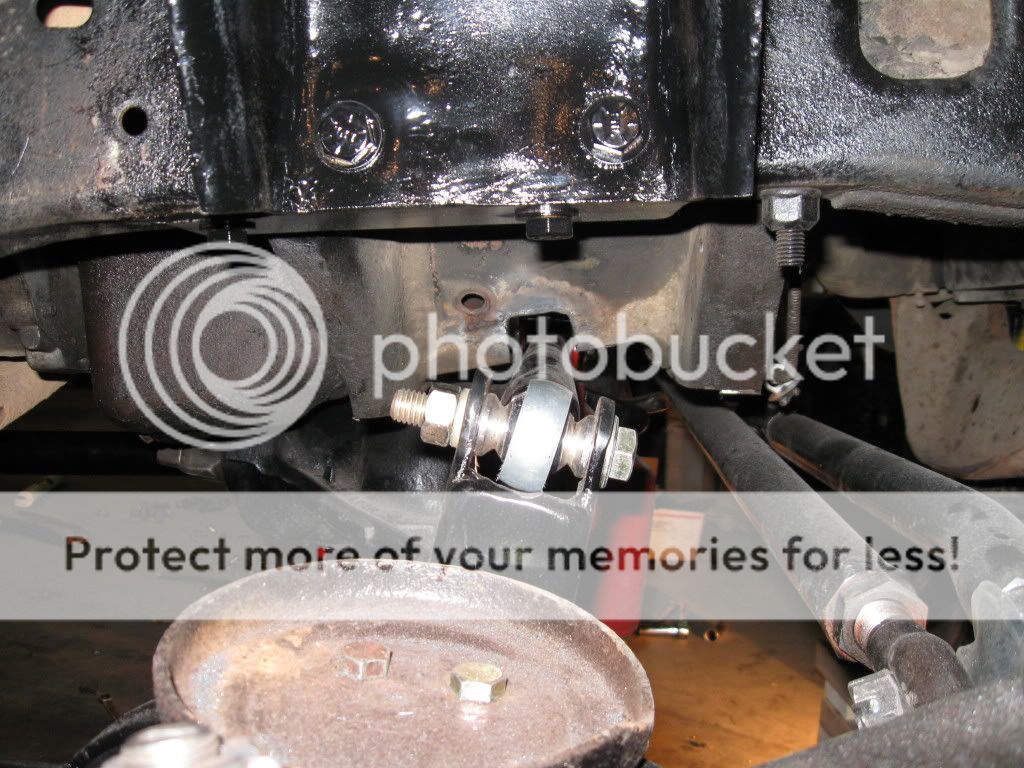

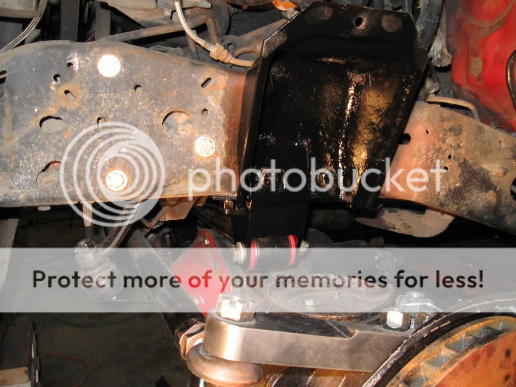

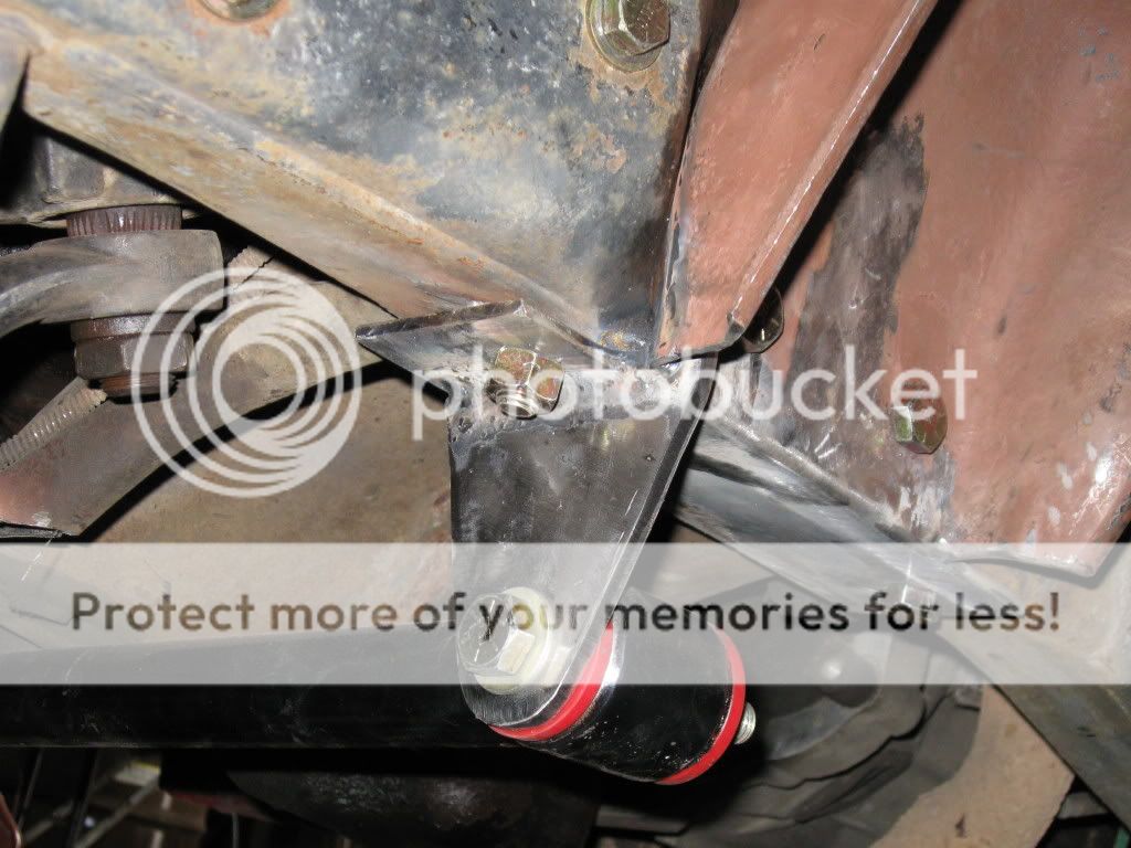

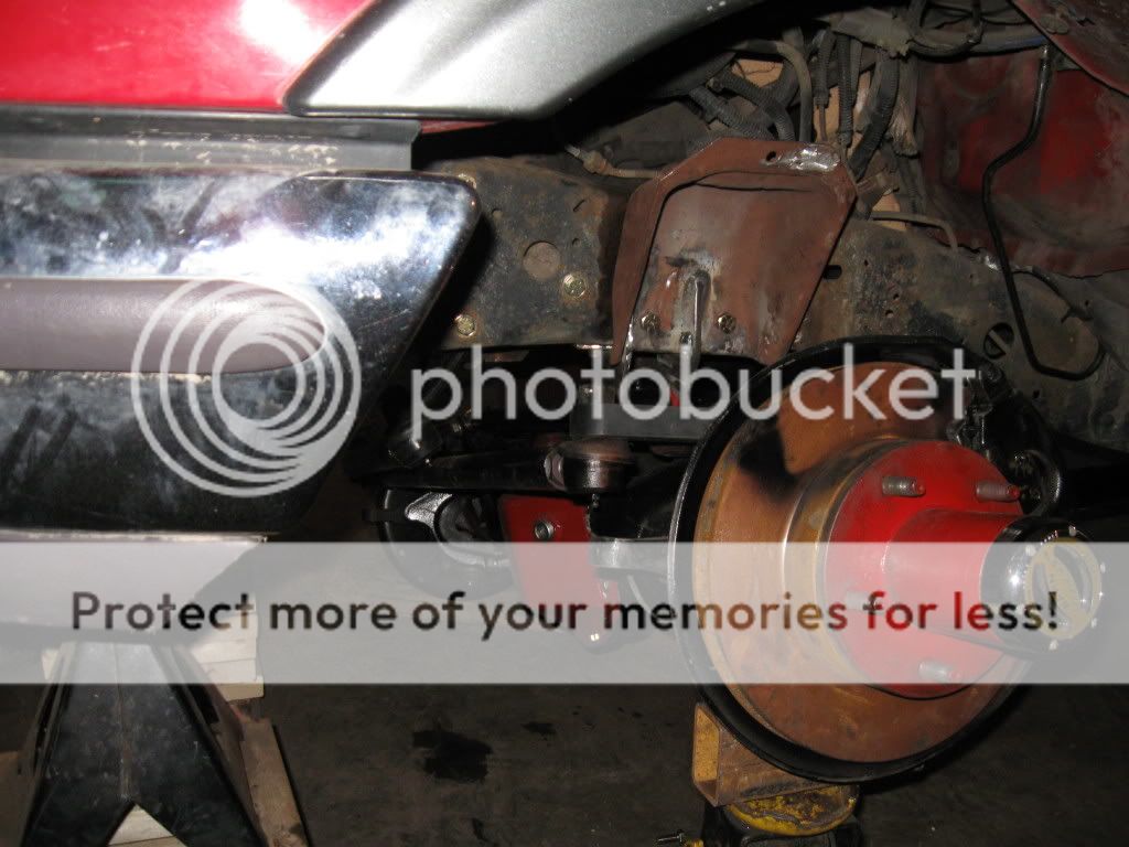

Trackbar mount cleaned up in single shear

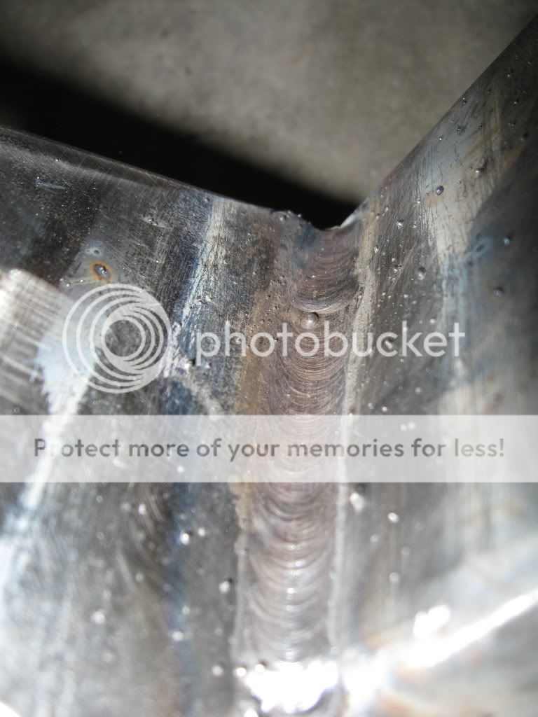

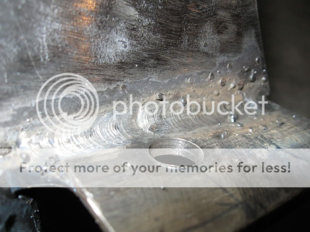

couple weld shots so you guys know its street worthy
mount in double shear

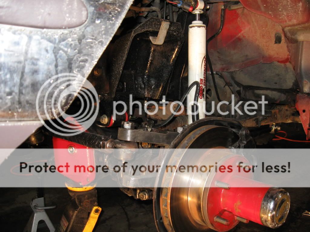

cycled the suspension, this is at the coils free length for droop, and damn near its min length for compression. I don't think I'll have that much bump but it'll definitely droop further than the free length of the spring after the weight of the tire is on there.
I plated the mount as well, I guess I thought I'd wait till it was painted before I got a pic. It's primed now. Soooo all that's left is upper shock mounts and brakes, the end is near :headbang:
Looking good man! Great attention to detail, and there's never a problem with over-building anything :-)
especially when the compressed side touches the bump and levers the droop side down from that pivot point.

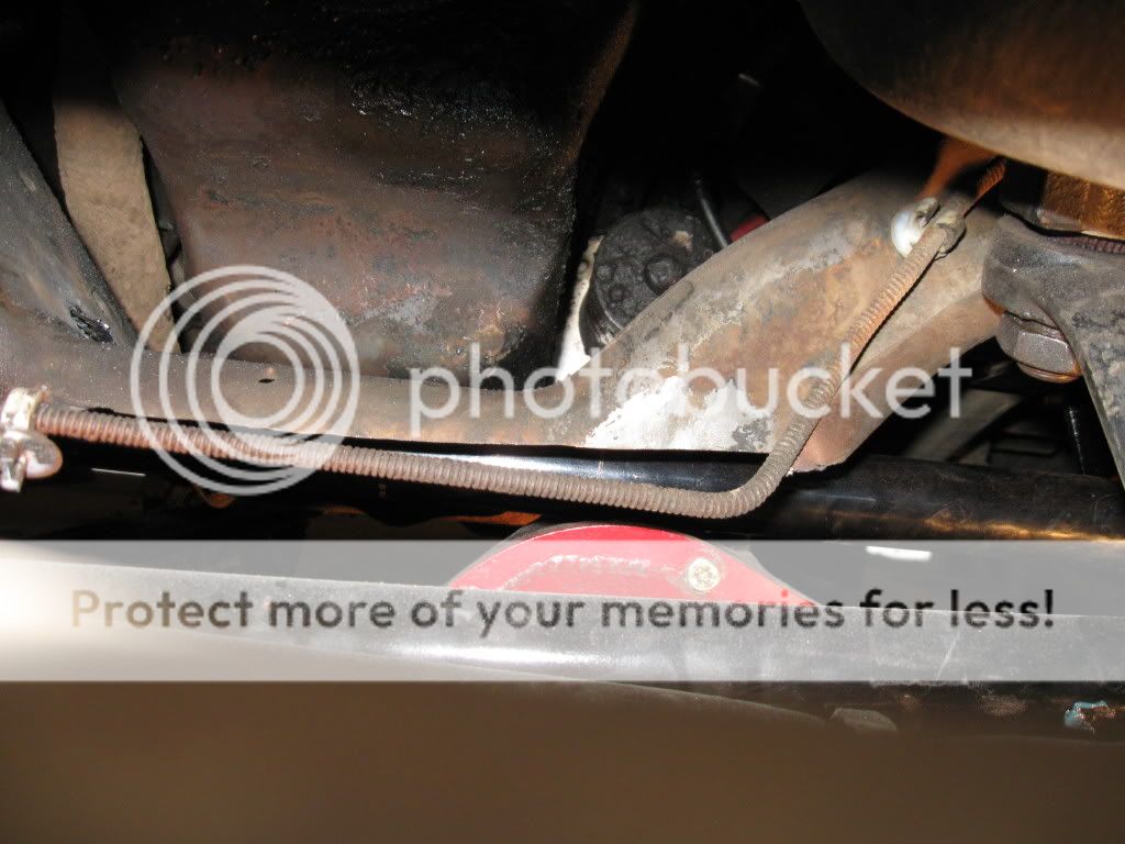

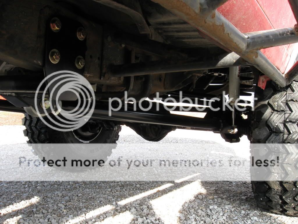

Well I started by clearancing the engine crossmember. I've got plenty of clearance before I get into the oil pan, the limiting factor now is the track bar hitting the top of the diff. A bent bar should take care of that if its not enough compression.
and the finished frame side track bar mount

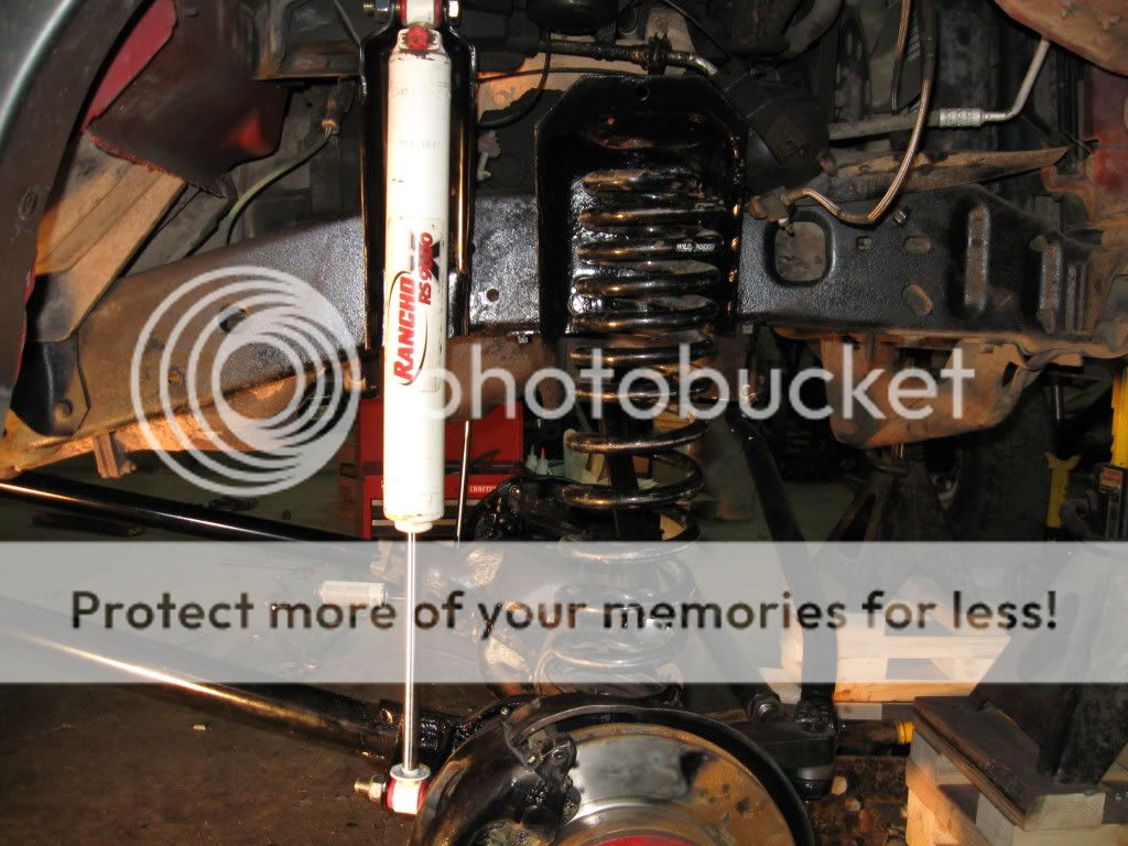

Modified the f250 towers and installed shocks. I know they're upside down. Forgot to take the size of the shock body into account when making the lower mounts. Little work to those and they'll be installed correctly

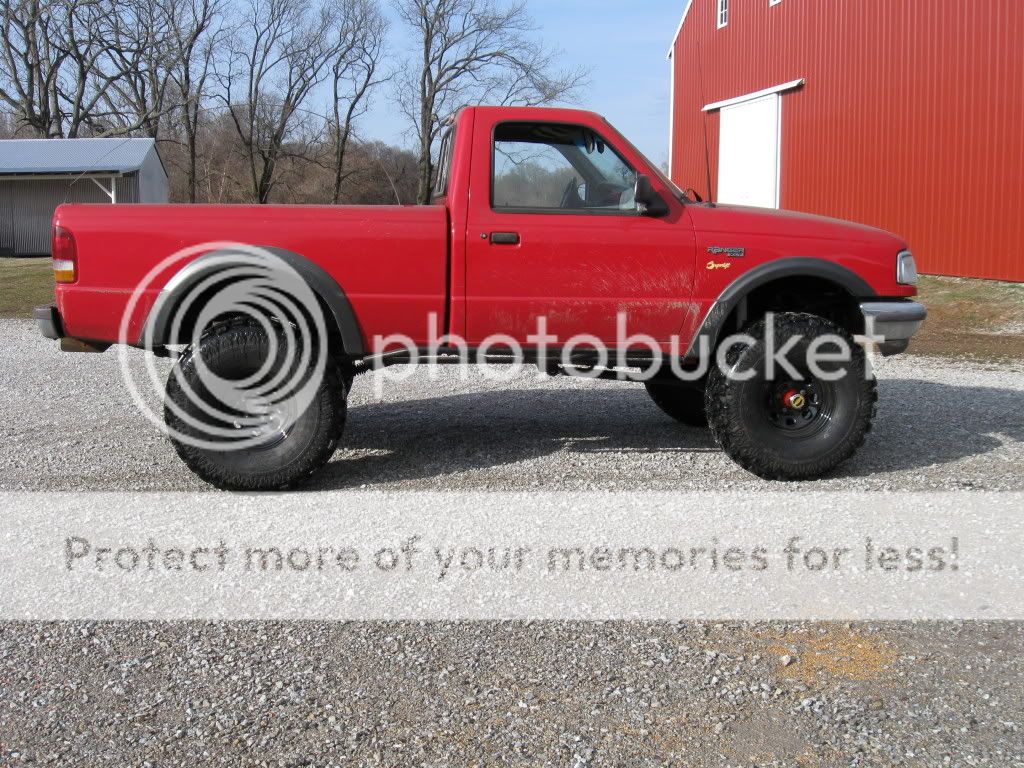

Then I pulled her out for some sunshine

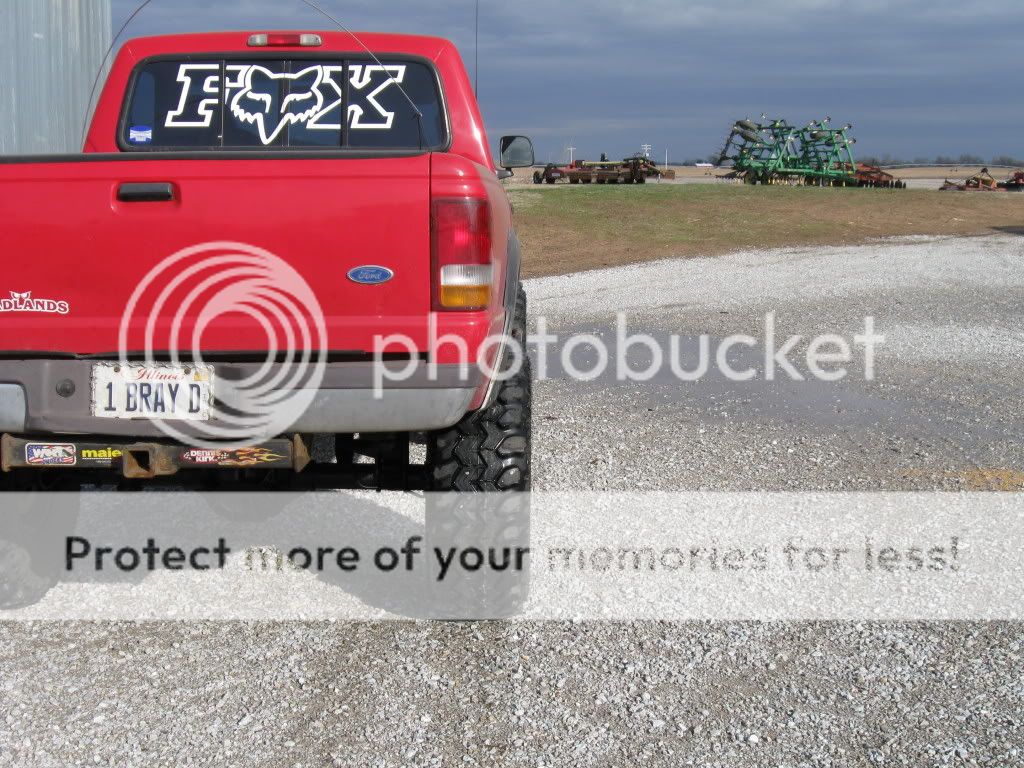

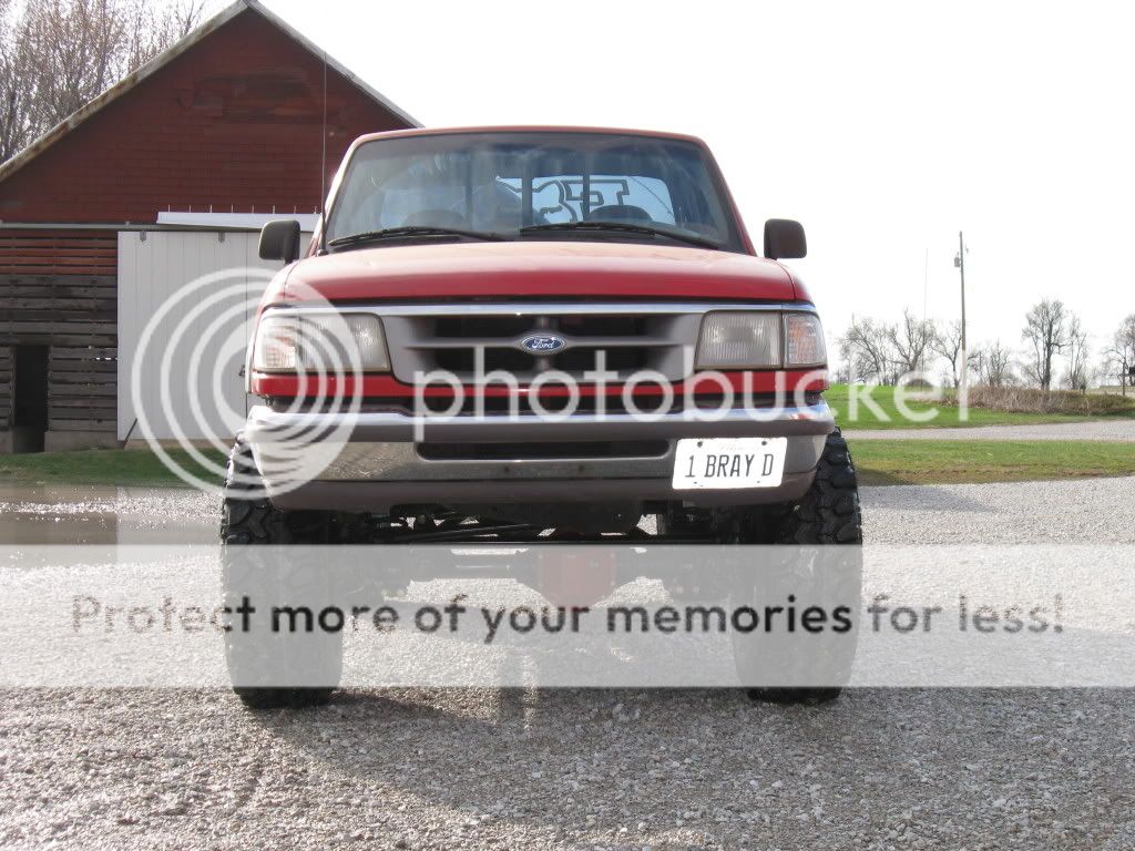

couple pics to show width
and just for shits
I'll take my "1/2 ton SAS group" tag now :D:D:D:D:D:D:D:D:D

Yeah I need to paint em, they'll rust quick. I'd like to find some center caps that fit the larger hole (5 on 5.5 pattern).

I got my driveshaft shortened and installed today. I also picked up some lower coil retainers and threw them on as well.

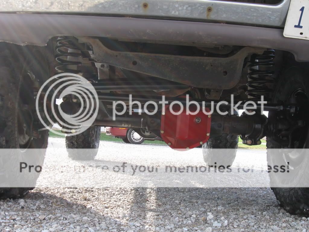

here's the pics at full bump (~3" compression)

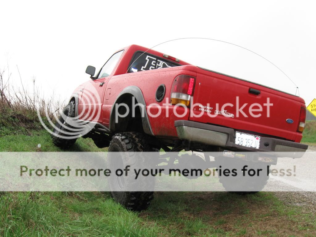

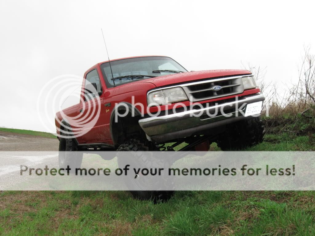

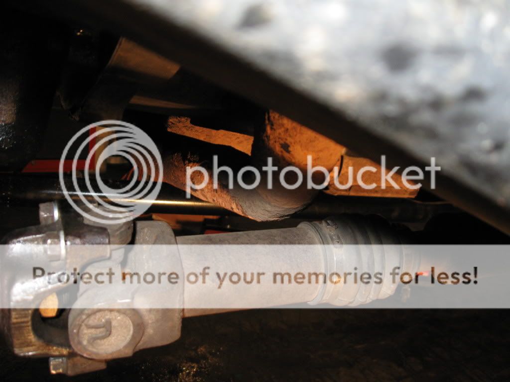

I was super pumped that the driveshaft/exhaust clearance is not the limiting factor for compression (as of right now), so I decided to go try out my 4wd.
That's far from fully articulated. I couldn't get the rear tire to lift at all by lifting the body. So I just continued up and over the hill. I never could've done that with my old setup.

I want to say awesome build!!!!, I love it, very clean work, i wish i could weld close to as good as you, I may have missed it, but where did you learn to weld, school or just practice? Also do you ever make it inot Missouri to any offroad parks?
