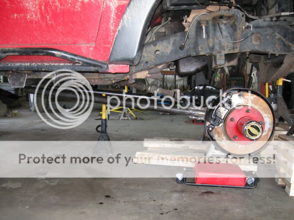

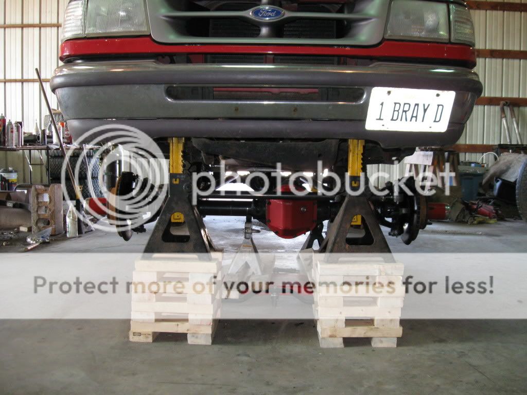

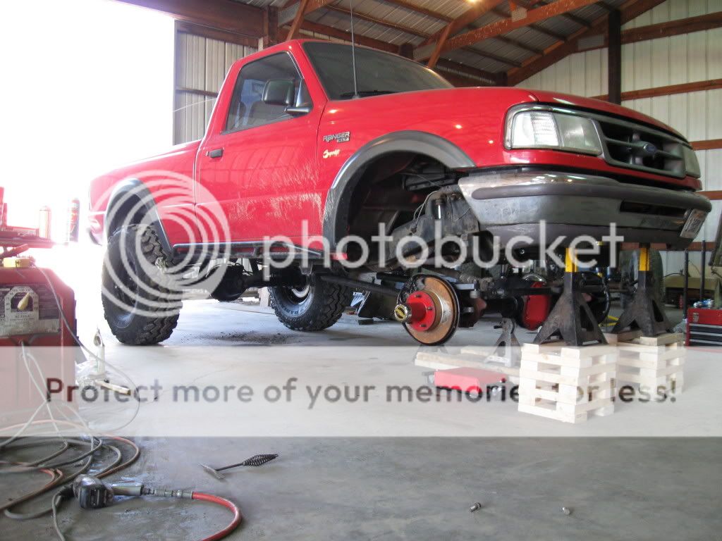

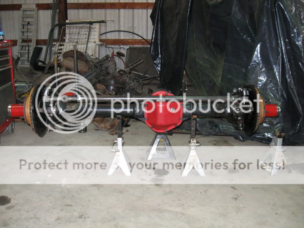

OK, here's what I've got now. This is with 7* c - bushings. Am I pretty much stuck with building bracket for the arms at this position? I thought about trying to find someone to put a like a 5* bend in the arms, so I could tuck em up close to the frame like I had hoped for. I don't think I'll have any luck finding someone who can bend 2"x.250 though. The axle is pushed ~1.5" forward too so I could hook up my d-shaft. I'll have to shorted the d-shaft so I can pull the axle back into stock position.

great buildup so far. I basically had the exact same idea for the radius arms for when I do my sas. except I was planning on covering both sides of the c's with plate, do a bit more bracing on the top and incorporate the shock mounts in the bracing. I will definitely keep my eye on this build to see how they hold up. did you use 99% nickel rod when you welded the rad arms? I want to see how much I have to get to weld the tubes and the arms.
I'd leave the axle that extra bit forward as it will help your tires clear the fenders during flex/cornering. I have the axle centered in the stock position and would rub during compression let alone turning while flex'd after the coils sagged out a bit. I plan on doing as you've done and move the axle ahead a bit. You will be safe with atleast 2" forward before you'll have to worry about steering binding up.

Wahlstrom - I'll see how far forward I can go. I think the frame bumps out a bit (to the outside) where the steering box attaches to the frame, that would effect the attachment of my upper coil buckets. We will see.
ford - I used 7014 rod for the arms (standard welding rod) and 99% nickely on the wedges/tubes. I don't think the arms are cast, they welded up fine.
For the record I can't take credit for the arms. I know Cheapthrills has arms like these as well as many over at Pirate.
Moving the axle forward and the coil bucket placement isn't as big of a concern as is you have to watch your steering. Further forward you are and the closer the trac bar gets to the pitman arm itself.

Just went out and measured mine, and I'll be able to move the axle 2.5" forwards before the drag link and tie-rod are parallel when the wheels are straight (stock pitman arm too).

I didn't get much done today. Took 2 more passes on the arms so they're good. Got the stock upper buckets popped off too. I just need to figure out what I want to do for mounting my upper coil buckets. The driver's side bump for the steering box is killin me.
You could make an upper coil retaining bracket that would mount/pivot on a shock hoop style mount.
