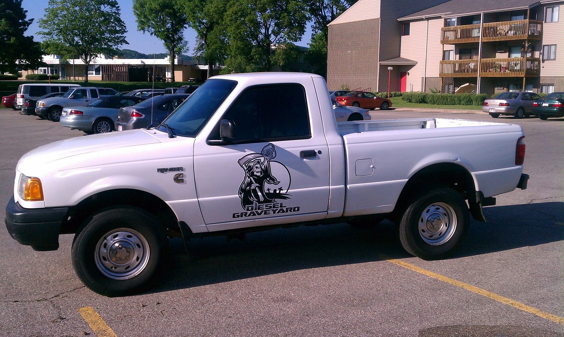

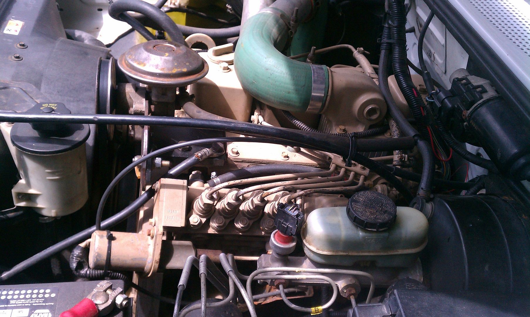

The truck is an 02' 2wd with a 4bt. It's a runner and driver now and I have every gauge working except the tach.
When I got the truck it didn't have a motor so I am looking for some help on how the original setup worked and if I can use the original Ranger tach. The 4bt does not have a tach sensor on the harmonic balancer like the 6bt does.
From what I gather the Ranger tach operates off the ECM...but what language the tach understands is what i am trying to figure out. I can install a sender that works off a magnetic pickup on the alternator or another rotating source if I can determine what type of signal the factory tach reads. I used a dakota digital box for the speedo and I think they might have one for the tach that would work out too.

Look into the Dakota Digital DSL-1 or DSL-2 (same controller, the DSL-2 comes with a pick-up that will screw into most Cummins bellhousings adapters.)

pics or the swap didnt happen
I have a DD DSL-2 sitting here waiting for the 4BT to go into my truck. I already installed the pick-up in the bell housing adapter. I know for sure it will work with the flywheel and I'm about 99% sure it will work with the stock tach.
