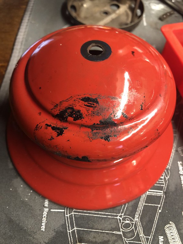

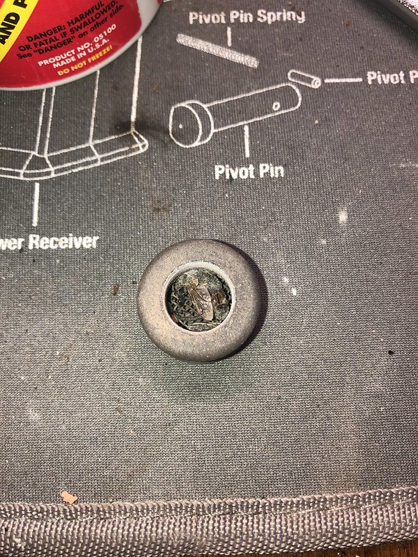

Vent cleaned up pretty good, it has some kind of tar on it but as of yet my goo-gone is evading me.

Always gotta be bugs somewhere:

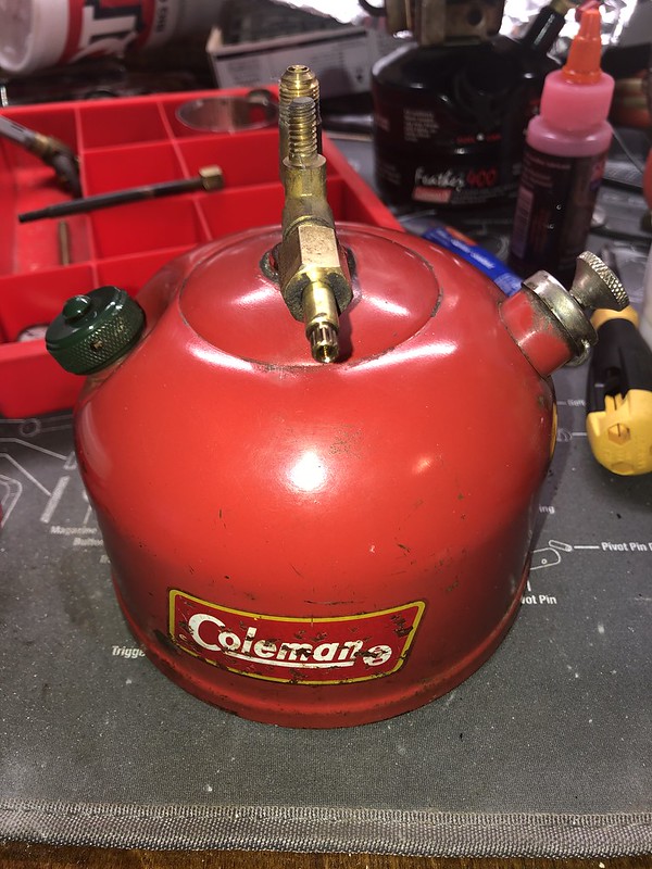

Fount cleaned up pretty decent too. The rust thru the decal bugs me... I might tear it back down and repaint the fount in the future. Soaking with acetone to free up any stuck petrified fuel right now, hopefully I can flush out whatever else is there too.

I was curious what that black spot was. Figured it got bumped into by a plastic bag or a tent or something when it was hot.
I've been tempted to repaint a couple of mine but I kinda like them better in their "working clothes."
I do too, I am more concerned about it getting worse though.
I can pick some the black stuff off but some of it is on there pretty good.
Maybe whatever it is will melt once you fire the thing up and it'll just wipe off? Hate to suggest hitting it with brake cleaner or anything... have had that smear the paint on occasion.
The vents are supposed to be ceramic coated for the heat.
I was going to try goo-gone on it as soon as I find mine.
What about a heat gun? If you can get a piece off you could test the meltability. Then maybe use non metallic scuff pads.
WD-40 works good at getting some things off, plus it keeps it from immediately sticking itself back on in another spot

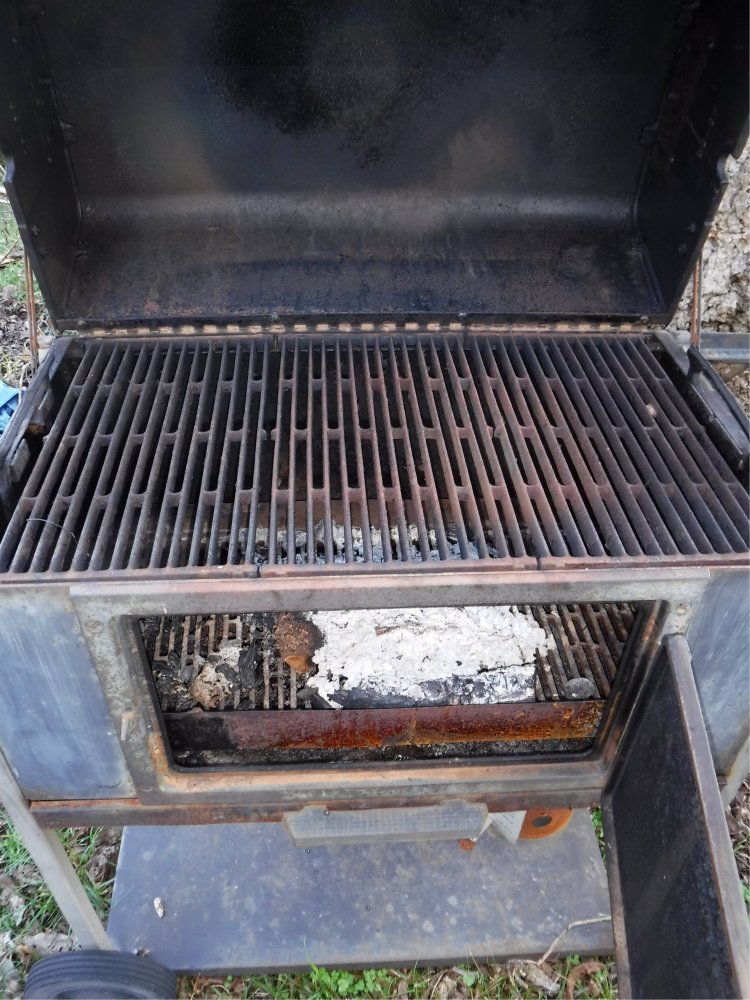

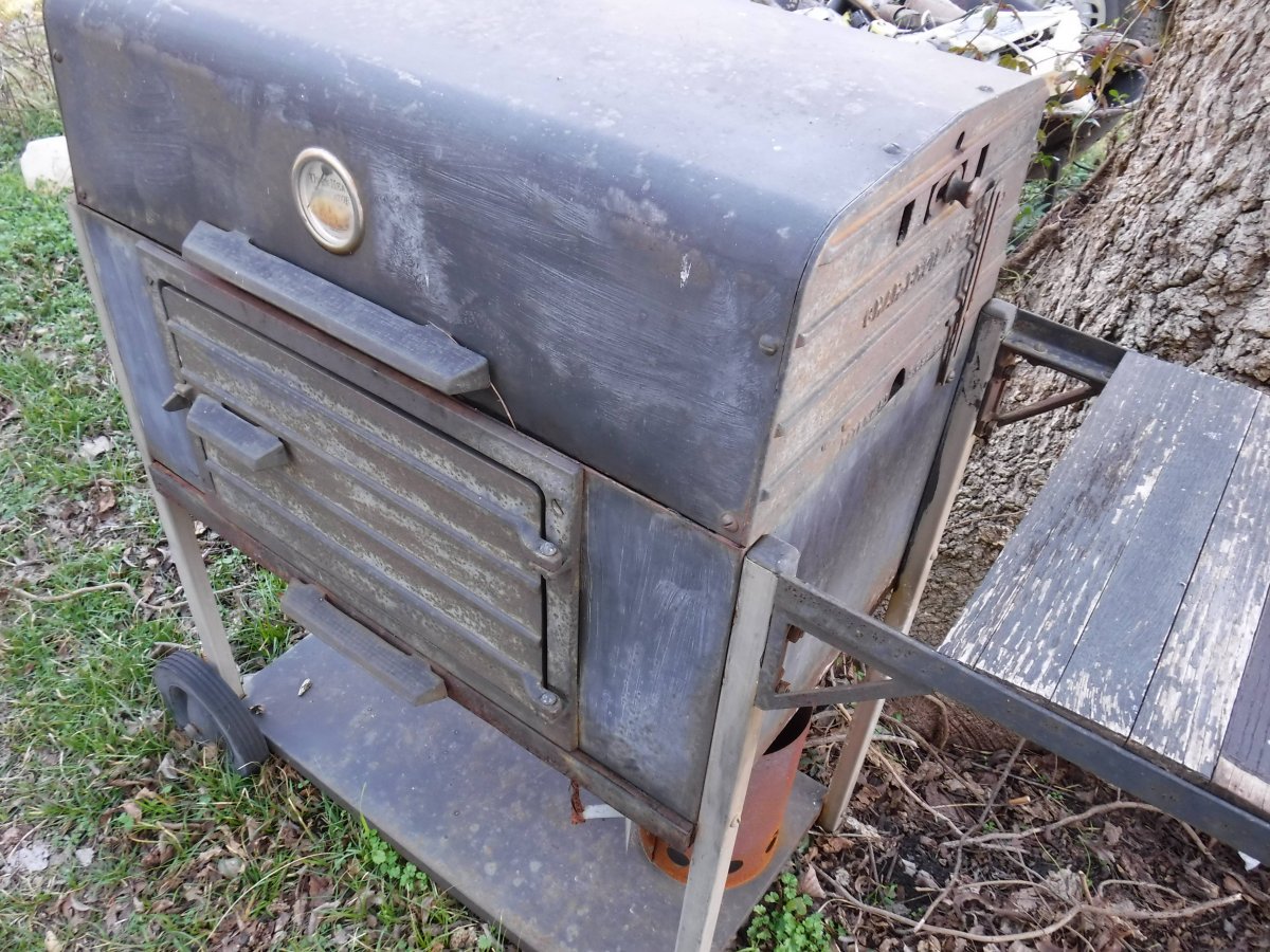

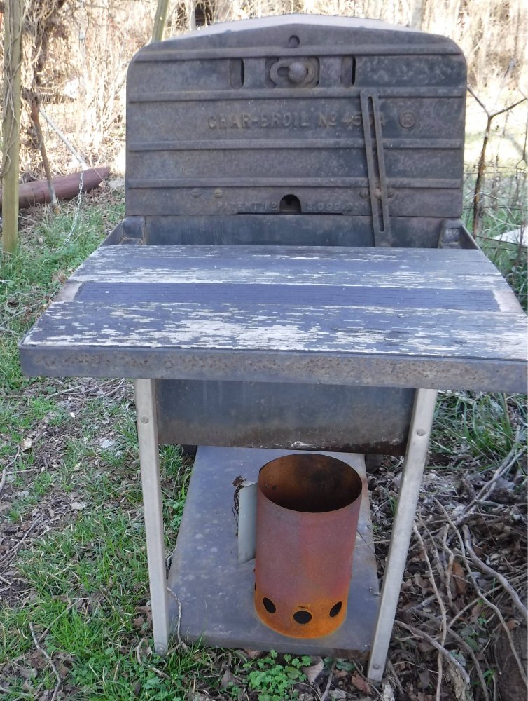

Dang, I thought I'd done well to get a big charcoal for $20, with the shelf off it barely fit in the truck. Box measures 16x28 & 21" high. Got some high temp black to go on it when I can get to it. The ends, vents, grates, shelf brackets, and fire door are cast
Due to truck probs I didn't make the family Thanksgiving so I smoked their turkey and took it Christmas.
It did darn well just using dry pecan.
Mine isn't super heavy duty, I got it for my birthday a couple years ago. I do like it though and it is a handy fire proof thing to test fire Coleman stuff on.

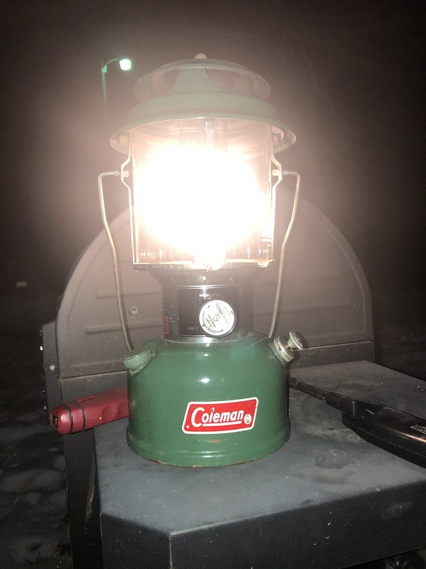

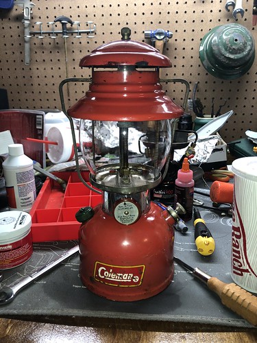

For an update on the 200A, it didn't clean up too bad:
Coleman Liquid Fuel

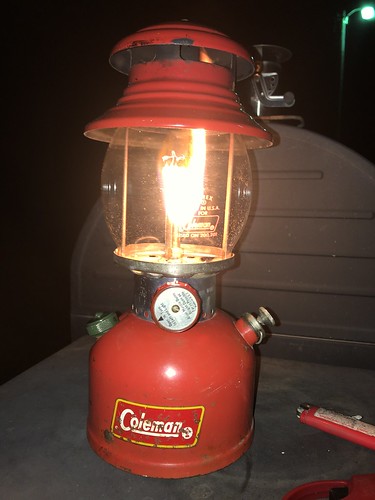

So I tried to light it:
Coleman Liquid Fuel
It tried but it couldn't quite get it together. It ran smooth but yellow with a fire streamer. Air tube is clear, I kinda question the generator. In addition to being slightly bent it looked like it could have been original. I cleaned the outside and I could maybe clean the inside... but it is also bent.
Does it have any kind of seam in the structure? Almost appears there's some extra air in the mix
There is kind of a macaroni noodle looking thing at the top that can leak.
Coleman Liquid Fuel
Generally yellow fire on Coleman stuff means it is running rich though.
Hmm, that's interesting. I'd be suspecting the generator too. Maybe the orifice is hogged out or something and letting too much fuel through...? Do the 200As use the same generator as the 220's?
What size mantle are you using? Perhaps throw a bigger one on after checking for leaks in the burner assembly?
Of course not, that would make it too easy. If it did I would just swap it for a known good used 220 gen for testing. Kinda makes sense though, I suppose a single mantle lantern has different fuel needs than a dual mantle lantern.
I am running a #21.
