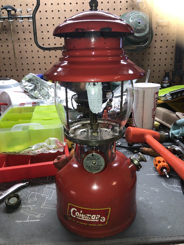

I'm pretty sure I'm using a #21 on my 200A and it works fine. That little flame streamer that goes up into the vent is pretty weird. Makes me think that maybe a bigger mantle would maybe allow all the fuel to burn inside the mantle rather than float up like that, or maybe the generator is just junk and it's running rich like you said. Seems like it would just flare up and not run at all if that was the case though.

I am going to chase the air tube and see if that helps, I looked it from both ends and the generator hole and it was clear, I couldn’t get the macaroni thing off the top, not sure if I ran anything thru it.

Anyway I got the macaroni thing off, I found a little glob of mud dauber around where the generator enters the air tube. Didn’t really look like much but I have read it doesn’t take much of a spider web to mess it up.
