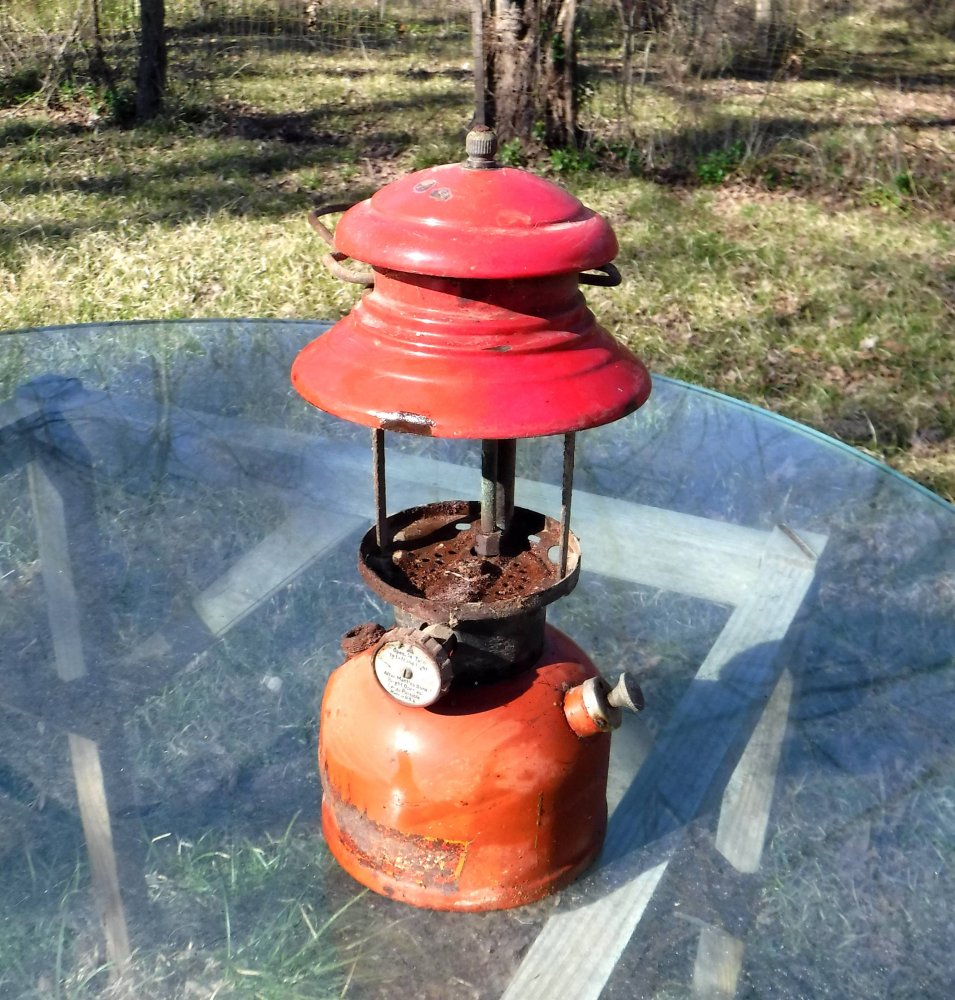

This is it, I just wiped it off with a wet sponge, it's a single wick

My initial thought is "I bet it would run"
And then I saw the threads for the fuel cap...
If it isn't too rusty inside and you could get a cap to go on it (and seal) it might have a chance to live again. What year is it?
The single mantles are kind of underrated by most, they produce something like 75% the light of a dual mantle on half the fuel and half the mantles.

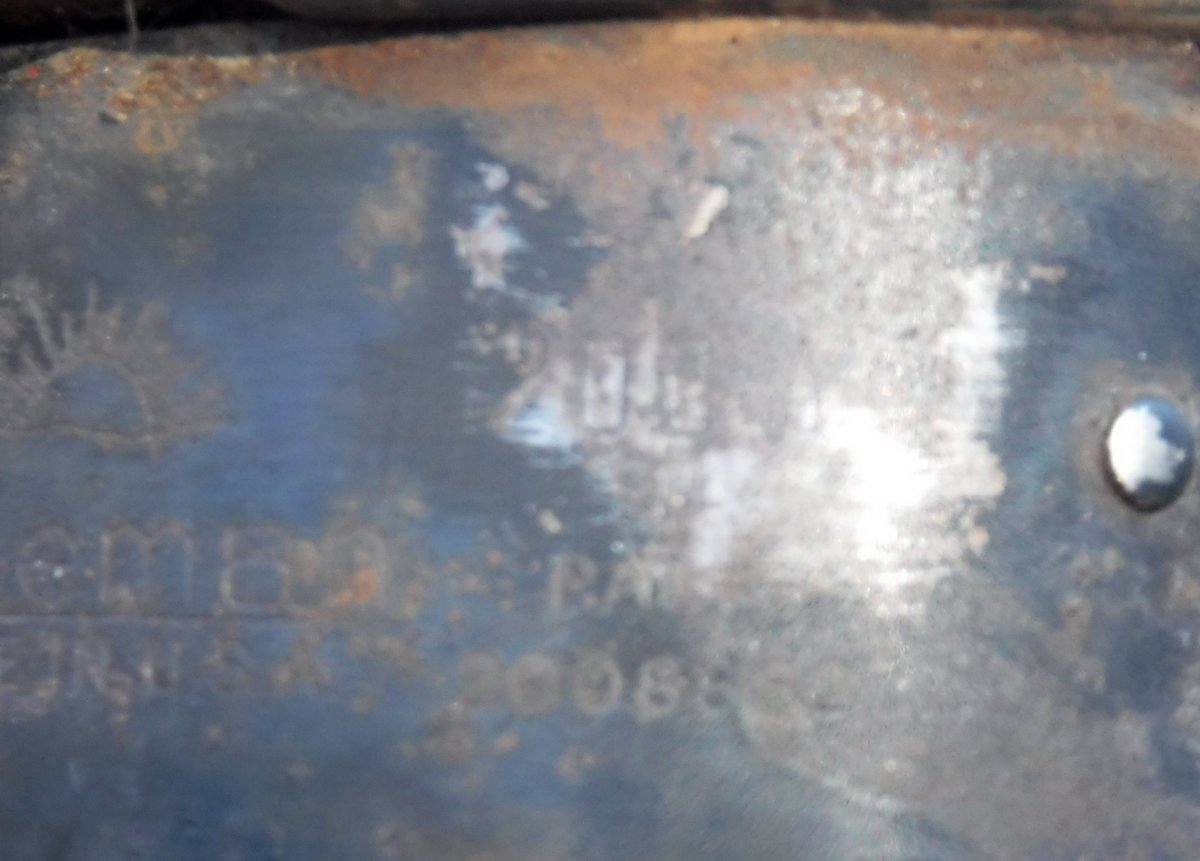

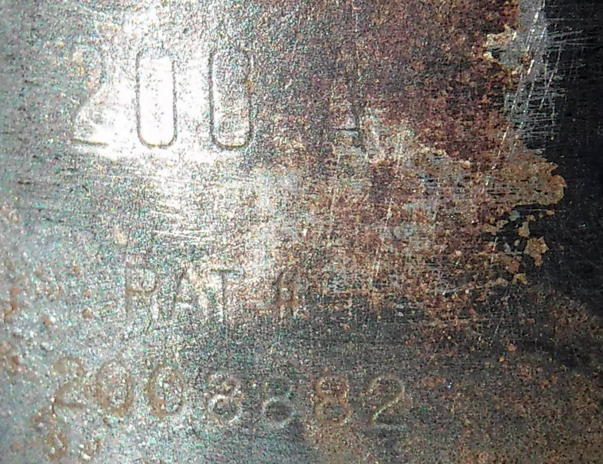

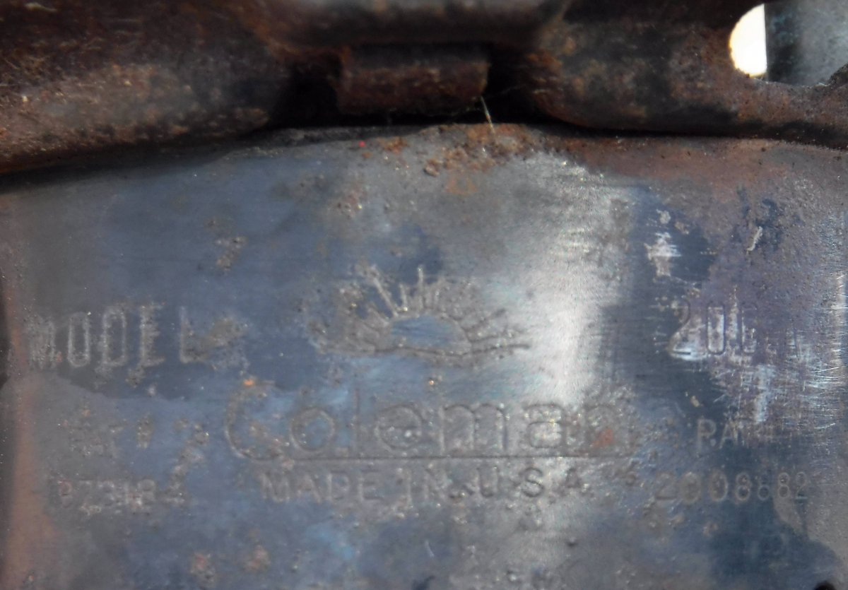

I can't hardly get a good look at it, think it says 200A
Yeah, it is somewhat similar vintage to the one Shran found, looks like it had a yellow border around the decal too.

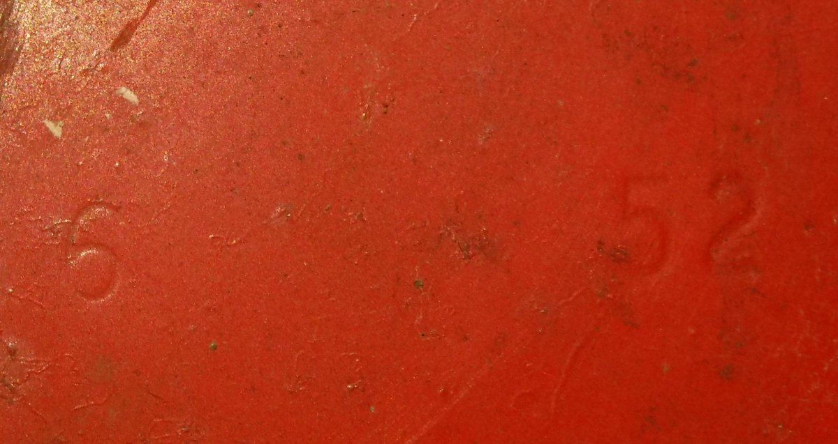

The month and date are stamped in the bottom of the fount (fuel tank)
When I looked at the bottom it didn't show, but in good sunlight it did, 6-52

Maybe an acid bath would clean up that fount... Would depend if it's pitted or rusted through. I'd resign it to wall hanger status if so. Pressurized fuel in a questionable container with an burning mantle above it scares me. I scrapped one fount because of that and it looked a lot better than that one. Poor thing!!!
The bottom looks pretty solid so it has that going for it.
Cool find... I haven't turned one of those up for awhile.
