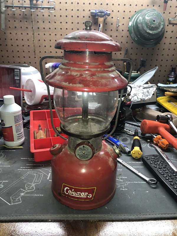

Well it showed up today:
Coleman Liquid Fuel

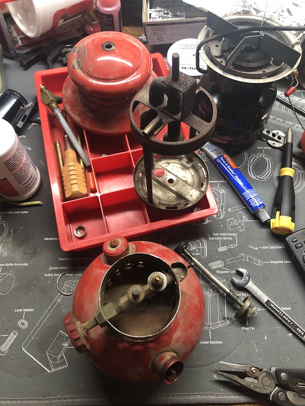

If I had known what I was getting into I should have done an unboxing video. @Shran did a great job packing the thing.

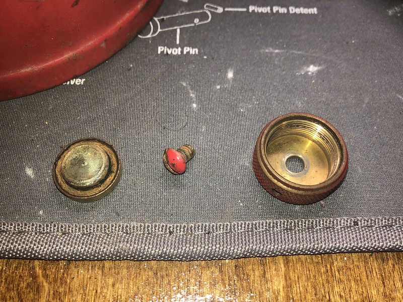

I stripped it down for a bug nest check. It would not build pressure so I oiled the cup. The cap leaks something fierce but it builds pressure if I plug the fill hole with my thumb.
Coleman Liquid Fuel
Then I tore the cap down so I can change the gasket and called it a night.

Your CL2 sure looks nicer then mine... but I use it for years. It has some rash.
Congrats on the new one!
Noice! :headbang: I was curious if it held pressure before I sent it out so I oiled up the pump and checked the cab seal... the seal was actually coming apart, I picked out a bunch of chunks so they didn't fall into the tank. Couldn't help myself but I didn't want to tell you and ruin your fun :p
