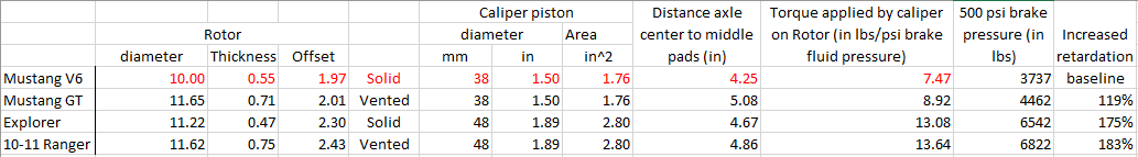

Explorer rear discs might look small, but they are only 7/16" smaller than the Mustang GT rotor sometimes used and 1-11/16" larger than the V6 Mustang rear rotor set up most commonly used! '10-11 Ranger discs are within 1/16" of the Mustang GT rotors
But the major difference is the caliper - the Mustangs only have 38mm piston, while the Explorer have 48mm ones (60% increase).
Just for reference 235/75R15s have diameter of 28.9" (radius 14.4"); my Ranger puts ~1,900lbs on rear axle (950lbs/tire), traction coefficient for my BF Goodrich ATs is about 0.75 ≈ 10,000 in lbs would required to lock the rear wheels.
500psi is moderate braking, 1,500psi or more is possible when you 'stand on the pedal'.
I have never been around the Mustang setup, any chance they would have more swept area than Explorer since they don't have the drum parking brake? The pads on RA don't look as long but are much thicker compared to the Explorer ones.
I run my '85 heavier than most and my Explorer discs work fine for me. :dntknw:
The 2010 & 2011 rear discs are ventilated, I imagine the full size Explorer is as well. The Sport had solid discs with no ventilation. So, if doing a brake or axle swap, pay attention to what you are getting. The details make a difference.
Pretty sure my rear Explorer discs are solid.
