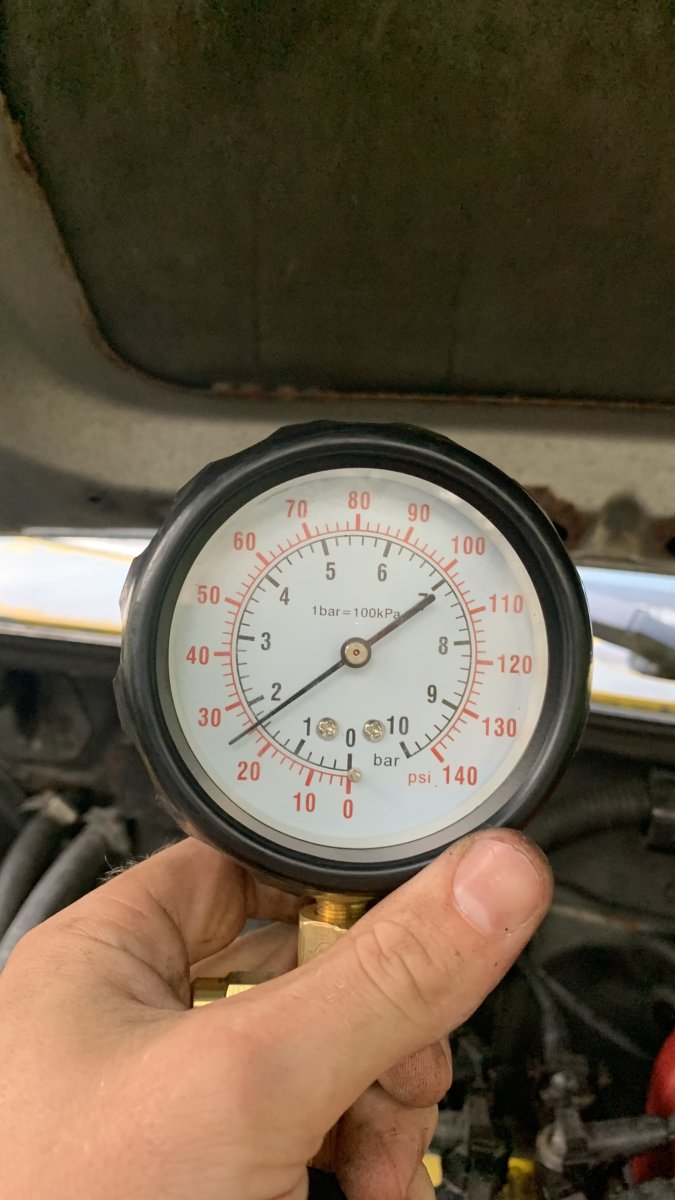

25 psi at idle and dips slightly down at WOT. Guessing this is the culprit, who would of thought a delphi pump goes bad after a few thousand miles. Just my luck lol
Was gonna say it might be hard to tell if the pressure only drops at WOT.
That's definitely bad though.
that is very wow. I tell people not to buy new sending units ($100) when they can replace the pump in the sending unit ($65) or service the rest of it with a soldering iron and some common sense, mainly for 1 big reason: a new sending unit is chinese trash, replace the pump only and you get a delphi from rockauto - aka the best... I am a bit shocked you had a delphi do that to you.
I got to ask a question since you are under the hood not on the frame rail (which means you are past the fuel filter, regulator etc).... is the pressure bad back before the filter? Could be a nearly completely clogged filter or bad regulator.
I was cranking it to WOT with my hand watching the guage, I think its cooked.
Unfortunately thats what i did, since the ranger sender wont talk to the bronco dash. I took a ranger pump and fit it on the bronco sending unit. When i rebuilt the engine and put it in the chasis, i did a new fuel pump, tank and filter. Ive only put around 2k miles on the whole system, so i doubt the fuel filter is clogged. I do have the fittings to check though, i just lack the motivation to do it tonight after a day of taking losses lol.
