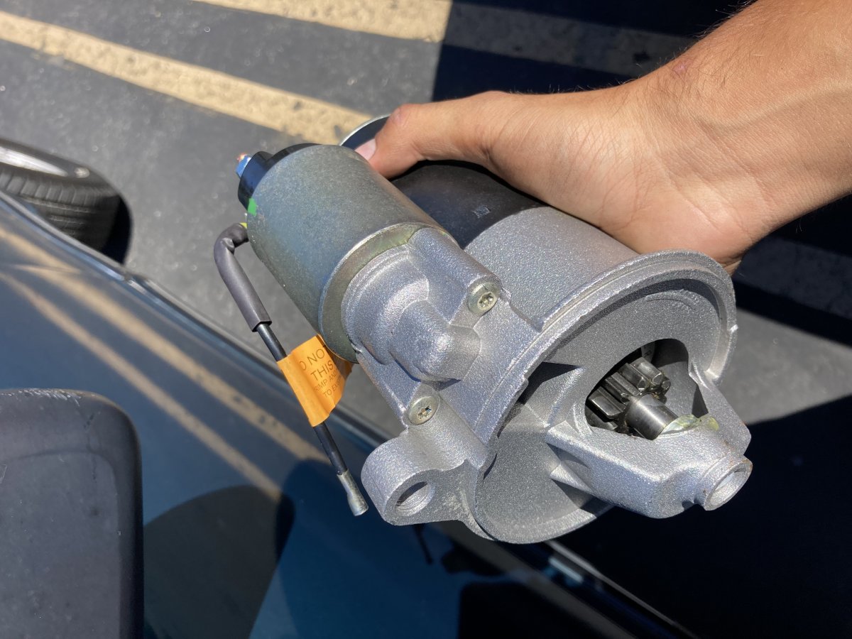

Ok, so I’ve examined the photos I have of both starters I installed. Both look correct and are not the longer one for automatics.
I think its safe to say the starters I used were correct and should not have caused repeated flywheel teeth loss.

heres an automatic starter for comparison

The starter teeth also look OK
Or is that one never been used?
