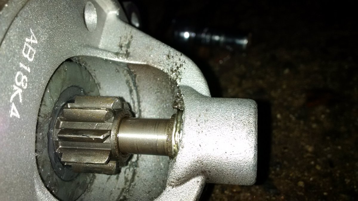

Autozone starter?
Maybe the bolts come lose?
Sounds like it is time to pull the starter and look a the teeth of both the flywheel and the starter. If both are good this would more than likely point to a bad starter IMO.
Starter

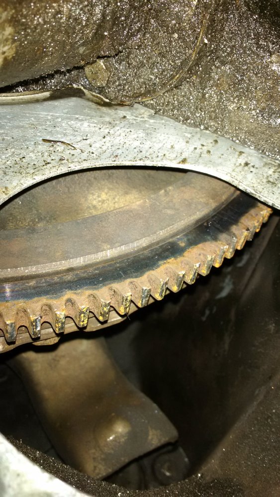

Visible teeth on the ring gear. Haven't spun the engine over since its late.
Brand new starter grinding on start. Engine starts every time but seems to slip/ not catch all the time.
Teeth seem to look in good shape. Now it is time to bench test the starter. When doing so be sure to hang on to the starter, or strap it down, as it will try to twist and then bounce around. Listen for abnormal noises and watch the to see if the gear gets thrown out all the way. Test multiple times in a row.
