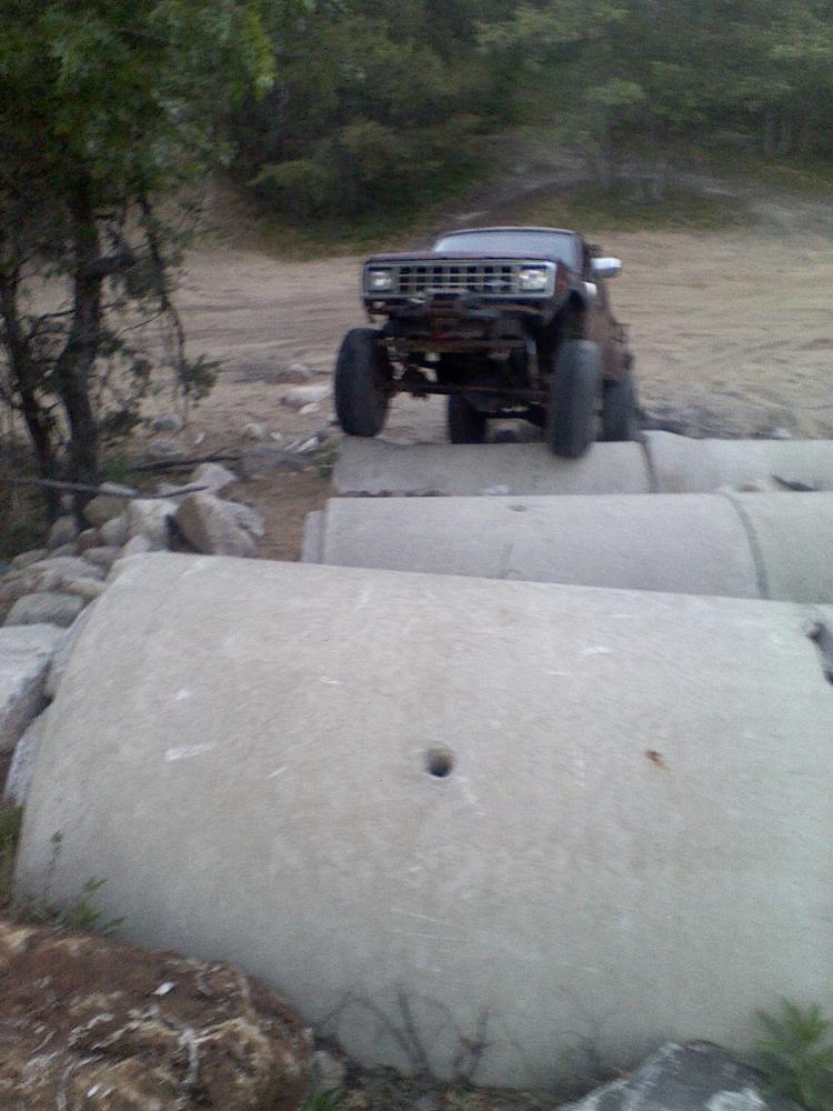

recycling cool old parts like that e brake just adds to the epic of this critter.
you will have the mini version of my compact :D
