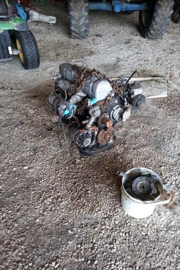

Hello ranger station,
I'm about to start a conversion on a 1991 ford ranger originally a 2.9 auto 4x4 and I'm converting it a five cylinder Mercedes turbo diesel with a five speed manual transmission and transfer case.
I'm in need of some measurements due to the clutch like distance from the block face to the front of the flywheel wear plate (sorry for my terminology) so I can machine adapter plates to the proper thickness and so the release bearing has its proper location if anyone has that information would be awesome

I had a 82 300d, loved it.
Deleted the waste gate, racked the pump A little And deleted the emissions. Got 35mpg and it would run like hell. Awesome power. Can't wait to get the ranger back up and running with it. :)
To the guy whose done this before how well did the motor fit in fairly easy or was there much modifying involved? I'm just curious and excited so any input I can get ill take someone else's mistakes is gold so you know what not too do... My car blew up a month ago so I've been riding my motorcycle but I'm Canadian so winter is comin fast need to do it properly but quickly.
Mine went into a 2000 with rack and pinion steering. Had to drop it 2 inches to fit the sump. Other then that it was close but made it
Beings yours is so old it should have a pitman arm. You will more then likely have to get a dropped pitman arm to clear the sump.
I reused the Benz rad to keep the trans and oil cooler but since your going to a manual you can do what you wish.
Clearance is tight. Get a electric push pull fan and it had to mount behind the grill vs In front of the motor.
Remember its vacuum shut off. So you have to get a Solenoid to make it electric shut off.
It has a built in lift pump so you can take the fuel pump out of the tank and run a dip tube and leave the fuel gauge sender.
On the right side of the motor bottom front there is a little white thing. It unscrews and you can prime the fuel.
Other problem is oil filter location. There is a rod the goes down through the filter and interferes with my wiper motor so I have to shorten it up.
And if you have a 7.5 axle I would run it easy for awhile. If you leave the motor stock I think you would be fine. Modify it would probably destroy it pretty quick

Hi, I was going to do a OM617 in my Ranger using the benz 240 stick flywheel and the Ranger 5spd. Wouldn't work because the bell is too small to fit the benz flywheel, and if you are planning on adapting the Ranger flywheel to the benz, that won't work due to the smaller diameter, the starter can't get any closer to the block to work. So you will need to think of another trans with a larger bell or a different motor, I went with a different motor.
I was gonna do a 5 speed unimog trans.
I found one with the inline 5 flywheel. Should have jumped on it.
As far as I know the 240 fly wheel will bolt up but it is different then the correct 300 wheel
Just gonna make a custom bell housing full custom shop we do lots of weird stuff know one else will touch really lucky to work here
