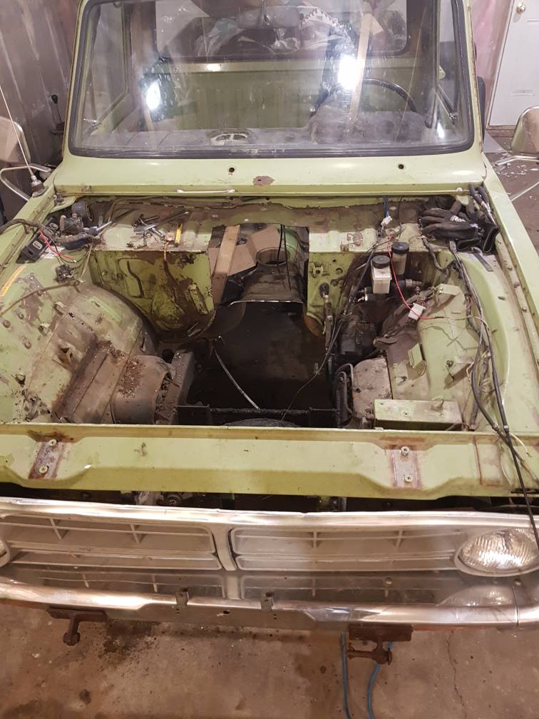

Im starting my build up in the off road truck build threads.
I think it will be mostly sheet metal work that is slow going on this one as I've done it before and the courier is simpler to work on being 45 years old no electrical really
Sent from my SM-G930W8 using Tapatalk
A teaser
