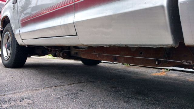

purchased a 1989 Ranger supercab today very solid and low km and no options on an xlt other than ps and pb. perfect donor for my 2.4 MB/OM616 engine. had been looking for a while and almost gave up and sold my powerplant but the mrs told me to hang onto it! very nice cab and frame, clean interior , outer body not so good but solid?
now I have to buy the adapter plate and get started, already discussed with the plate builder and it fits the 616 also just need to remote the oil filter. no problems.
patience pays off sometimes, I even got the interior colour and option package I wanted :icon_thumby:
a very good Friday and my diesel van>driver rolled 500,000 just before we got there to see the ranger :yahoo:
cheers James
