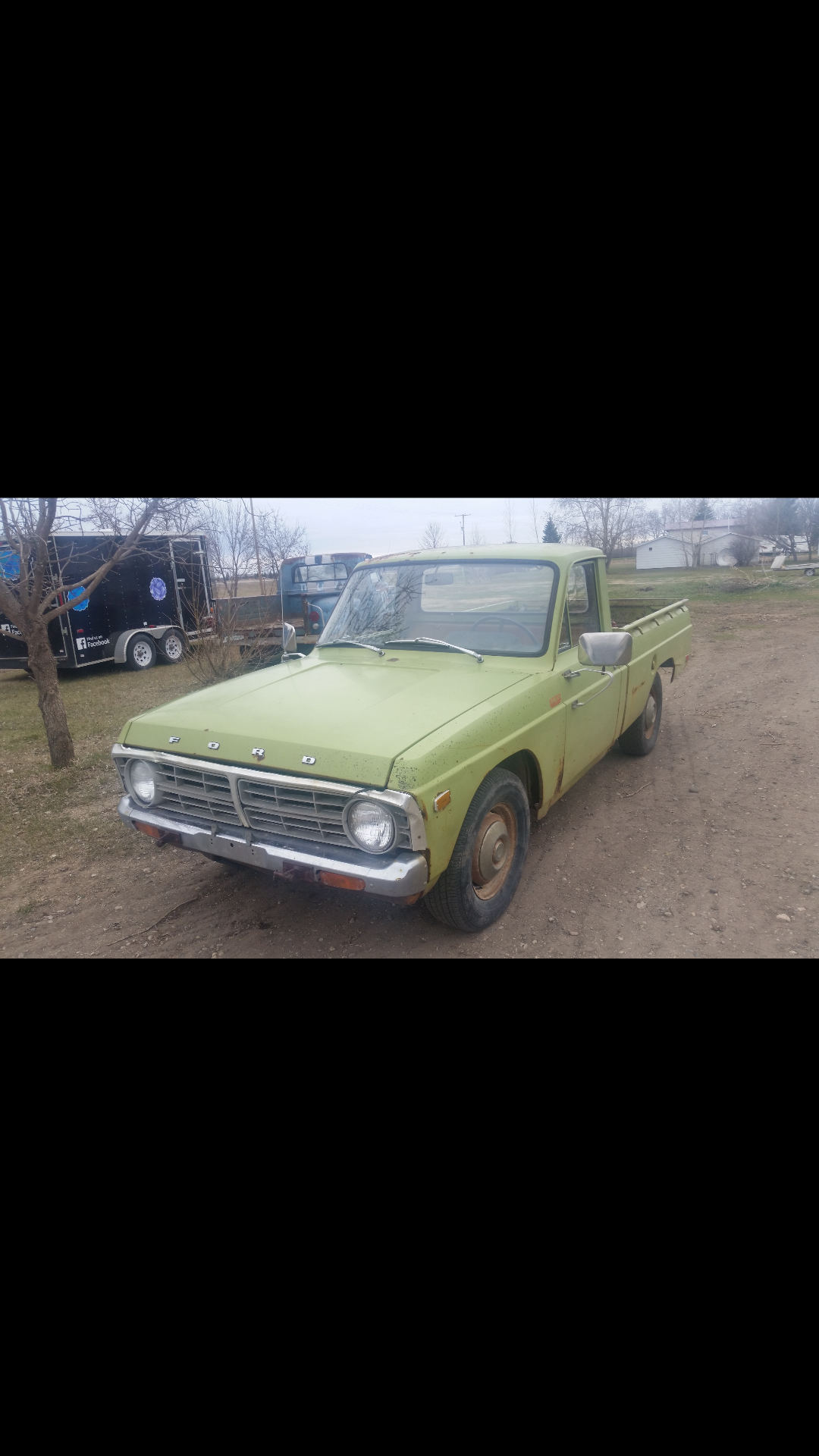

Well the 84 is out I could register it but never technically own the truck but since that I have been searching found and purchased minus pick up (tomorrow night) and rest of cash a vehicle I not sure if I'll be allowed to do a write up on here as it's not exactly a ranger
1973 ford courier running and driving fairly soIid body going to get some ranger parts in it
