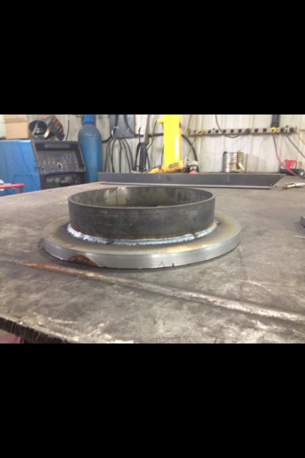

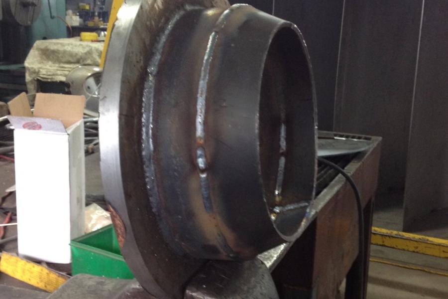

So I started to make the front of my bell housing it looks over kill right now but a lot more material will be removed before I'm finished. Just where I'm at

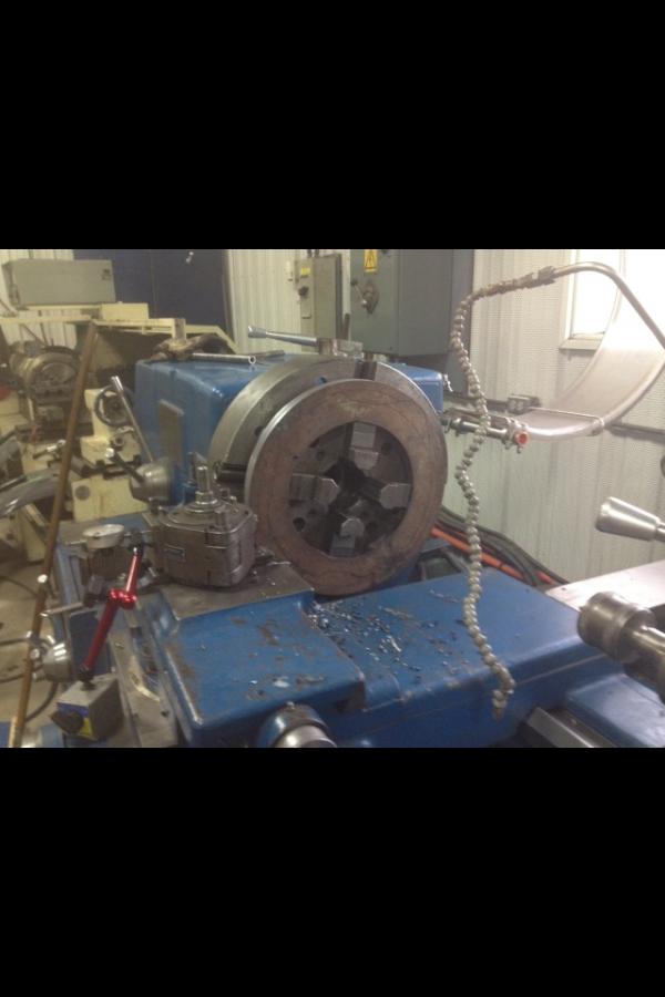

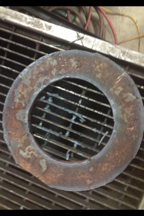

The first ring on the back is to make sure I clear the flywheel clutch assembly. I machined a register on the plate .050" thick for the ring to centre on for welding
As far as I am now hope to get lots done on the weekend.

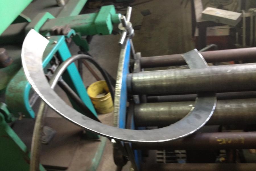

Been working on the cone of the bell housing hope to get some more pics up soon
