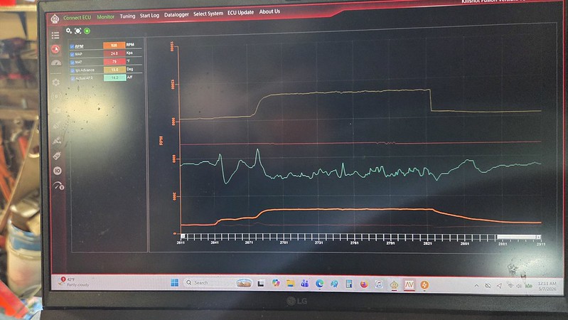

Did tha melt? Or did it just get accidentally crushed at some point?I was playing with the fuel table and shut the truck off for a bit. Went to restart and it started and died right away... and I lost everything. Like everything down to the dome light. All my added on stuff runs off a relay ran by the key power that originally went to the factory coil so without the original truck harness functioning I have absolutely nothing.
So I close out the aces program and pull up my scanned EVTM, eventually come across this:
I cut it out and jumped it and I got lights back.
I just deleted the connector to get the thing back inside before the rain got worse.
So yeah, most of the night was spent on a wire chase.
