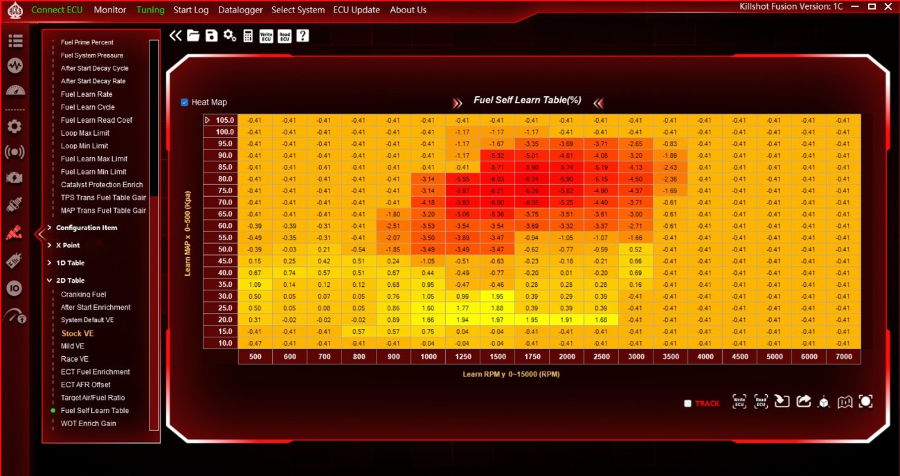

My initial self learn table looked like this:
Aces Killshot Fusion EFI Swap
I just drove it to town twice, you can see it is pretty much just nailing cruise RPM pretty hard (1500-2500rpm) .29 is the base value, if I zero the table it says .29 everywhere so I am assuming where it says .29 it hasn't been there to try to change anything yet.
I did some messing around and with a couple way too short drives I have it reading better.
I took a bit more out of the VE Table (in green) after that with the intent to drive it to work again today to get more data than my short drives last night.

Kind of amusing what it did to the fuel learn table
I just cleared it to let it cook as the base truck. I get that nailed down and it can adjust for towing or whatever from there. I don't want to set it for towing and have it messing with things to get it run right empty which is how it normally is.
