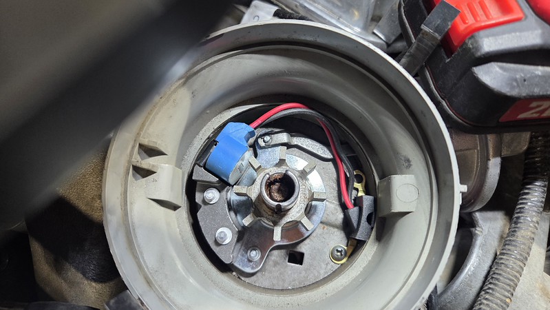

I popped the cap off and the rotor is on the same shaft as the reluctor so they can't get any more out of phase than they were originally.
However the pickup is really loose... maybe that is it?
Supposed to have like .025 clearance, I can get .125 pretty easy. And then it can almost touch the relucter wheel as well.

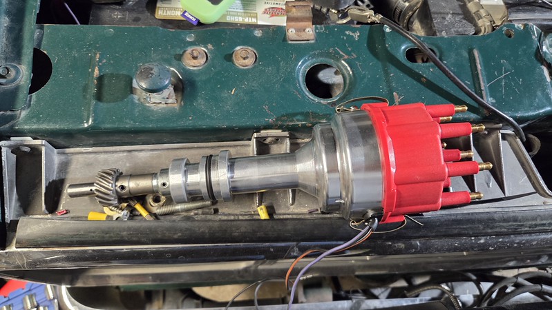

New dizzy showed up, ain't it pretty?
Aces Killshot Fusion EFI Swap

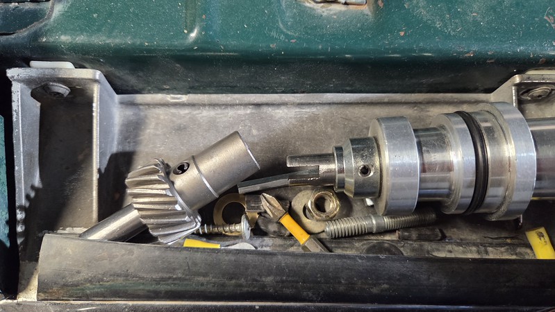

I was admiring it right after opening and there was a horrible thunk. What the heck... and the friggin gear is on the floor.
There is absolutely nothing but luck that holds the gear on this thing...

For future reference it is a Speedmaster PCE376.1257

I'm having trouble understanding that Speedmaster one. How do they expect you to pull it back out of the engine?
As near as I can tell... a magnet lol.
I see some have a two peice shaft like the Speedmaster that has a roll pin there
Most don't... I guess it would be a press fit. It has good mechanical engagement, it is probably stronger overall than just a rollpin holding a gear on the shaft... if it didn't fall apart lol.

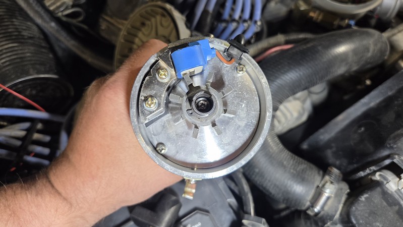

There is a notch in both shafts, that is to index the rotor. Compare how the notches compare to the reluctor paddles, the angles are not the same. It would have to effect the engine timing.
Duraspark dizzy:
Speedmaster dizzy:
