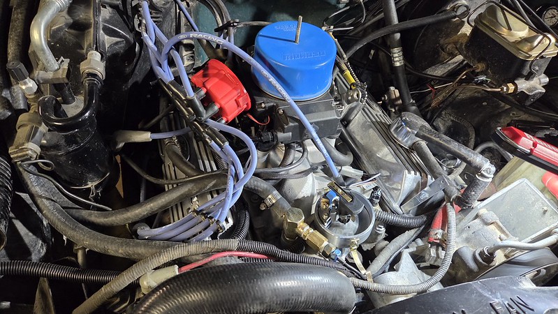

I got a new dizzy and no major parts seem to fall off... and they are not planning any severe weather so hopefully I can try it tonight
I got the dizzy stuck in it. I had to dig thru the stash and find a longer plug wire for #2, it wouldn't reach with the smaller cap. Lined the paddle under the rotor with the pickup coil sensor and set it to 15* BTDC again.
The smaller distributor is much nicer to work around, not having the vacuum can lets me put it wherever I want. I purposely moved it a tooth just to have more room for the cap clips around the heater hose lol.
It started right off. I sneaked it out and turn it around so I can let it run outside while still have light in the engine bay and nosed into the garage. Hooked the timing light and the laptop up to it and locked out the timing advance in the computer. Checked the timing quick and it was right on. Let it warm up, only wiggled the cap back and forth to check the line was centered on the pointer and locked it down. Unlocked the timing in the computer... slowly eased it to 2400rpm without issue. Then I reset the fuel learn table to get rid of whatever weird algorithm it cooked up with the screwy timing, gathered my courage and took it on the road.

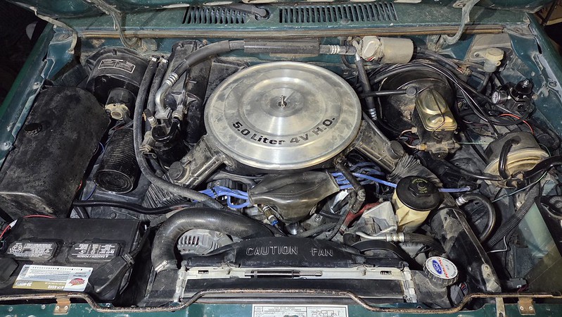

As I was swapping the distributor last night

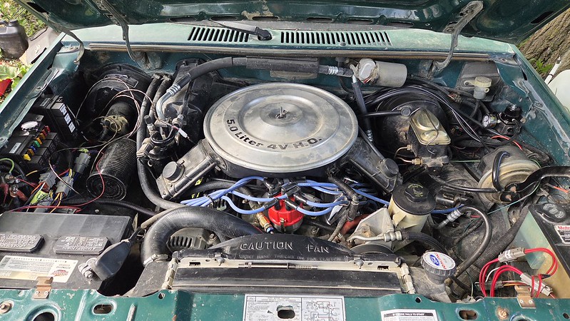

Put all the intake tubes back on and whatnot and put tools away tonight. Just a plain old 4bbl 302...

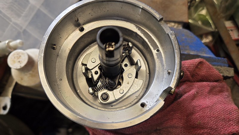

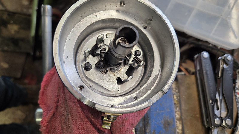

Apparently "locked" means different things to different people?
I got side tracked when the thing fell apart I really didn't look at either of them too hard aside from making sure the gear wouldn't fall off the second one. The one in the truck does have mechanical advance just like this one as well.
I pulled each weight off looking for a way to lock it up and nothing jumped out. Of course no paperwork and no info on line for them.

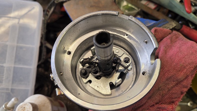

Aces Killshot Fusion EFI Swap
So I have a return ticket for both of these POS's now. I was hanging onto the first one to make sure I wasn't going to need to swap parts for the second one.
Looking into rephasing the DS dizzy now... although it is becoming very tempting to just throw Duraspark back on the thing.
I get that it's "not as advertised" so you're sending it back. But shouldn't any spring and weights based advance be as simple as replacing the springs with something solid?
Wrap a piece of bailing wire around all the moving stuff and make it snug.
Its been a long time since I've been inside, but wouldn't removing weights and springs then screw the two plates together?
To be honest when I discovered that last night I was so disgusted I forgot about the wire trick
I got some finer wire than baling wire, deleted the springs/weights and wired it up.
Runs like it should timingwise, now after 3 attempts at a locked distributor I think we can finally proceed to getting a tune hammered out.

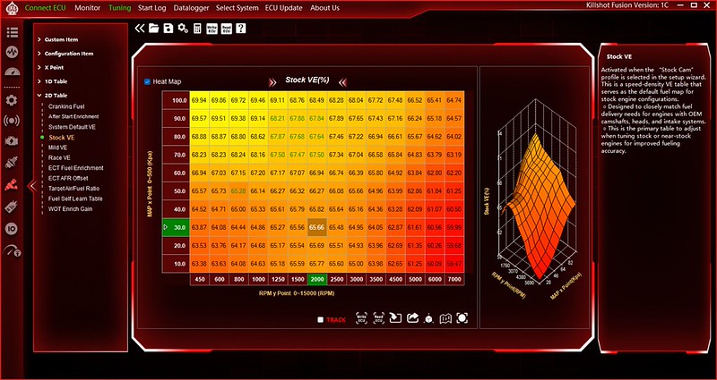

From what I have gleaned off the interwebs there are two tables that really are key. The VE (Volumetric Efficiency) and the Self Learn Table.
You pick stock, mild or race for the VE table (obviously I opted for stock because my engine is stock) The computer charts where it has to pull or add fuel to keep the engine happy with that table on the self learn table. Then you go in and change the VE table to try to get the self learn table to read +/- 2-5% (per strangers on the internet because there is no available official documentation on how to do this)
And then a bunch of other tables pull data off the VE table on how to operate everything else. People just slap it on thinking it is self learning and get upset when it isn't exactly right because it only controls the A/F ratio but everything else is still pulling off the untouched VE table. And it really isn't their fault because that is how they are marketed. From what I gather most of these TBI kits that are marketed as "self learning" are similar. Really a professional tune is ideal... but since I was cross shopping Megasquirt among other things I wanna try it myself first.

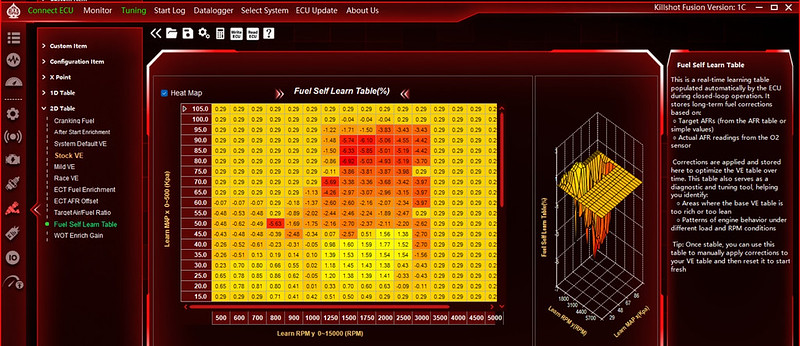

My initial self learn table looked like this:
I just drove it to town twice, you can see it is pretty much just nailing cruise RPM pretty hard (1500-2500rpm) .29 is the base value, if I zero the table it says .29 everywhere so I am assuming where it says .29 it hasn't been there to try to change anything yet.

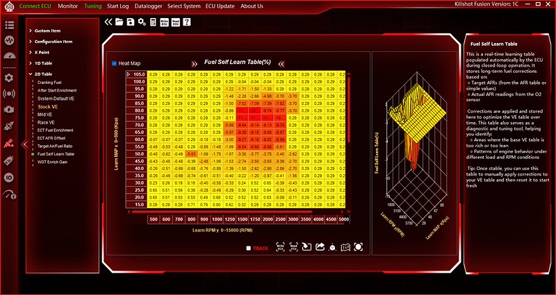

I did some messing around and with a couple way too short drives I have it reading better.

I took a bit more out of the VE Table (in green) after that with the intent to drive it to work again today to get more data than my short drives last night.
