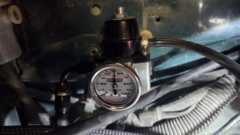

Fuel pressure is set, dizzy is locked down, plug wires are on and hooked up... start the countdown clock.
Aces Killshot Fusion EFI Swap
They want over 42psi, I went 50.

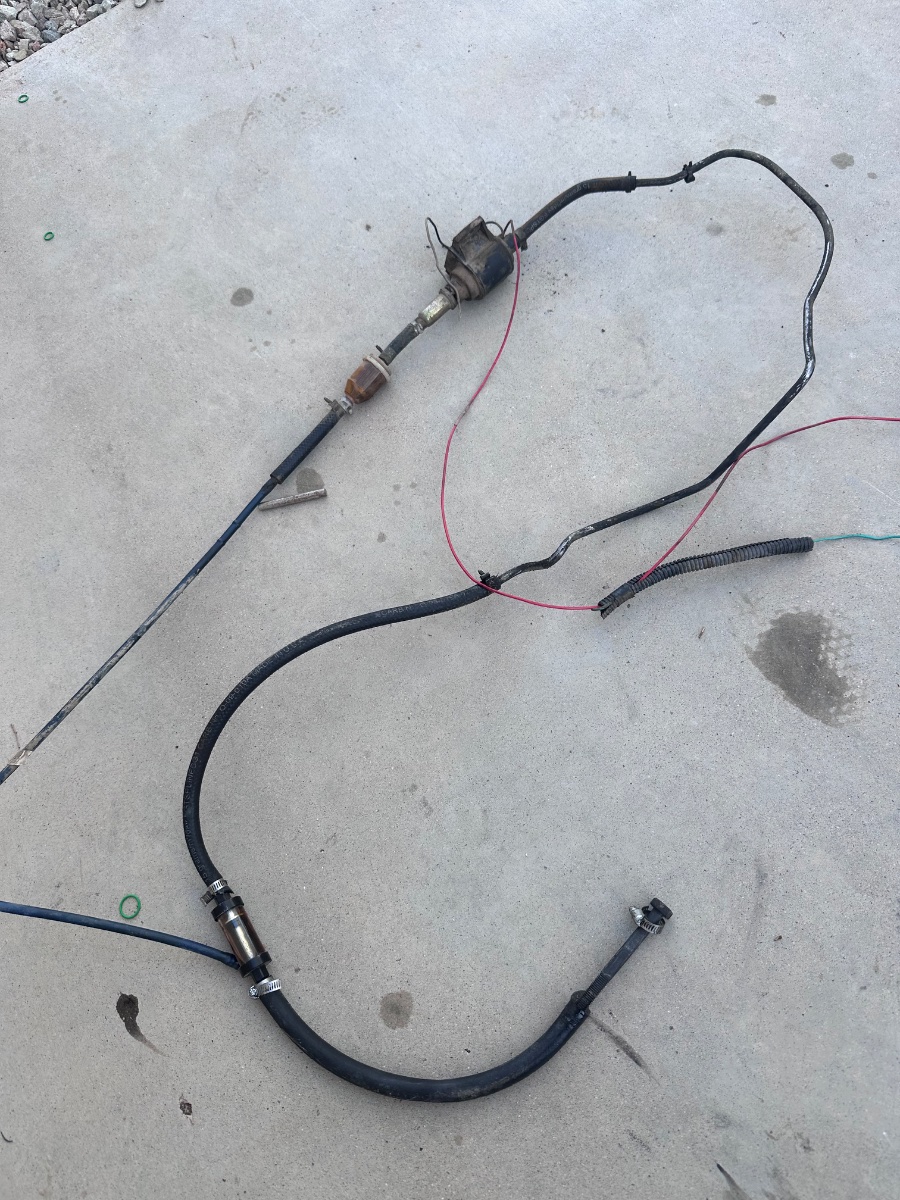

I just ripped out my old fuel line. I’m probably going to end up cleaning the old pump and use it for fluid fills muhaha

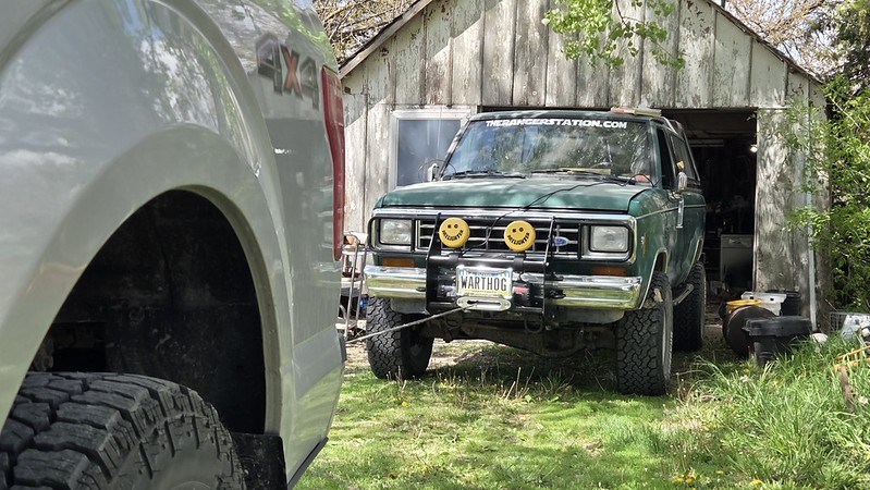

So I took a gamble and made it drag its sorry self out of the garage.
Dumped 4gal of gas in it, system primes immediately. It fired right off, kinda hunted for a bit and settled in to a nice idle.

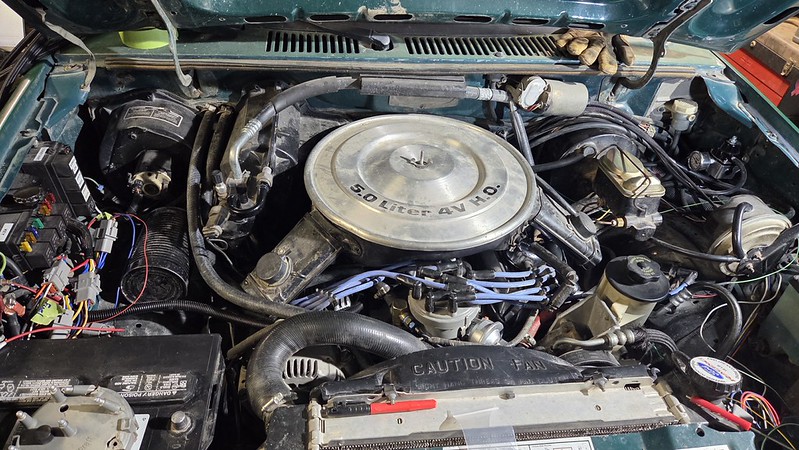

How it starts:
I didn't have the fans hooked up so I didn't run it super long, temp got up to 190, dash gauge even works. Sender for Autometer gauge had a drip.
So yeah, I am pretty stoked! :yahoo:
It does have tip in bog which is pretty well documented on how to deal with. It also kind of hunts a bit. Like I let the clutch out and the IAC opens to keep the idle where it was, Push the clutch in and the idle climbs until the IAC pulls it back down.
But its still a baby, it hasn't done any learning at all yet either.
It is downright AMAZING how smooth it idles as well. I thought it idled fine before but everything down to the exhaust note is totally different.

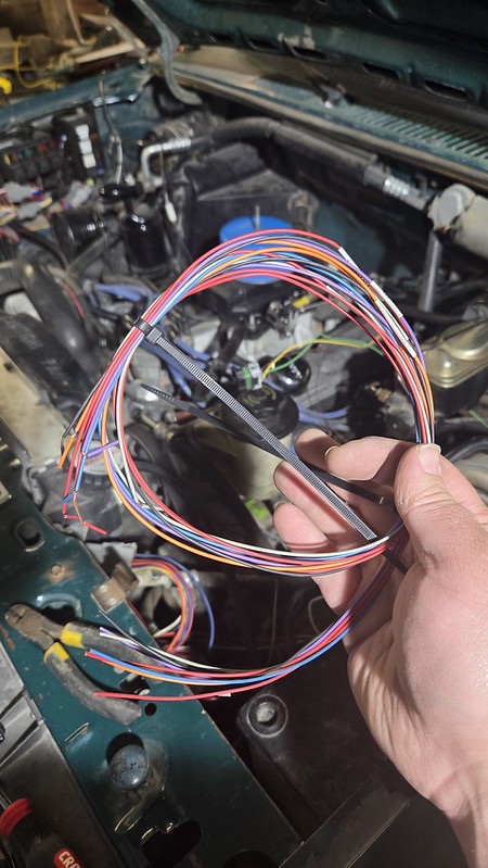

Anyway, tongiht I circled back and I think I fixed the coolant leak by throwing more fittings and several different more connections to leak. I did put the efan box back together and plugged it in and put a lot of the new wiring in loom. And I also deleted this tumor of wire.

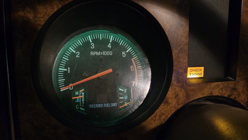

Fans are MIA... but I remembered I can bypass all that to make them run so I did that.
Fan1 is set to come on at 195, it never did so I need to check into that. Fan2 is set for 199 for testing and it did come on... which triggers my CEL (also note my factory gauge is now working)

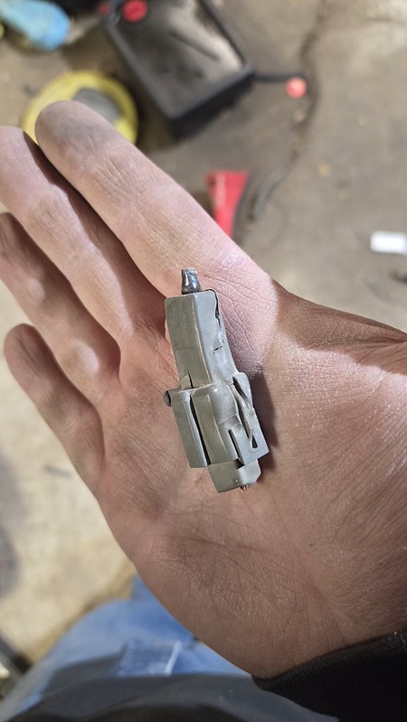

I was playing with the fuel table and shut the truck off for a bit. Went to restart and it started and died right away... and I lost everything. Like everything down to the dome light. All my added on stuff runs off a relay ran by the key power that originally went to the factory coil so without the original truck harness functioning I have absolutely nothing.
So I close out the aces program and pull up my scanned EVTM, eventually come across this:
I cut it out and jumped it and I got lights back.
I just deleted the connector to get the thing back inside before the rain got worse.
So yeah, most of the night was spent on a wire chase.
