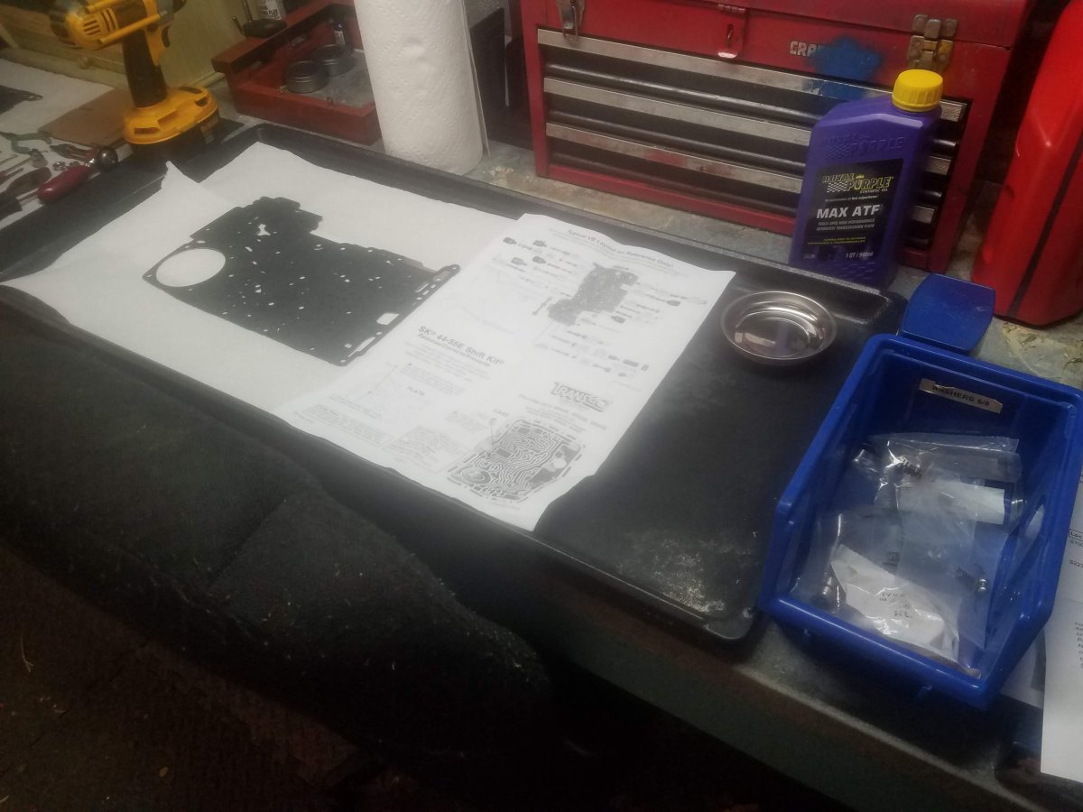

For my work table I got one of those big trays for the bottom of a rabbit cage so nothing rolled away....
Ignore the royal purple ATF, I only used that crap to lube parts before assembly so I didn't waste any precious motorcraft Mercon v. :ROFLMAO:
