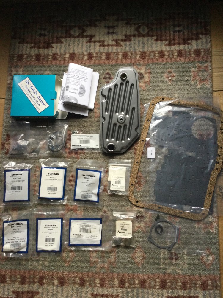

No parts, FedEx delayed the delivery, it’s been moved to tomorrow. Figured out that I didn’t have reverse servo O-rings but had the gasket coming. Called a bunch of transmission shops, most didn’t answer. One of the bigger ones answered and when I asked for the parts they told me they don’t sell parts and pretty much hung up on me. Called AAMCO of all places and they said they didn’t sell parts and I explained my problem, they told me they would check in the back. Came back and said they were pretty sure they had the O-rings so I ran down there and got them. Asked how much and they said no charge.
Got home and dropped the pan, it’s dripping now. Not sure how concerned I should be that there was no magnet in the pan and the fluid that poured out was clean red but there’s a pretty good metallic sludge in the pan. Not sure if maybe I should leave that go back in or clean everything out, or just put it back the way it was and pretend I didn’t see anything

Not sure when I’ll get to the video stuff, maybe this winter. Transmission parts supplier never responded about my questions. Still need to post up my final parts list, there was a couple things in the picture of parts that weren’t really needed and some things that were. Maybe today I can at least get to that.
