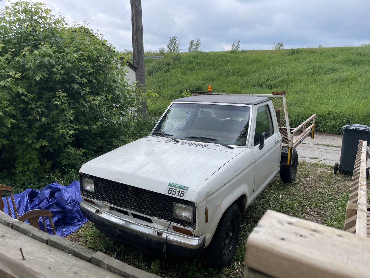

Hey guys could use some of your wisdom and knowledge (Novice here).
To preface things, I bought an 87 with the A4LD about 2 months ago with 87k miles as my first project (Not road-worthy yet according to my province’s safety standards). I’ve changed all the fluids except for the transmission oil and have already done quite a few small and moderate repairs. So far it’s running really good. In the midst of all this I want to drain and refill the transmission oil but all the multi-vehicle ATFs and backwards compatibility business is getting really confusing.
