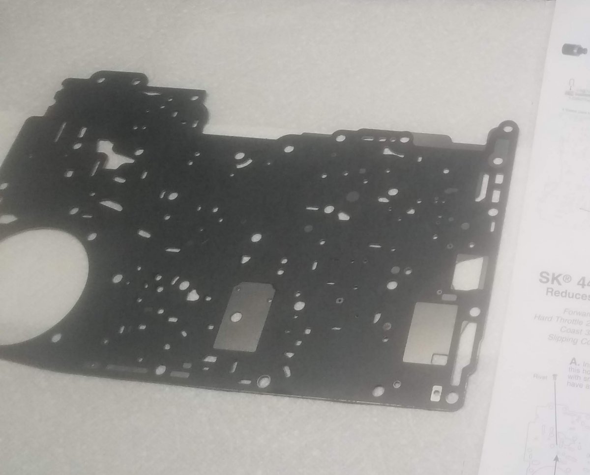

Well found pics of my bonded plate and below is my 5r valve body. Still looking for the part number for the plate!
Now that I look I highly doubt the bonded plate will be available for the A4LD. The A4 only has 2 shift solenoids, the 5r has 6 so valve body is very different.

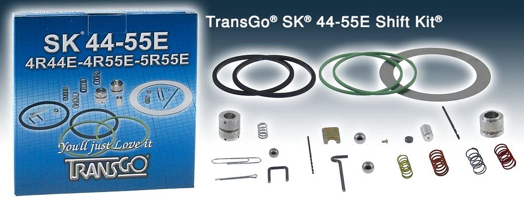

Oh and you see those two ball bearings in the picture? You think they go in the transmission right?
WRONG!!! you take those ball bearings and stick them between one of the holes in the separator plate and smash them with a hammer until the hole shrinks to the size of the pin they give you. Very very technical procedure. :icon_rofl:
I don't remember what the paper clip is for but it's equally as scientific in it's useage. Don't get me wrong there is a method to the madness and the crap they have you do works. Why sell you a whole new plate If you can fix it with two ball bearings? It's a true DIY kit. Most of what you're doing is modifying stuff not just swapping parts. You're really just paying for the directions and a few little pieces. Even the rings shown at the top of the pic don't get used unless you have the transmission fully disassembled. They can't be installed by just dropping the valve body.
