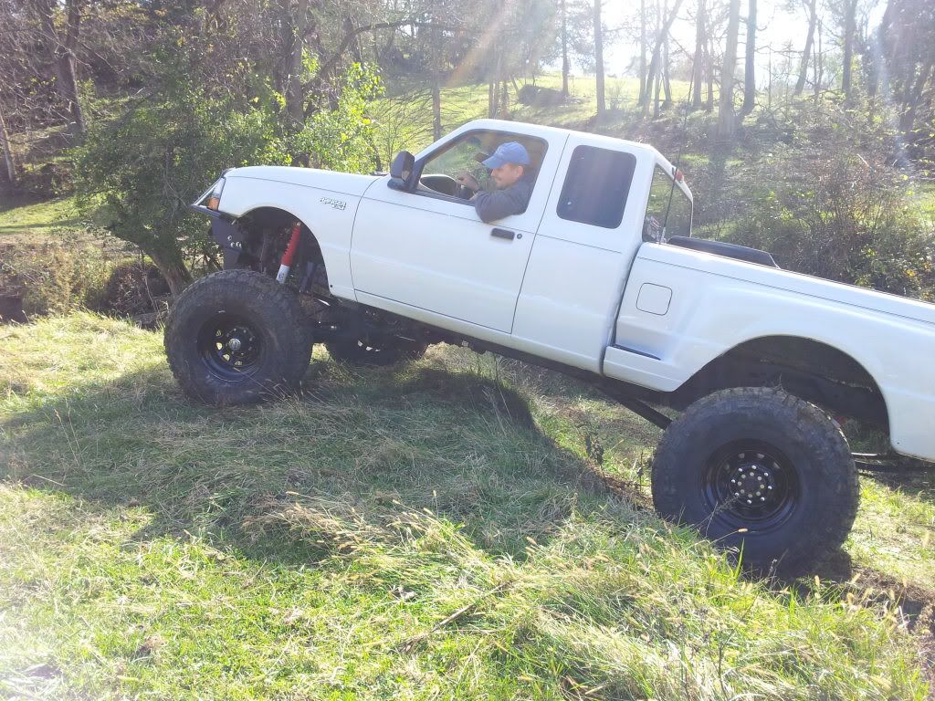

Did some wheeling with the club today,

Looks like a good time. It's just a rocker panel, it was bound to happen at some point. I just cut mine off cause it got so messed up.

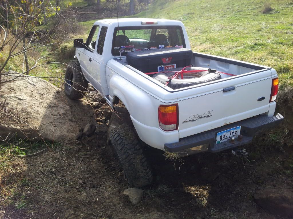

Well got to go over the truck the other day from the last wheeling trip, looks like i also twisted my pitman arm and my rear frame is bent. The top of the box is about to hit the cab and the bottom as a pretty good size gap. I can also see the stress marks where the frame bent, it right where the shock mounts are riveted to the frame. Havent decided what to do next, either make a truggy out of her or cut off the frame before the bends and redo the frame.
Fuel tank in the front of the bed, 4 link, airshocks, then chop it at the bent part.

Yikes. Thats not good. I'd like to see you keep it as a truck. It has a mean stance and out here truggys aren't street legal lol.
Could you get a good donor frame, box and strengthen it and the move the parts over? Or find a clever way to mate 2 frame well? Or have a frame shop straitened it and then you strengthen it?
Sent from my iPhone
What do you think was the main cause for the extra stress on the frame? Concerned because I'm supposed to finally take my truck out for my birthday. I'm getting ready to install the 63's. That means I'll have my bed off so maybe I'll do some boxing of the frame.
If its not too much work to fix then I would fix it. At the same time though, it would be cool to just cut it behind the cab and tube it. I want to do it to mine eventually and keep the bed skirts. I like the look with the bed on it.
Those short and stiff leaf springs surely don't help matters.
Take the bed off, strip the suspension. Block or jackstands under the bends. Chain the front to the ground. And with a comealong on each frame rail, over pull it and release, checking bed fitment often. Once your satisfied, box the frame and roll on with your spring swap.
