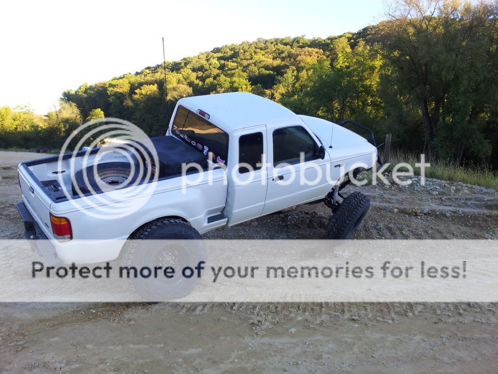

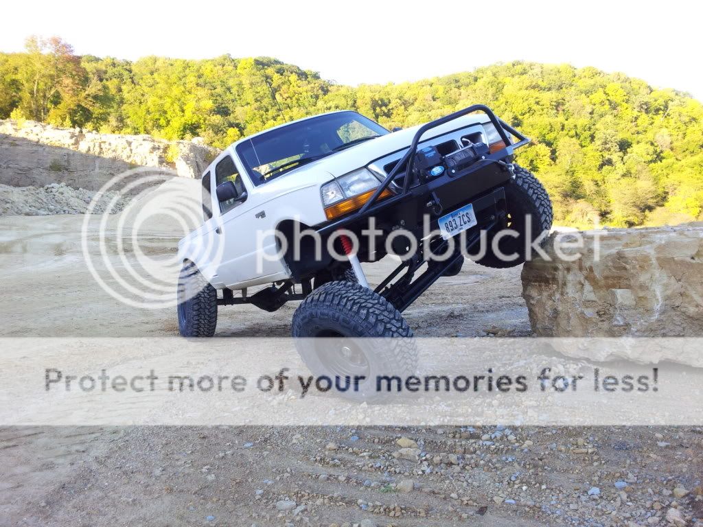

Stretching her legs at work today.
I work at a under ground silca sand mine.
