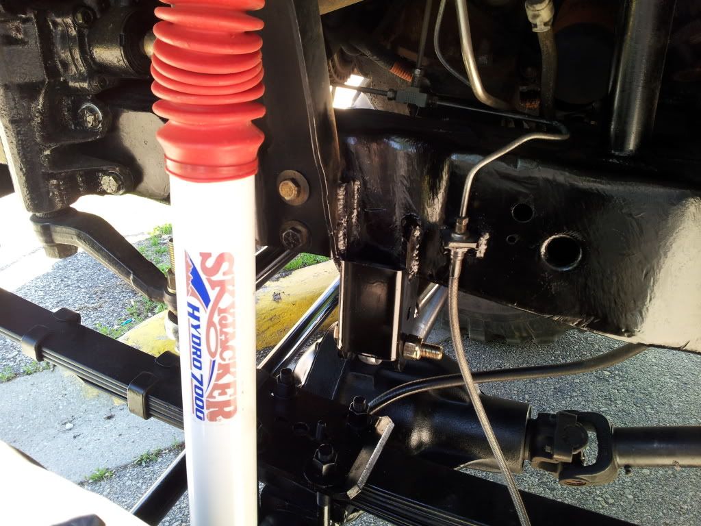

A little update. Been getting a little shifting from side to side when going around corners because the spool is pushing, so i installed a trac bar yester day. Made a real big differnce in the way she handles and the steering is so much firmer now.

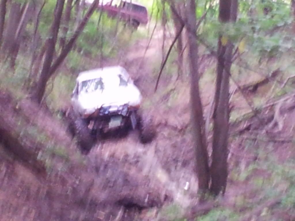

Well did a little wheeling with the local club on saturday. here a few pics,
