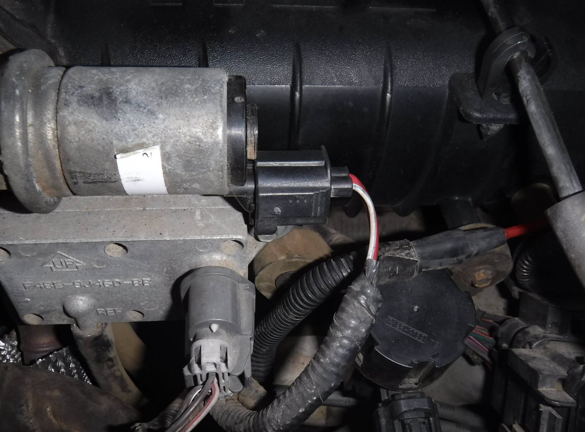

Sooo, I haven't got the air sound and miss completely resolved, the miss not at all :/
I have narrowed the sound down to here though, after replacing the IAC a couple times today with different gaskets, bodies and such. I removed the accessory drive belt and hooked everything else back where it goes so the turning fan, alternator, water and power steering pump would be silent, and used this hose to listen closely

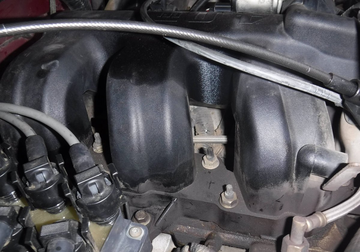

The rushing air sound is almost entirely in this area, down deep, strongest beneath the intake, inside those little pockets there
34445
and from the driver side, under the intake below the IAC plug, inside that little pocket there
34446
Suppose I'll need to come up with an intake manifold gasket set and get that done soon, the weather here is fixing to turn bad now, not sure exactly how long

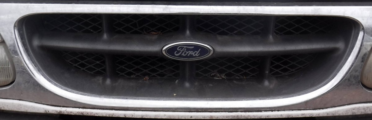

Thinking about grabbing this 98 grill to go on my 96(mine's done a lot of sun fading)
34449

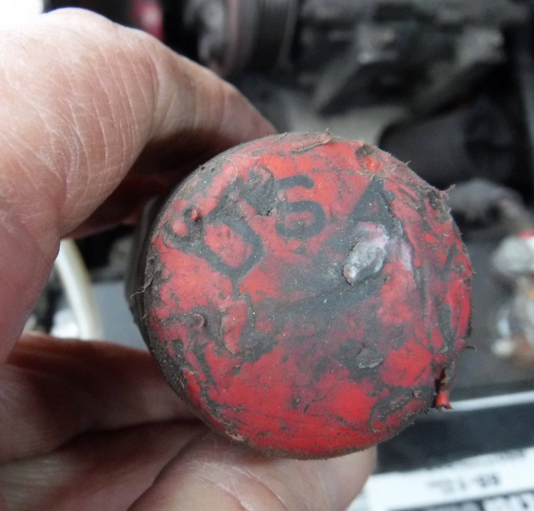

Also come across another tool, a USA Snap-on 10 or 12" screwdriver
34450
34451
Someone had left it propping up a hood. Think I have about as many cool tool finds as parts!
