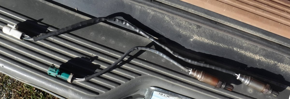

Will these O2 sensors from the 93 Ranger 4.0 do well enough on the 96 Explorer 4.0?

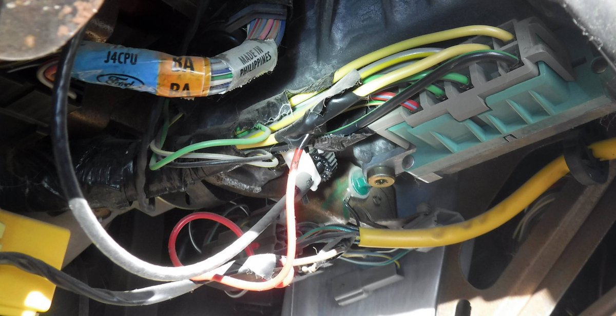

I also made another attempt at the shifter adjustment, this time going also into the steering column, but after getting there didn't see how to get to it, later looked back at my notes and maybe missed it by not having pulled the locking mechanism. I did see though they've done some creative wiring in there

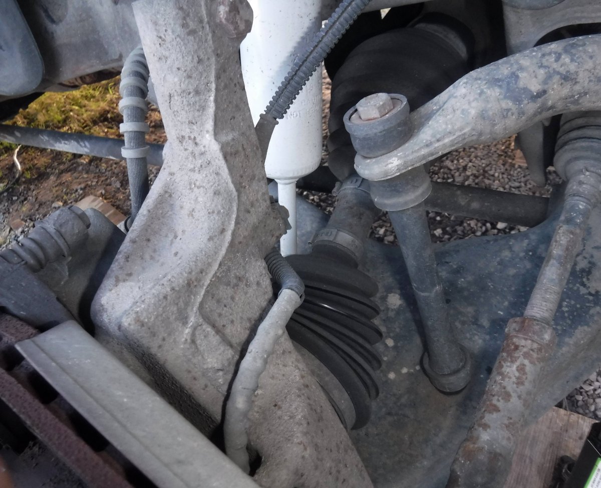

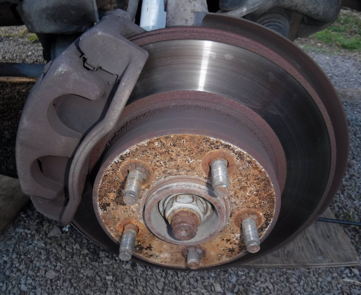

Also while routing the O2 sensors had to pull the RF tire and found the rotor to look rather heated I suppose? It almost appears they've never touched them before, but the pads were not badly worn. They said they'd had the front end rebuilt, and it does run very true, but all I can see that really looks much different from the rest is the outer CV joint

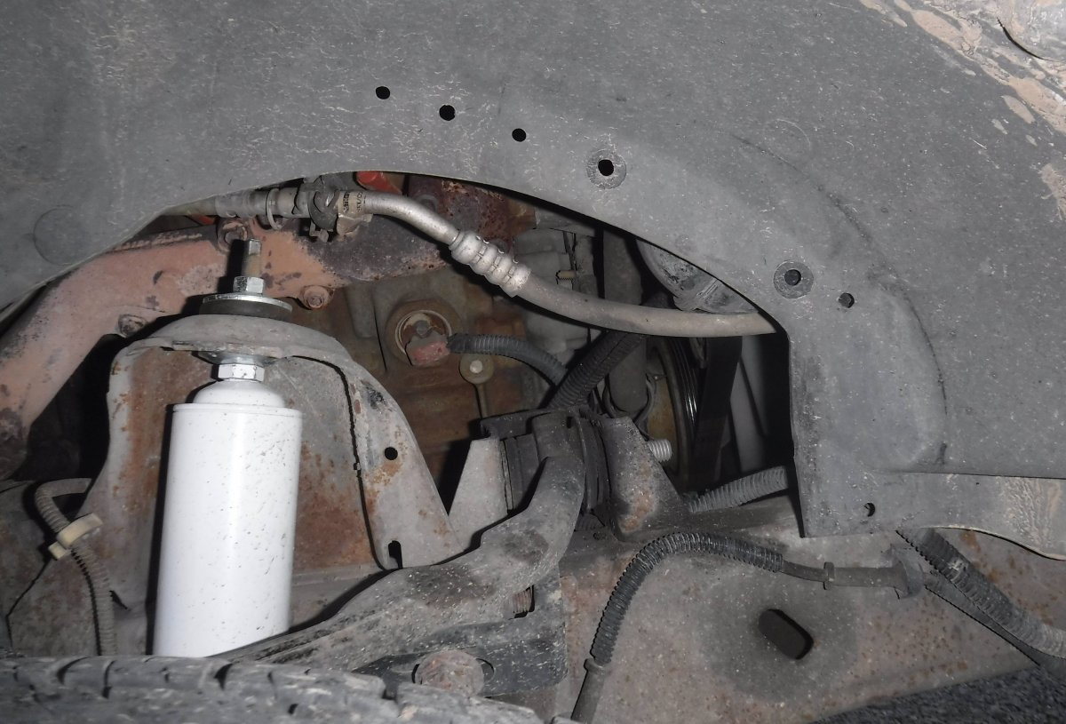

Finally got the 5th shock a few days ago, rear damper, got it put on.

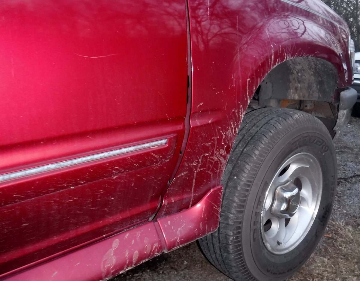

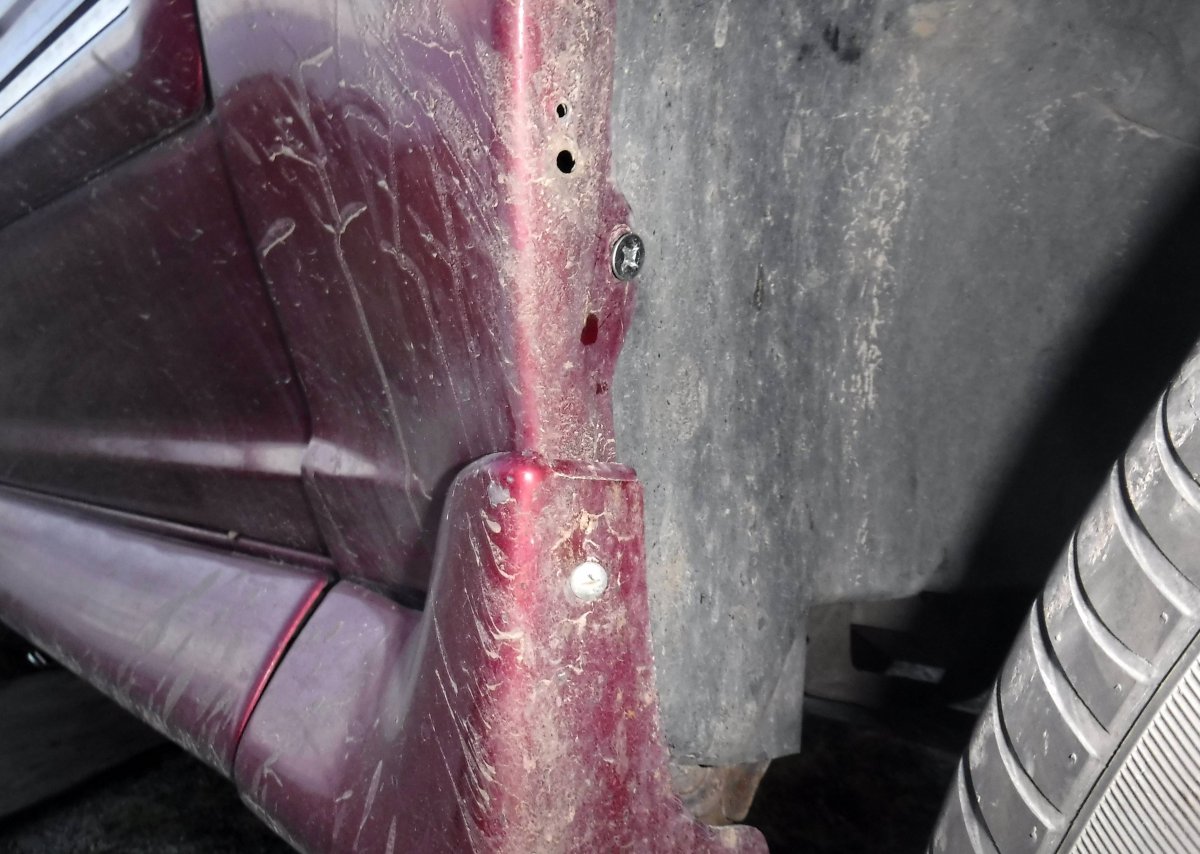

Looks like someone used a jack under the front fender post just in front of the RF door to raise the vehicle, goofed things up here a good bit.
34361
I had already pulled the front runner piece in and ran a screw into it before going to an extended family Thanksgiving early November, but added a couple more trying to secure the wheel well a bit better
34362
Looks like I need a few more pieces in there too

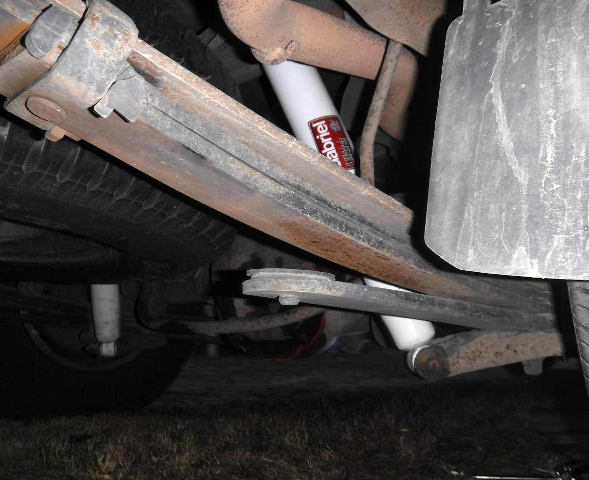

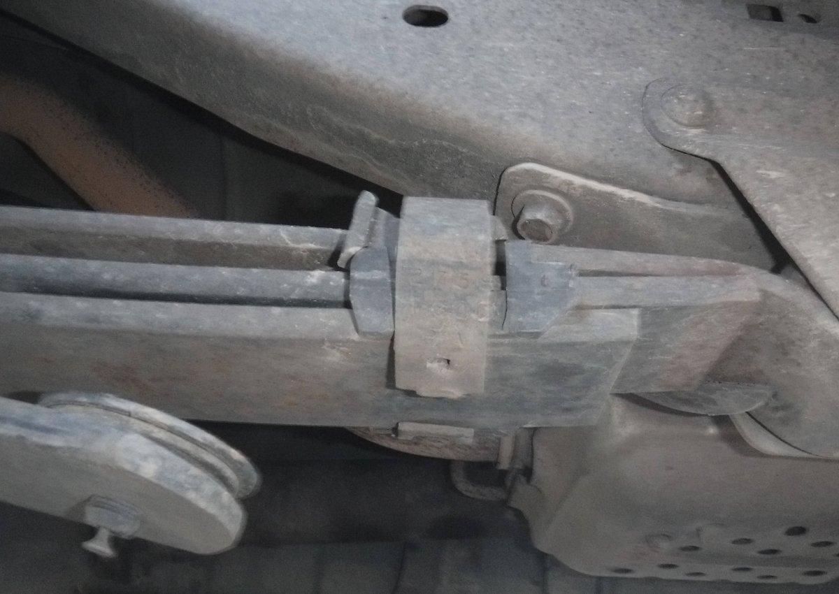

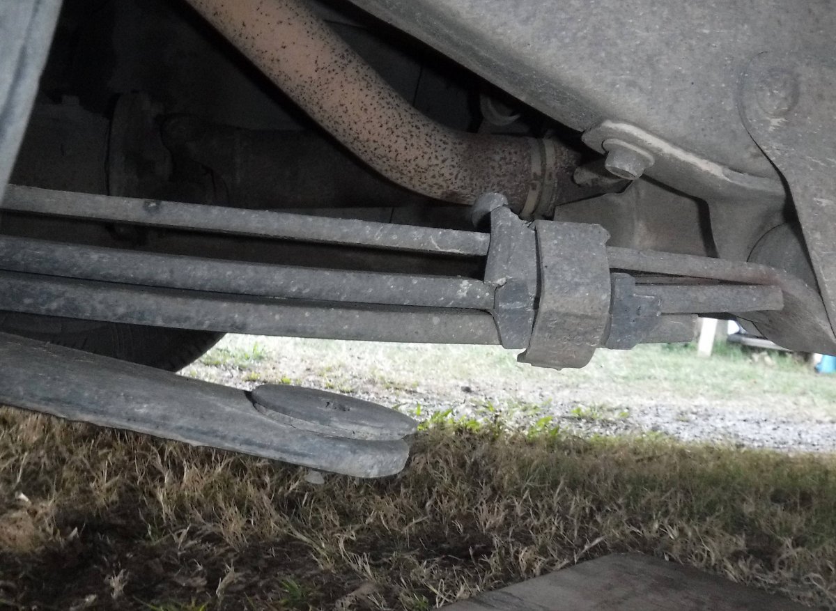

The right rear spring also has some damage from something
34365
34366
34367
View attachment 34365View attachment 34366View attachment 34367
You sure that's the original springs under the main leaf? The long one looks too long for stock. I also don't like how its digging in at the curve of the main spring eye, that's a crack waiting to happen.
I saw it on FB marketplace and after a few messages back and forth pretty much decided I'd get it if the motor looked good when I got there. They said it had a good engine and bad transmission, which I pretty much found to be true. Somewhere in the transaction He mentioned something about the rear springs but can't remember exactly what it was. They had it less than a year, and it may have been through a number of owners but I didn't see any reason to believe it had been abused. He said maybe "you're not gonna like" or maybe that he didn't like what they had done to the rear springs, but I didn't question what he meant.
Are they hard to swap out?
The motor was doing great until I ran those ornery plug wires, and possibly leaned a bit to heavily on the manifold, hadn't fully realized then it was plastic, hope I didn't crack it. Or maybe just the IAC, I think it's two piece, and possibly loosened the crimp between them, but haven't examined it well since that scenario crossed my mind.
