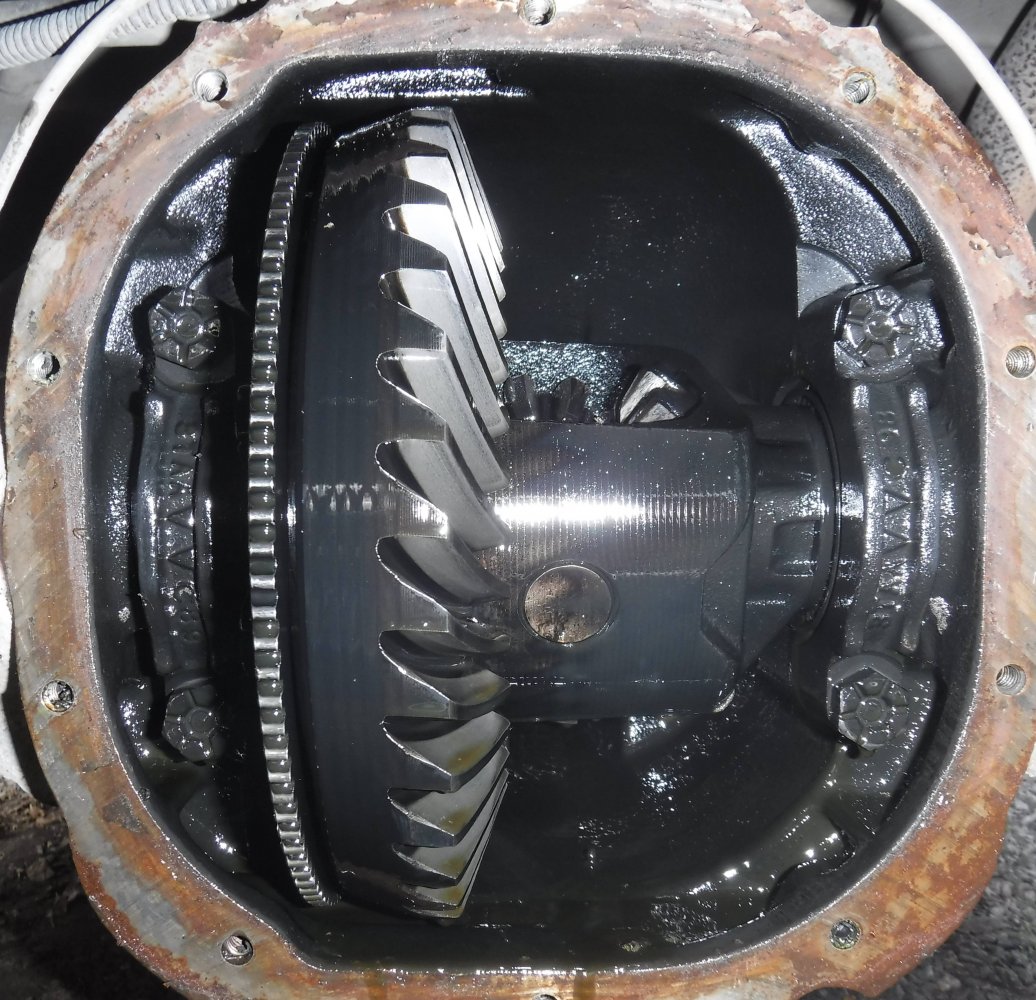

On another page, I did pull the Differential pan today, probly first time it's seen daylight in 220,000 miles

Diff looks ok ish

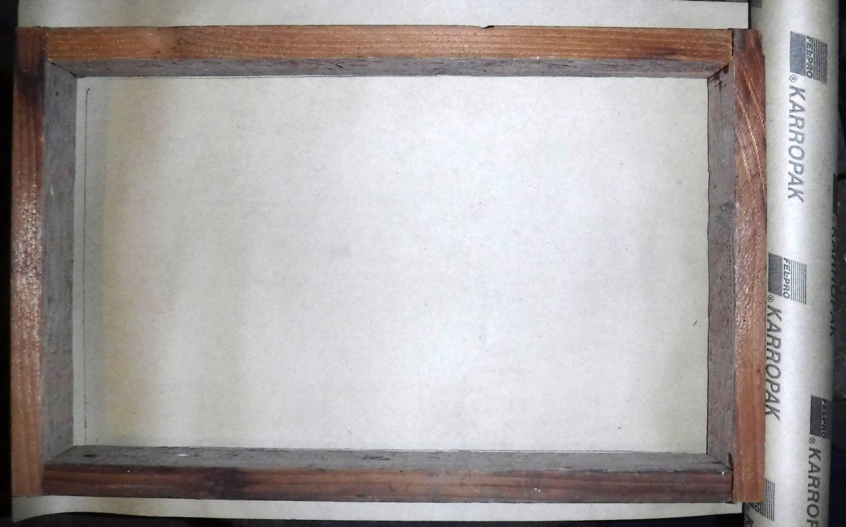

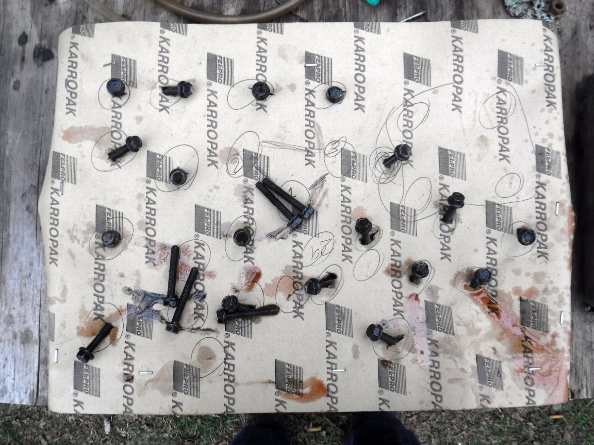

So here's what I've got for the valve body replacement. Didn't really have a suitable cardboard to draw it on, so I used some bits of wood to build a frame with some screws and glue.
Then added some old Felpro gasket material to the mix,

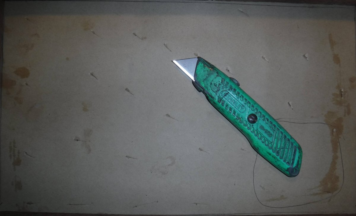

Layed the valve body onto the material, and stamped out marks to the bolt hole with an old friend of mine, a Hilti nail(makes a great center punch into Anything).
Made slots in all the marks and stapled it onto the frame.

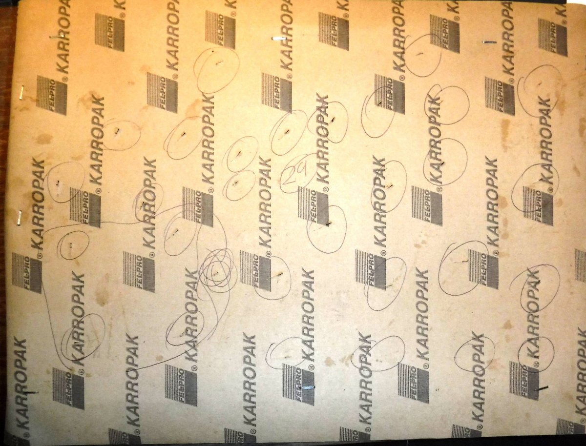

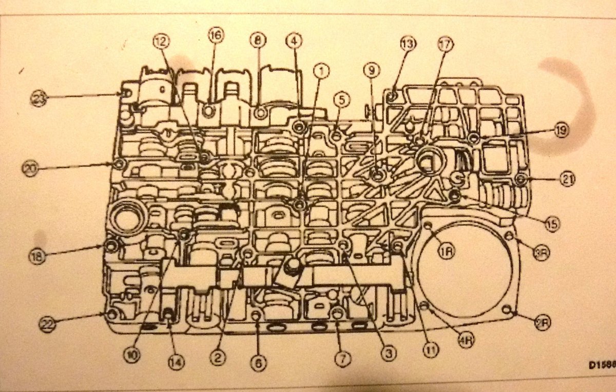

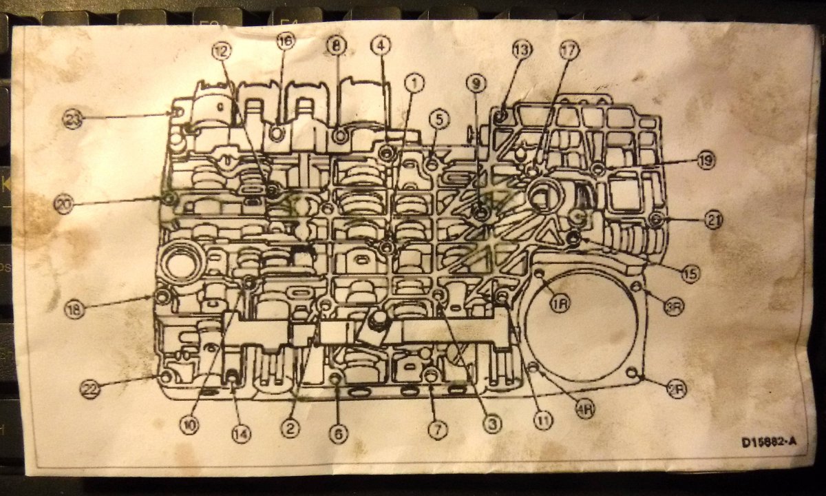

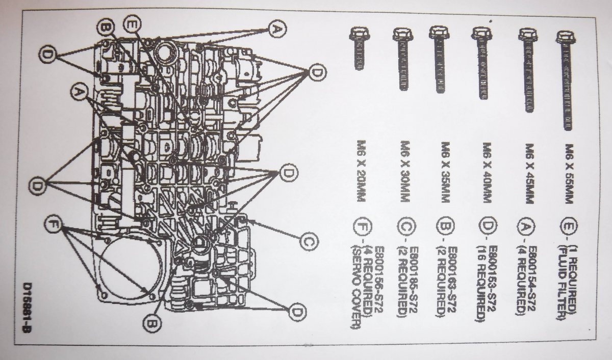

Used a printout of the torque sequence
Turned the bolt locations one sideways as opposed to upside down. (Funny how they used a musical progression in that one eh?)
and circled where they go
I don't think this post will work well, for some reason, but it's just all in steps :)

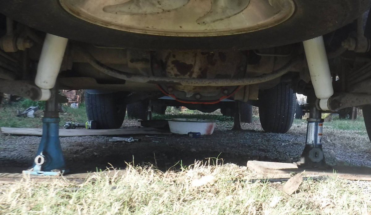

I got it up on jacks all around and lifted maybe 3 inches on each one. I've come to really like those factory jacks, that one on the right is from the 93 Ranger, the blue one on the left is probly 20 years older and came from a sale a couple weeks ago,$2, one in front is from the Explorer and another from the wrecking yard, another couple of bucks. They're easy to move around and use, and don't ever leak oil ;)
I dropped the pan and filter off the transmission, put the oil in a 5 gallon bucket for recycling, got the solenoid harness all loose and pulled the servo cover and piston. I believe the server has still got to come out too, but wasn't real sure while I was under there. I had hoped to get the valve body out too but was running out of daylight and didn't want to rush it. Tomorrow is supposed to be a decent day also, so I hope to get the valve body swapped out and transmission all back together.

The gasket material worked well enough to hold the bolts, but it was difficult to match them up with their prospective slots as I had to transfer from a view above to a flipped one on the ground, but going back together I only had two (X2) I had to switch(one too long, one too short, switch kinda deal).

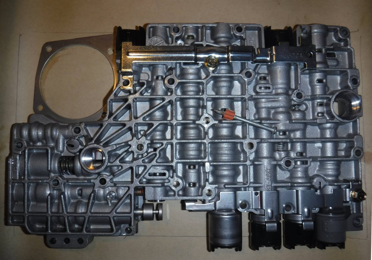

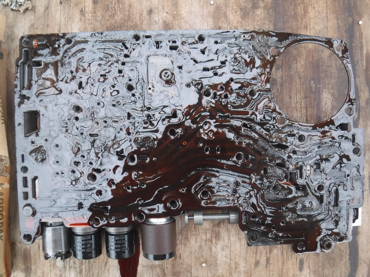

I also believe it was rather jammed up in places. As the photo shows, there were two big blobs of goo on top on removal. ( just below center on the lower left) I hadn't wanted to post this shot because the camera saw it much differently that I had in the sunlight, all I saw was the two big blobs on the seal, and a very oily surface(no real differentiation in the colors)
