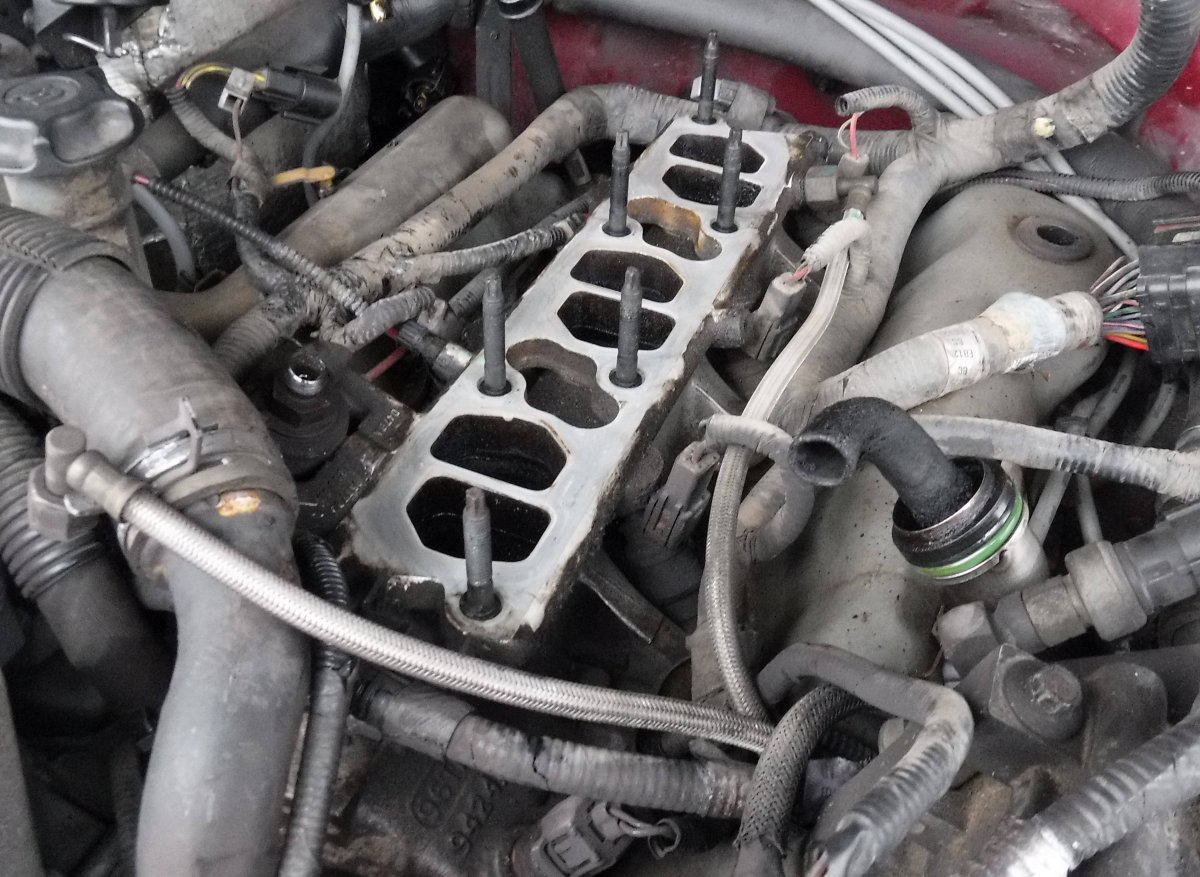

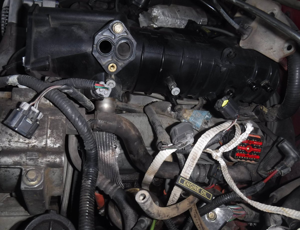

This is as far as I've got, at least had hoped to get the intake manifold free today, but it's Saturday anyway, usually my day off
34620
Here is the final hang-up, that pipe to center left, going in below the IAC ports
34621
I was thinking this was involved but was on the wrong track there I suppose. I won't be able to get the lower intake until I round up some reverse torx sockets, but will go back together with at least the intake manifold gasket replaced and see how it does with that. I may need to get another intake gasket if it needs to be done again, but even having to do it twice will be alright, at least I'll have it figured out by then(maybe ;) )

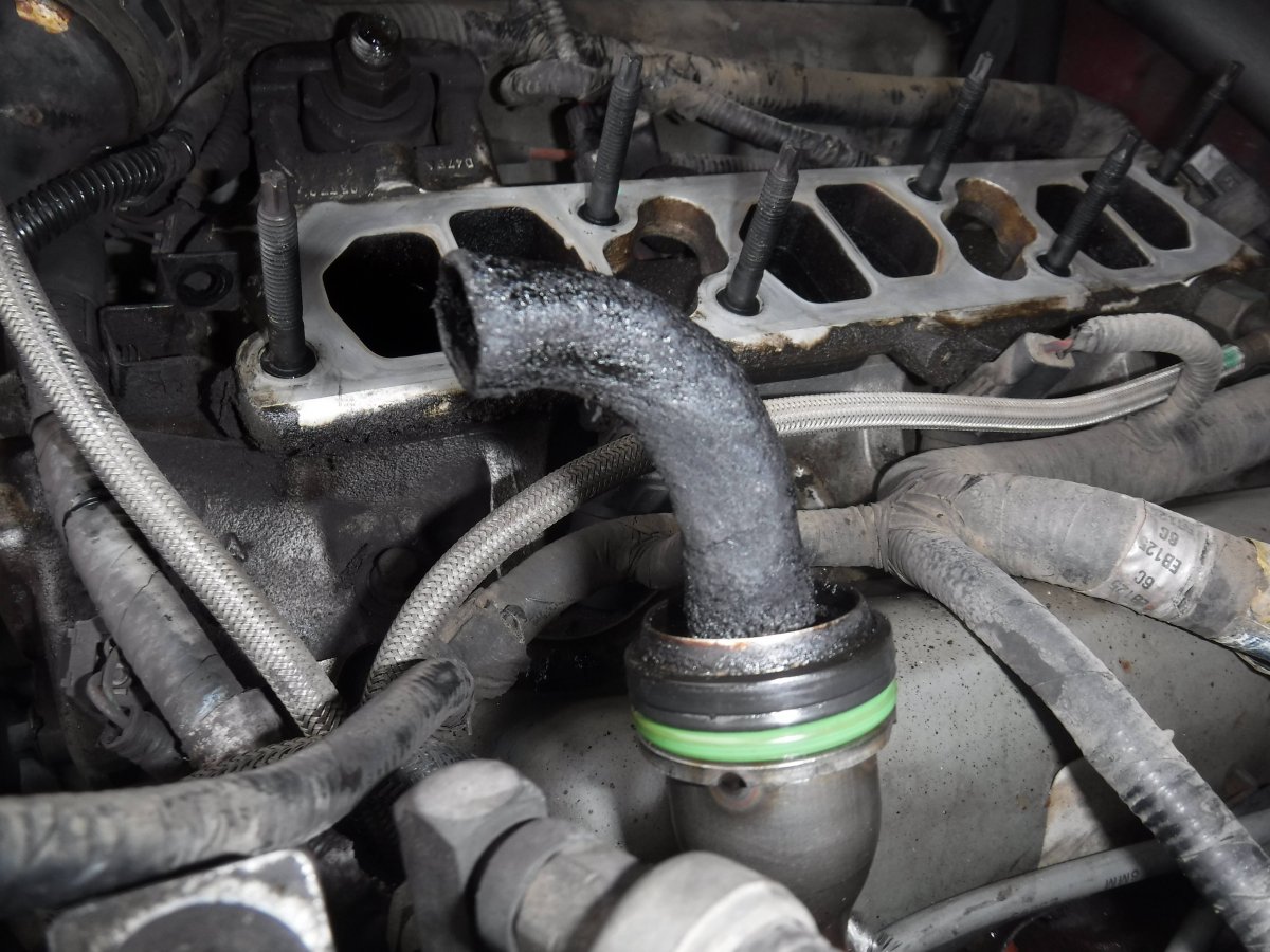

34623

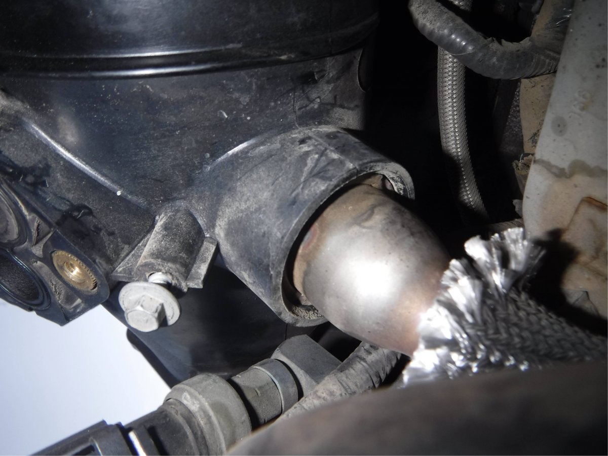

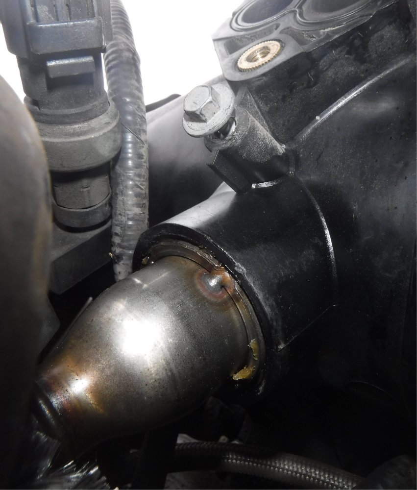

And here's what's holding it up, wondering if I turned the manifold a bit it would break free
34624

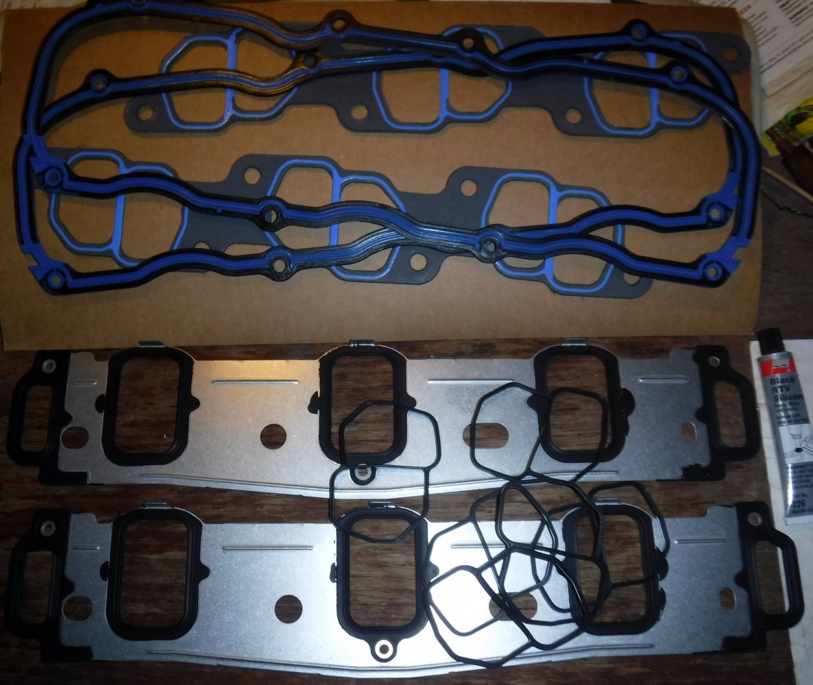

This is the gasket set I have
34625
Is there even an intake manifold gasket in this set?
[/QUOTE]
Yes there is.
I've been studying into that. It seems the O-ring ones are all I'll need for the upper and there's 6 so I won't need more to do it with the next time

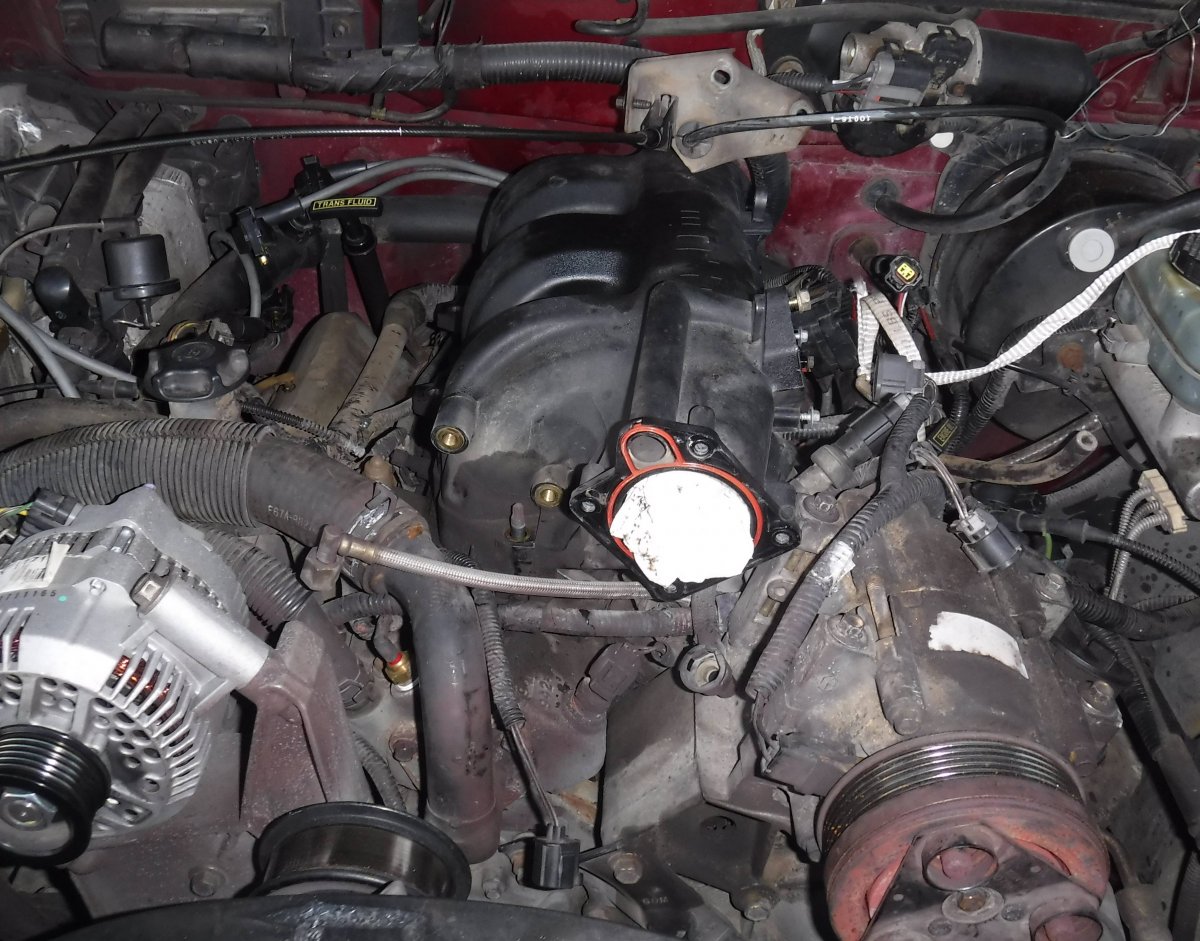

Getting it loose from that EGR riser was no piece of cake but It finally came on out and I got the upper intake cleaned up a bit and ready to go back

That motor sure has a lot of grime around on it, funny that bottom is clean as can be. The EGR riser is also almost tar like, but I cannot see any smoke coming out anywhere? That curl at the top is also part of the reason it's so hard to get off and on
34661
It gets stuck unless it comes straight up, and with that forward curve and the placement of the engine so close to the firewall, and the more than 2 inch bolts sticking up that it must clear to be rotated forward it takes some doing to get it out of there. It will get stuck and there is no way to proceed unless you go back and get it straight somehow, both coming out and going back in, it gets stuck and will not go in

Thankfully I got the hardest part together before dark and was left with just the throttle cables, wiring connections and emissions stuff to reconnect, and refill the radiator( had to run a drop light for that, and the temps rapidly fell as I worked on it).
Got it all put back together and reconnected the battery, must have been near 10 last night. Just turned the key on to let the pump run about 3 times to recharge the fuel pressure, and then it started right up, even sounded a good bit better but I haven't got around yet to check for any further vacuum leaks.
Then took it for a 60 mile drive, basically a trip to Wmart and get gas. I'll try and summarize where's landed in a later post

Yeah that bend in the EGR tube was a pain when I did my upper gaskets. Sort of have to pull and rotate to get it off...
Geez that sounds sort of dirty.
It's gummed up pretty bad in some places, even the throttle body back side has that much on it. Had a small can of TB cleaner but it was already half gone and didn't go far in getting it cleaned

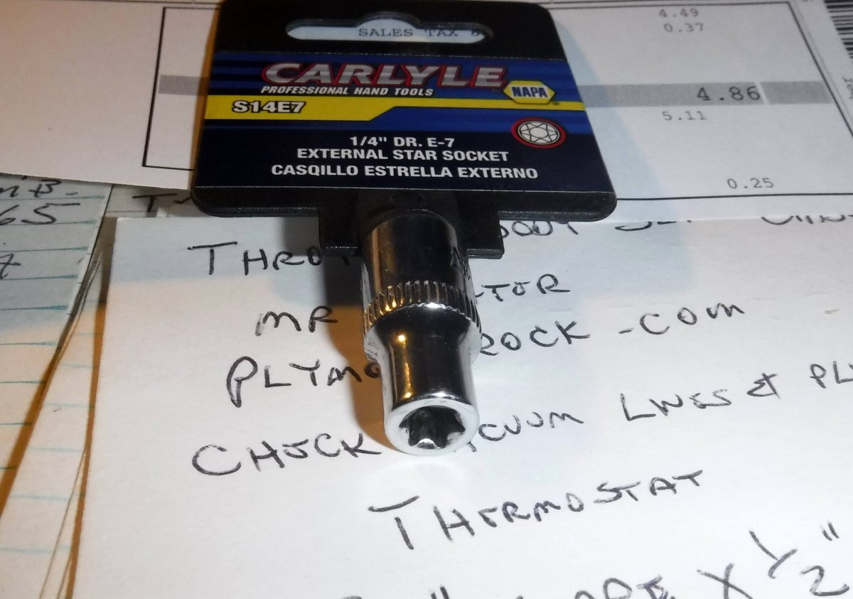

Getting a couple of more days of decent weather, after realizing today was looking fairly nice I caught the mid-day news and weather and they promised 2 more, so I took off to Texas side to see about finding a reverse TORX socket.
Checked at ABC, AZ, O'really's, and an old hardware store uptown where I also had to get a regulator and some hose. All I found at any of them was the set so decided I'd head back home the other direction and checked a pawn shop and then NAPA.
This is the little jewel that kept me from getting any closer to replacing all the intake manifold gaskets last time, an E7, almost 5bucks but NAPA came right up with it. I've live my whole life without needing one of these, so didn't figure I'd jump on a whole set right now. It's a 1/4" drive, hope that'll be meaty enough to break them loose

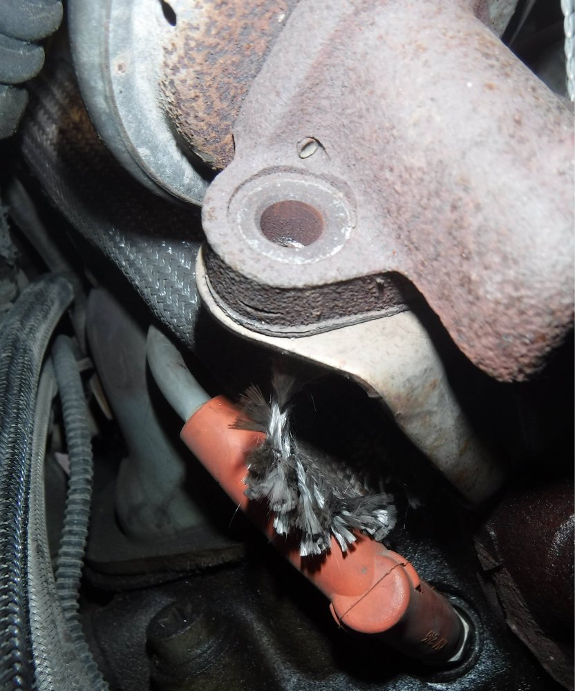

I was having a problem getting the oil dipstick tube out before (even had a strap around it's attachment arm and a 4ft pipe propped on the brake booster, pulling that with my left, and wriggling it around with my right and it didn't want to budge.
Any suggestions most appreciated!
Should I re-torque the head bolts while I'm in there?
I wouldn't touch the headbolts. That's strange with the dipstick tube. I thought it would just pop out with an O ring in there. There isn't a hidden attachment somewhere?
I would think the 1/4 E7 should be fine. They probably aren't that tight but go easy.
