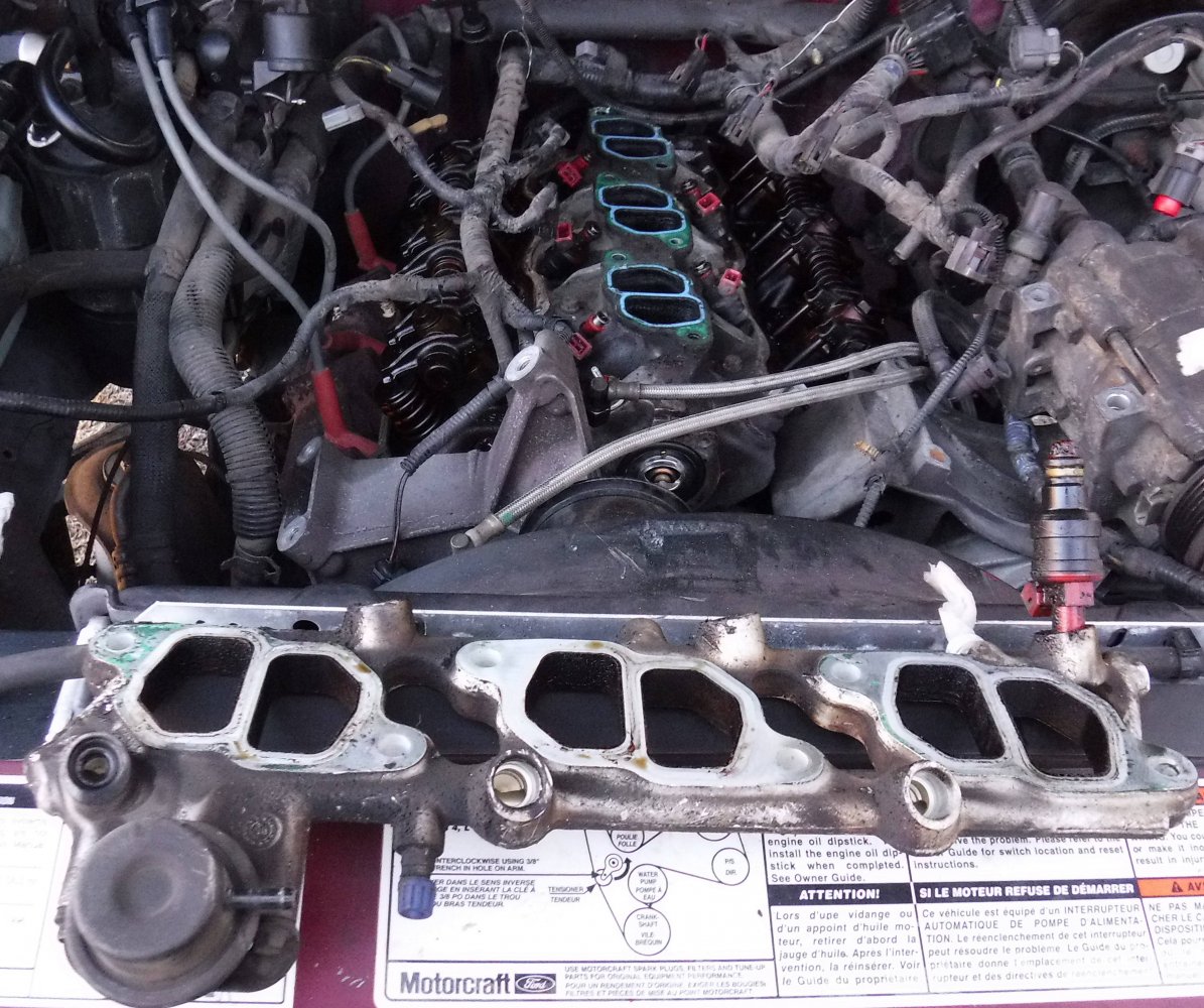

Well I tore it down again today, at least to the lower intake manifold, all I need do to remove it is to pull the 8 bolts that are holding it in place.

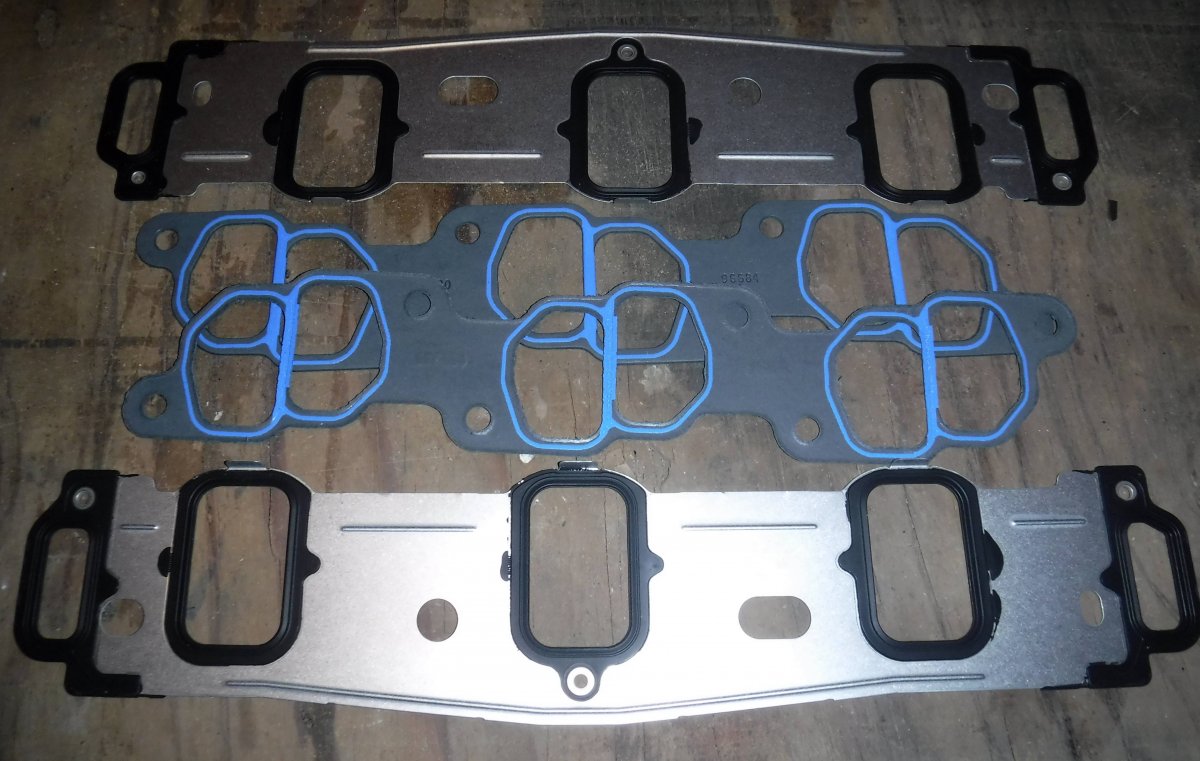

I'm wondering though if I've done it for nothing because the lower intake manifold gaskets I've been seeing around are different than the ones I have.
The ones I have are two separate gaskets that would go on each side but not across the bottom as the others I've seen do, and I could mess up by pulling that intake before knowing for sure if the gaskets I have will even work.
I'm having to think no, because I see no way anything in my set would seal across the bottom
These are the ones I have

I just don't see any way I can use the ones I currently have
I think they will both work but the new design is a one piece. Seems like the one piece would be much easier anyway. I'd say you'll have to remove the lower intake to see how the current one mounts. May be a support under the manifold between the two sides that needs to be reused and sealed with RTV. I never got that deep into mine.
Personally I'd get the one piece.
Here's another writeup I found a while back. Can't even remember where I got it but they used the one piece too. Read the comments, there are some interesting ones in there.
I have seen where the intake gasket is a 4 piece total gasket. The two, like you have and 2 rubber slide on style pieces. This style you needed to put a small dab of RTV in the corners to seal it. Now I have never torn down your motor but wanted to let you know this is a style out there and because of this makes me wonder 2 things. First is your kit missing parts? And second if not then are you supposed to use RTV across the back and front as a gasket.
Wish I could be more help but the RTV across would seem to be the proper option here. Did they give you a tube of RTV? If so I would likely think this is the way it is done.
Thanks a lot fellas(97RangerXLT also got back to me on his thread), at least I now know it's their design, however good or bad it may be. I've really gotten stuck here between a rock and a hard place, it's either put it back together(as is) and try finding a one piece gasket, or use these and see how long they last, I'm opting for the latter ;)

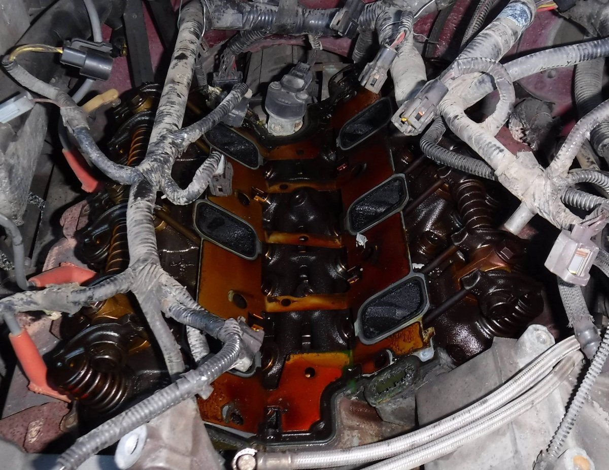

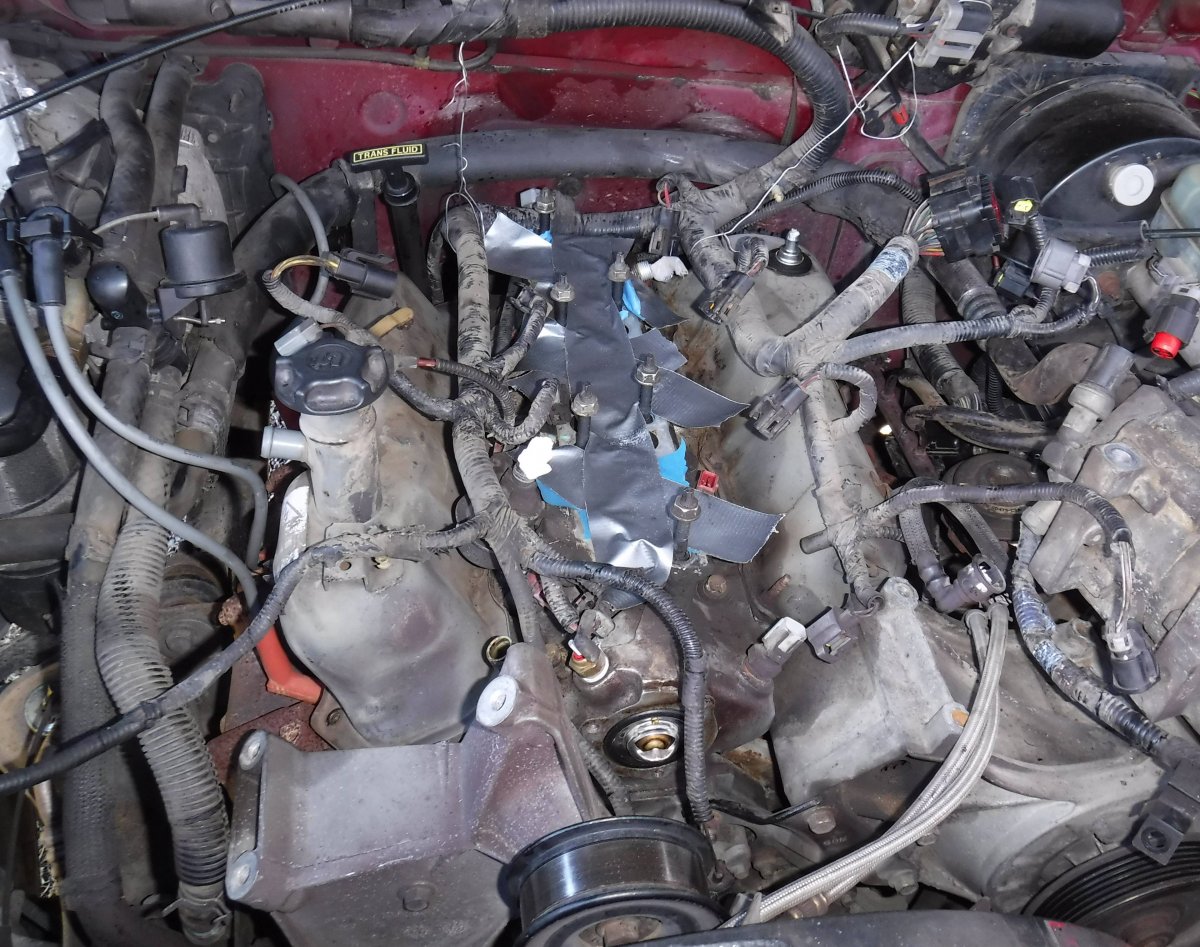

After a rain day and a needed day off I got back into it today. Almost had it ready to dismantle, so finished that, tied the wires up where possible, and gave it a good swoosh of 150psi to hopefully dislodge any loose debris.
Here I've got it ready to take apart
34943
The Fuel Injection Supply Manifold was a real rascal to wrestle loose so I suppose it's never been touched
34944

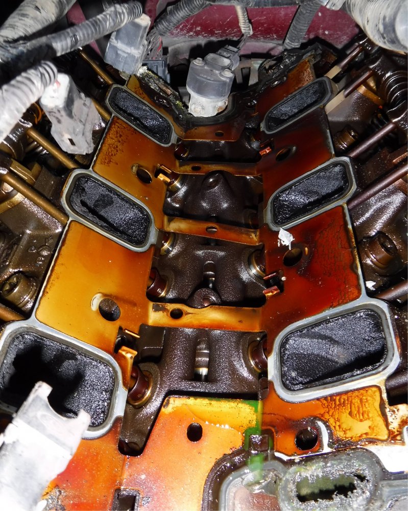

Pulled the Valve Covers and Lower Intake, looks like an overly smoked duck in there
34945
34946
Not sure what to do with those coolant ports but after getting it back together I'll give it a good Seafoam treatment in the tank and(after acquiring the spray) in the intake.
Not sure how to clean those gasket surfaces, they're all aluminum and the last intakes I pulled were all cast iron
I don't think a sharp chisel would be the thing to use on aluminum :/

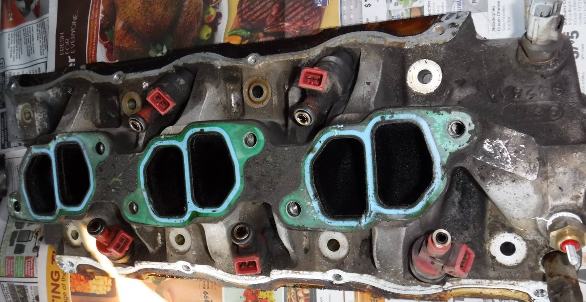

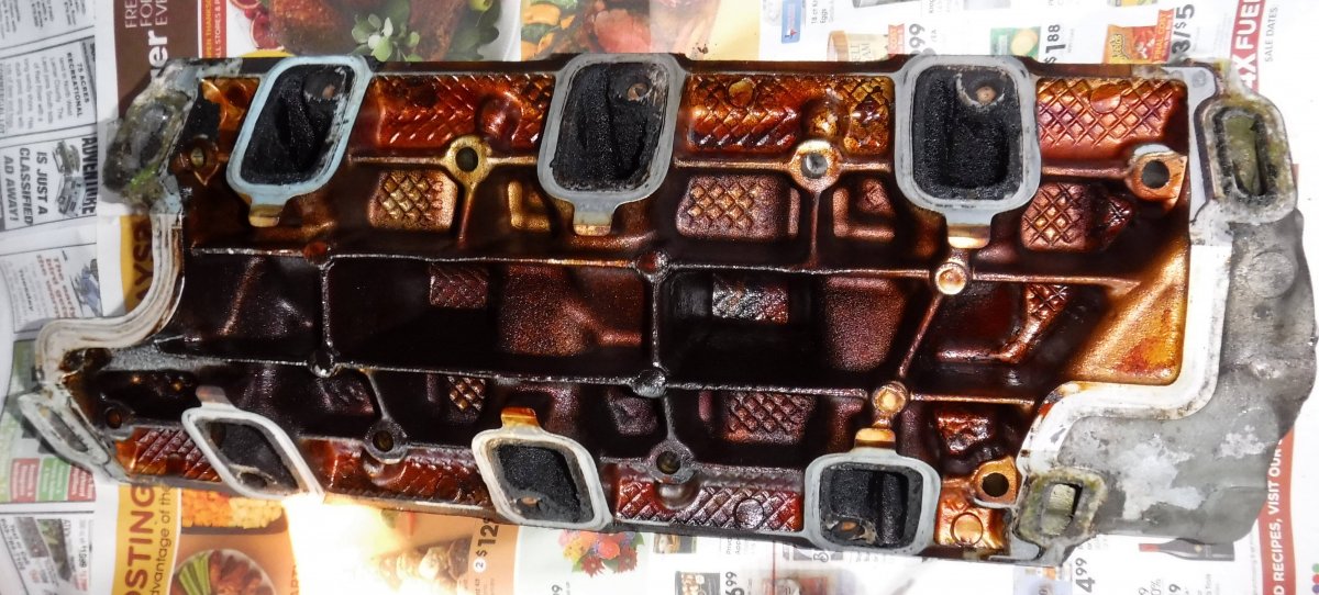

This is the lower intake after getting it off the motor
34947
34948
Geez that thing looks pretty neglected. You can get plastic scrapers to clean the gasket surfaces. I guess some people may try some sort of scrubbing pad but the actual gasket mating surfaces don't look that bad. Might be worth a coolant system flush after you get it back together. The seafoam treatment might be a good idea but that's some serious crud in those ports. Might need a couple treatments to do much of anything.
