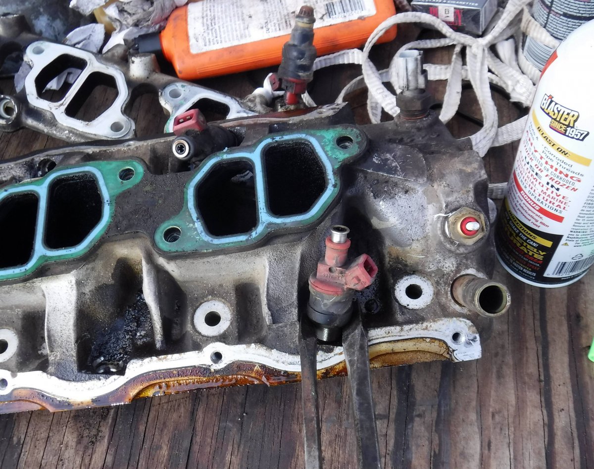

The fuel injectors were real rascals to get out, wound up using two large screwdrivers to pry and twist them out

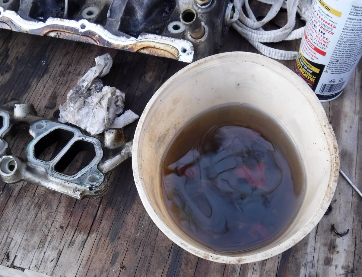

Wanted to give the injectors a good soak so I made a creative little parts washer using an old butter bowl and some gas, thinking about a pump and some lights, patents and stuff

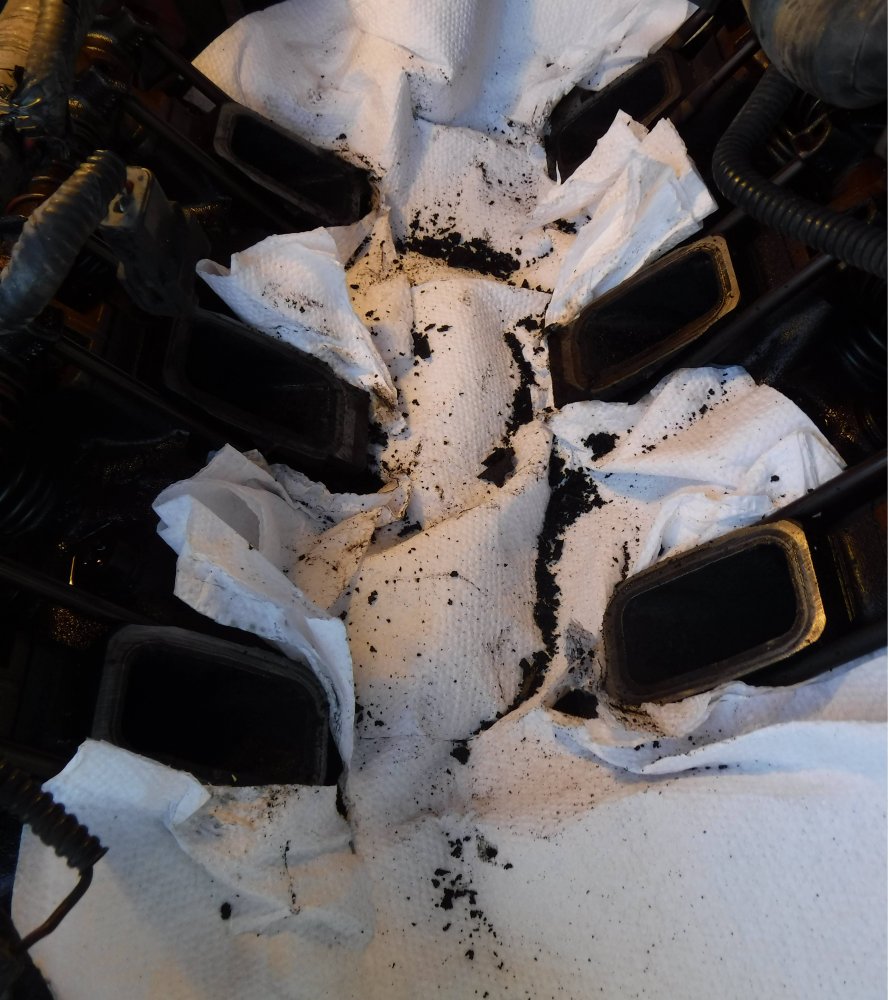

Let those soak for a few hours while attempting to remove some of the carbon build-up from the intakes, and clean off the gasket mating surfaces on everything, that's what took most of the day

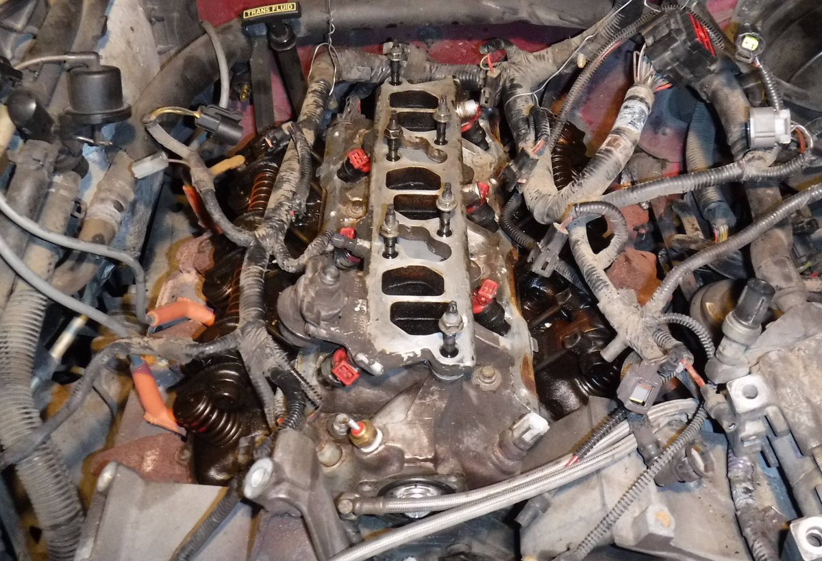

Managed to replace the lower intake and fuel rail before calling it a day. Hoping the remaining re-assembly won't bring any surprises, really wanting to get out tomorrow

Spent today trying to wrap it up, stayed fairly busy much longer than had anticipated.
It went fairly well apart from the usual frustrations with working on a vehicle.
Had been hoping for early afternoon, worked till well after dark
Had to back up and reroute wires and hoses and such a half dozen times or more, but thankfully didn't require removing any major components to correct.
And when I got done only had one wire left over! :D It was a single wire, type that's pushed onto a stud like connection.

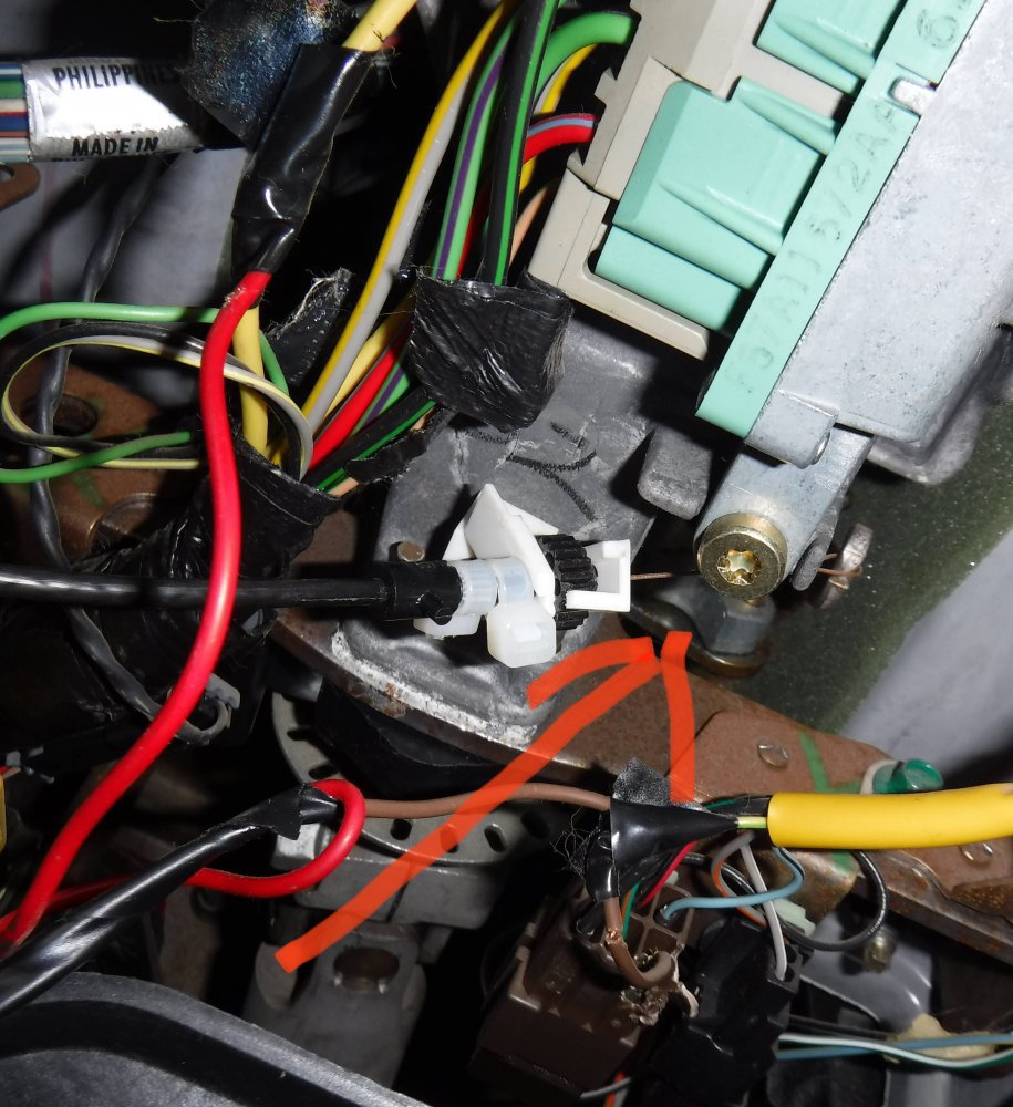

This was late last week and I thought I was still far from the shift cable, didn't realize I was looking right at it :/ but I did pay special attention to the "creative" wiring someone did on it. Appears to be where they tied in an amp or sound system, the wires in that black box appear to be mostly speaker wires. All the good I can see they did was at least they didn't blow the door speakers :/

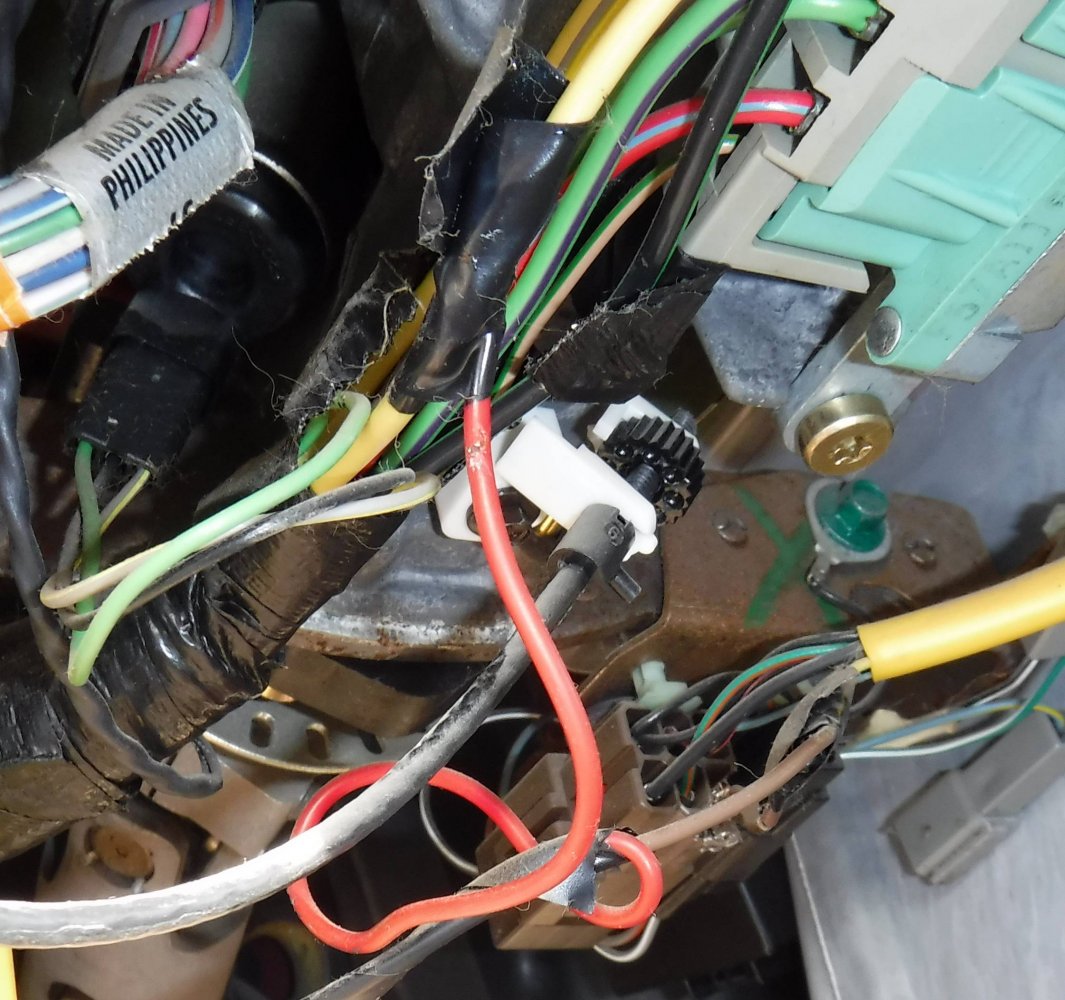

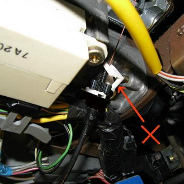

And here's where I was right at the shift cable adjuster and didn't know it, adHd is a wonderful thing ;)

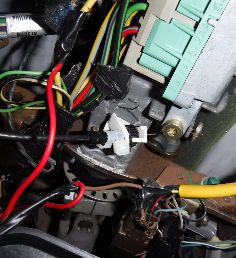

Today I got in again to adjust it but it wouldn't turn, I probly broke it somehow trying :/ but found a fix by searching the tech section
and here's my repaired cable adjuster ;)
Along w/ more of their "creative" wiring :/

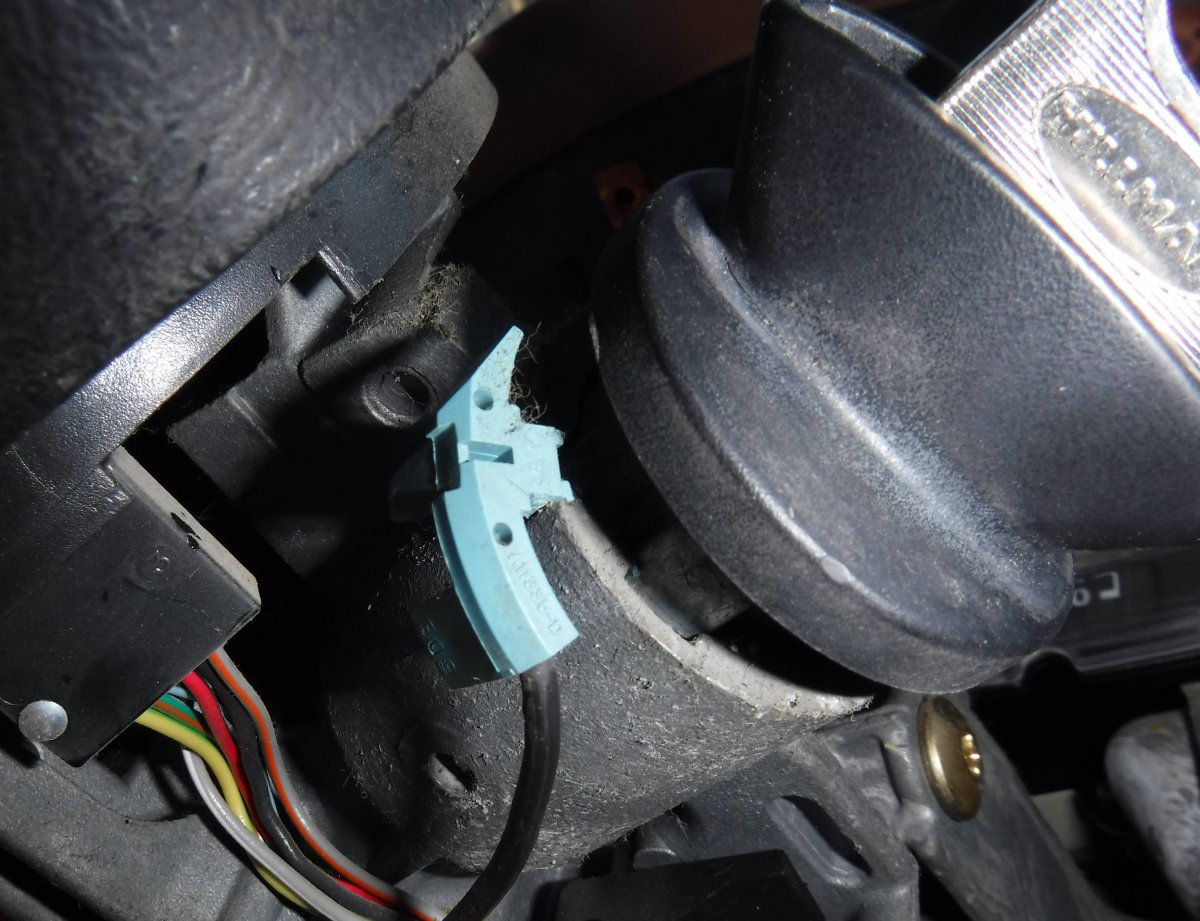

And something else I probly broke :(
Think it's a grounding thing for the ignition switch

In the first pic... That looks like an aftermarket alarm, not part of a sound system.
Second pic... That’s the shift indicator adjuster. All that does is move the PRNDL indicator. It has no effect on the actual shifting of the trans.
Dig a little deeper and make sure all the bolts are there and tight on the shift tube.

Fu(k that black wire at the ign tumbler... that’s just for the “you left the key in the ign” chime.
