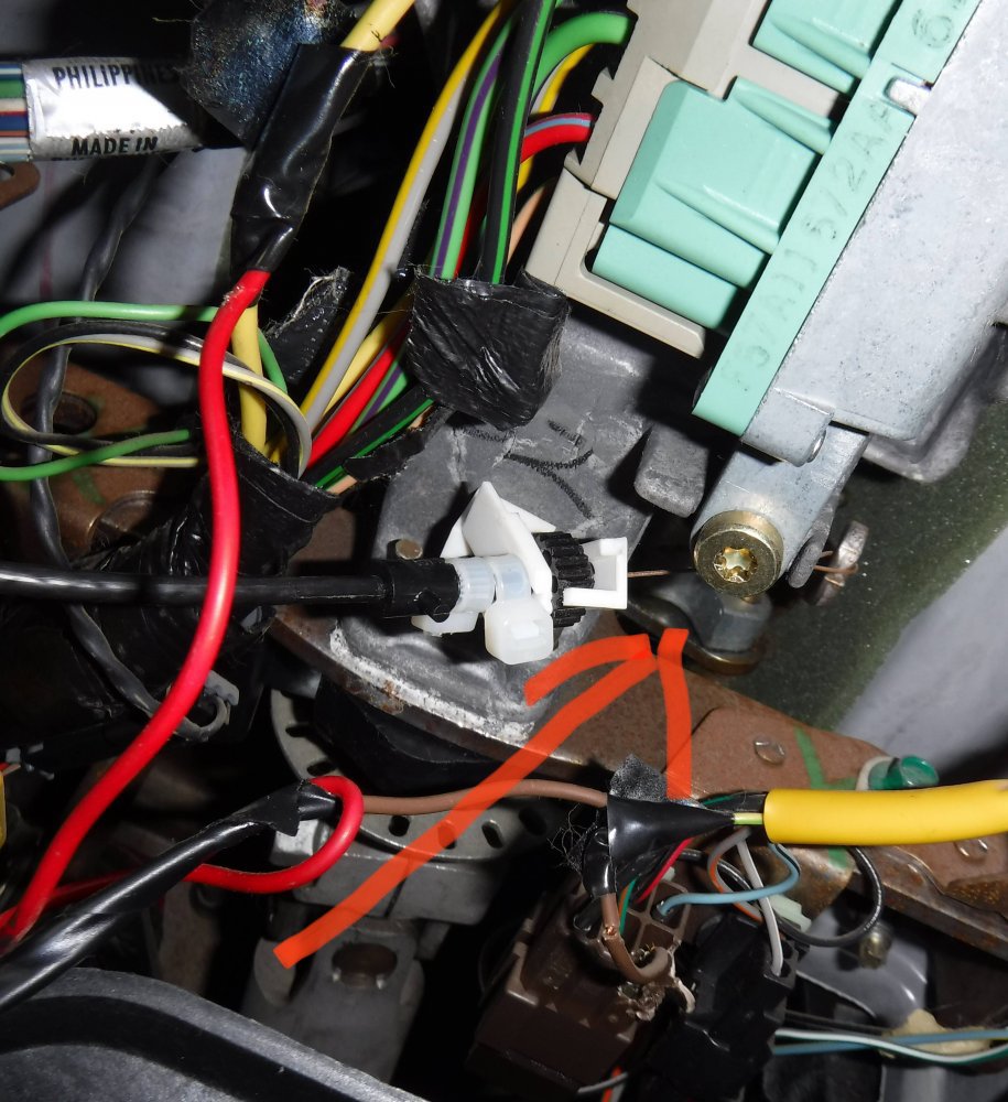

In the first pic... That looks like an aftermarket alarm, not part of a sound system.
Second pic... That’s the shift indicator adjuster. All that does is move the PRNDL indicator. It has no effect on the actual shifting of the trans.
Dig a little deeper and make sure all the bolts are there and tight on the shift tube.
Fu(k that black wire at the ign tumbler... that’s just for the “you left the key in the ign” chime.

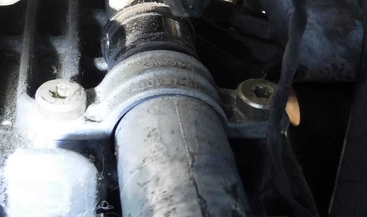

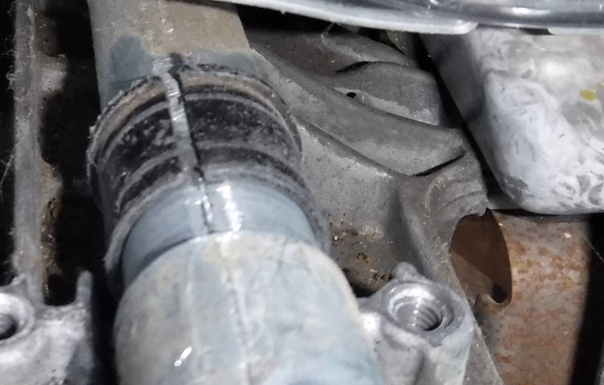

So today I tore into the shifter and transmission cable adjustments. As Dirtman had emphasized I checked the bolts on the shifter tube, tightened them up just a bit, and noticed a bushing out of place on the lever shaft
35451
Dammm this thing is a mess down in there :/ I backed off the screws and pushed the bushing back into place, tightened it down and went onward with adjustment attempts. After a bit of messing around with it I noticed the bushing had already begun slipping back out again
35452

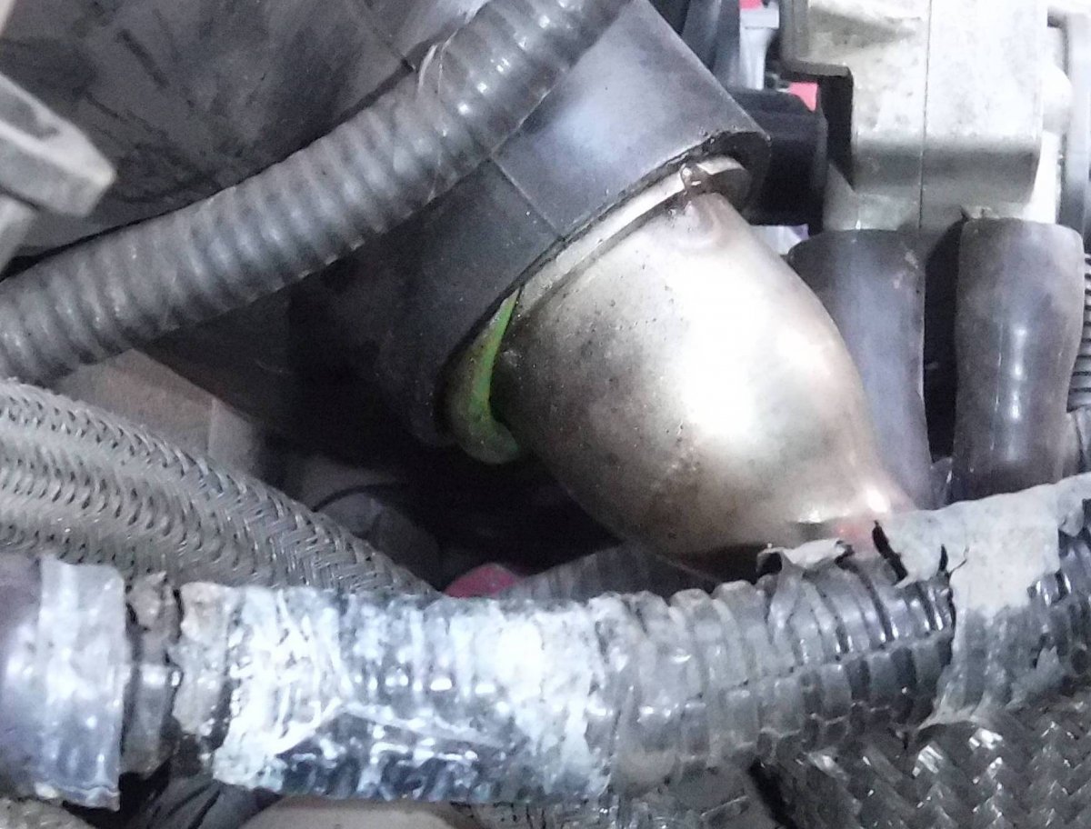

I began tinkering with a zip tie, several still laying there from yesterdays tightening up the cable, hoping that would help hold it in place, but then noticed that flange around the bushing and realized they must have the thing in there upside down. I began working on getting the shaft free enough to slip it off the end and flip it. After working with it a while it occurred to me it could have a slit of some kind and spun it over. Sure enough!
35453

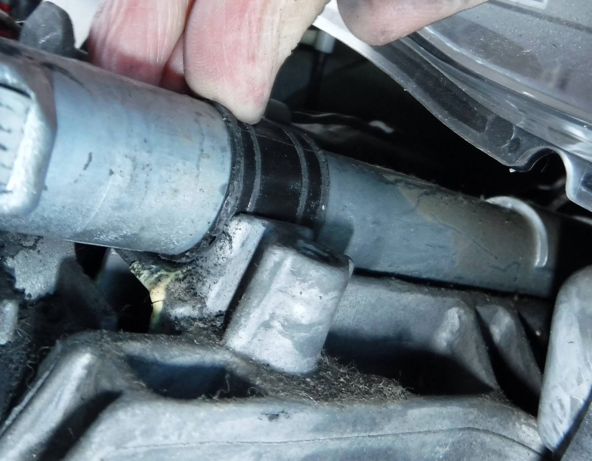

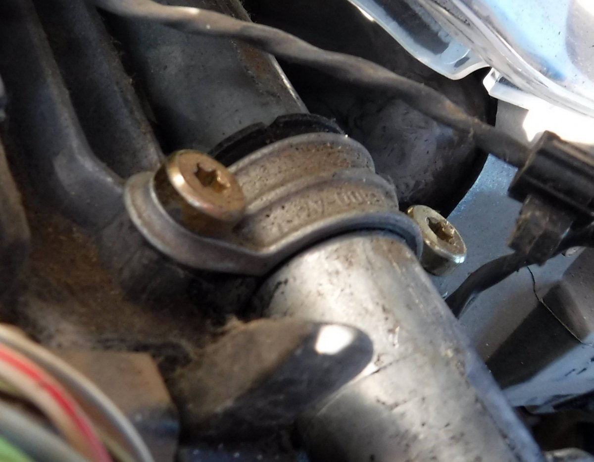

Flipped it right over and it all began to fit in place
35454
Put the hold down strap back and now I think it'll stay there! :)

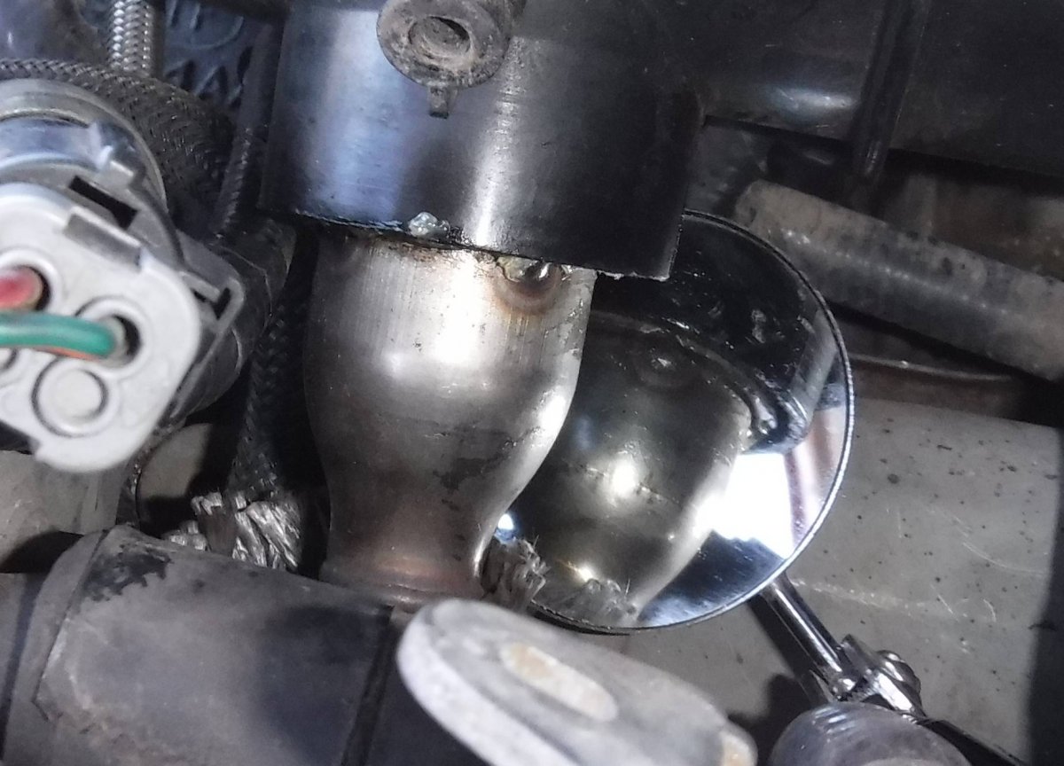

While replacing the intake manifold gaskets the oil pressure gauge wire wound up on the wrong side of the engine. I finally found where it belongs(below the power steering pump) and while re-routing it back around, with the breather tube and AC both moved out of the way, I got a look at one reason for the vacuum leak. Couldn't see this with everything else in place
37840

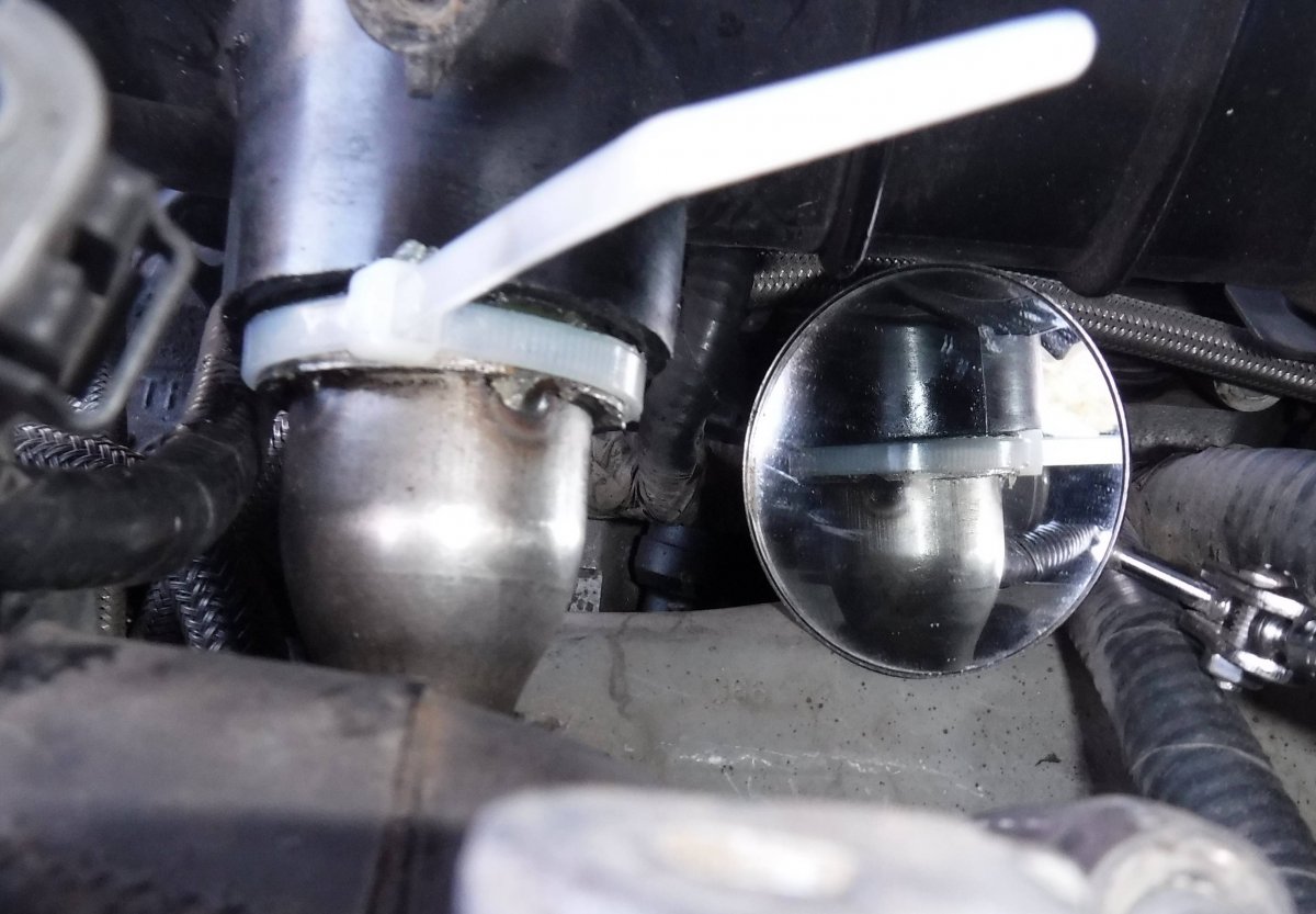

I pulled the upper intake back off and straightened it up but it still didn't want to stay in place. Wish I'd had another O-ring but
didn't get chance to order one beforehand. I pulled it into place with a zip-tie holding it and torqued it all back down
37843
37844
Looks ok but still wish I'd gotten a new one. It also is running a lot smoother now. I took it up to the corner(little over 1/4mile) and back, but haven't taken it out on the highway yet, looking forward to know how well it'll be doing.
