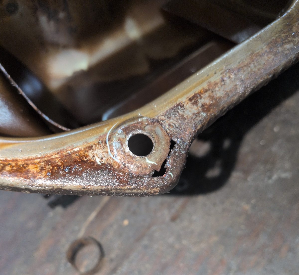

No dice. Looks like it leaks substantially less, but still enough to smoke. Figure it's just gonna bend wherever the new weak link is between weld and old tin, and not give me enough clamping force.
Not sure what consumption is, but you can smell the smoke in the cab when you're not moving, and 90% of this truck's purpose is to tow my boat in the summer, which is basically guaranteed bumper-to-bumper traffic.
I guess I can try to cut a spreader ring that hooks all the way around that corner to the next 2 bolt holes, or rebuild the entire flange like rhekman did. I have zero experience on the plasma cutter, though.

After thought, but it looks like the place where it seals against the head is nice and smooth. Would it be possible, after cleaning, to build it up the top side with JB weld, sand that flat and fabricate long skinny washer so you don’t crack the JB weld when you snug it down?
I’ve never done it, but once in a blue moon, I do something a little “shade tree”……
I'm honestly not sure exactly where it's still leaking from. I only saw a little bubble right below the bolt, so I yanked the bolt and reset it in rtv. It's gonna take another drive to burn off all the residual oil that was already on the exhaust, so I can get a better idea.

FYI, my 94 Aerostar engine had spreaders on the valve cover bolts. I noticed after I swapped engine that the 94 Ranger engine should have. Without them the bolts bottom in the head at roughly the same time as they get snug. Mine loosened up about every other oil change. I should've just made it a habit to tighten them when I did oil changes.

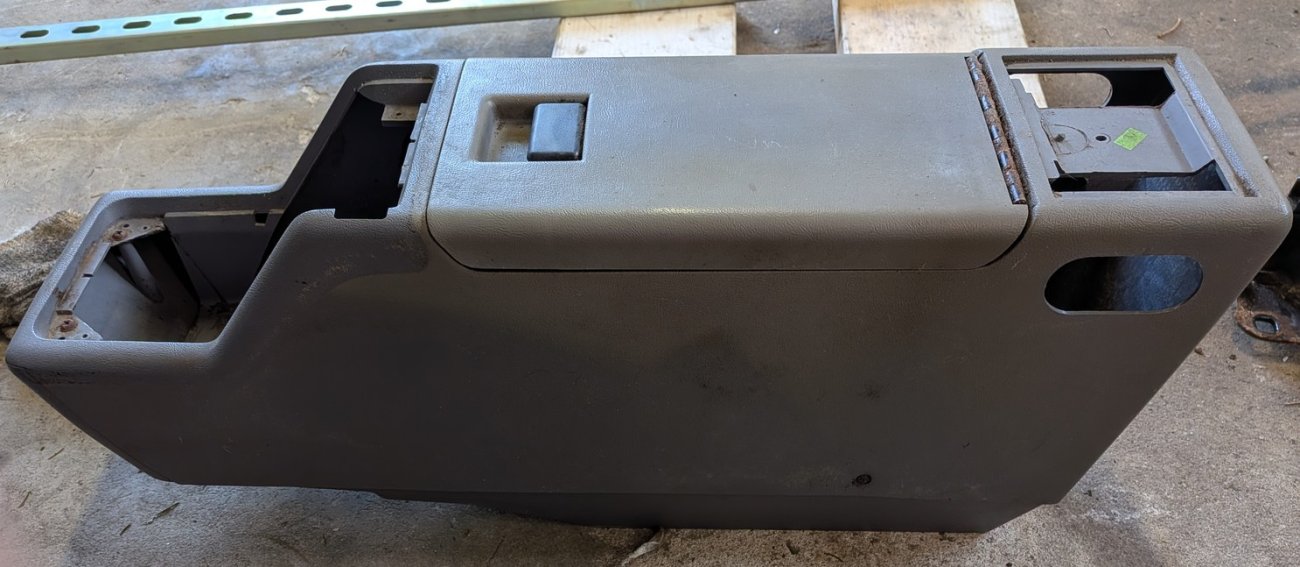

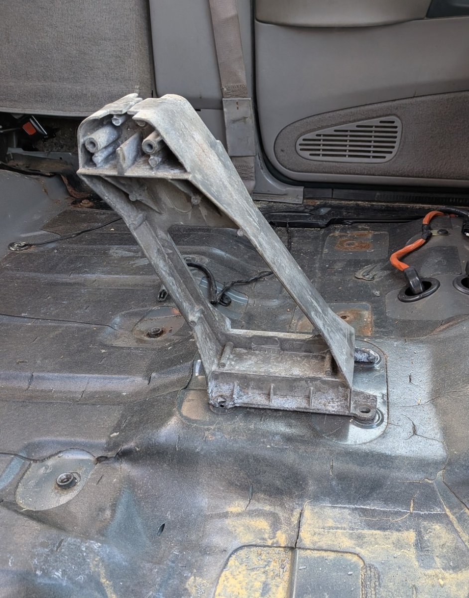

Can anyone describe, or better yet share a pic, of how the bolts work below the center console bracket in an extended cab with factory buckets?
I have a junkyard console, but when I drill through the divots in my truck where it's supposed to mount, the front holes are almost directly on the vertical part of a structural rib, so I can't just run a bolt through without carving out more of the rib, or tacking in a stud or something.
