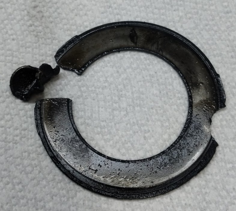

Did LSD clutches and rear diff fluid, which was almost my last "minor new owner project".
Left-most friction:
'95 Supercab Rehab - Dumb Questions Thread
Dunno how that happens, dunno where the other ear ended up. I couldn't find it in the diff, and I couldn't find it in the oil pan with the big piece.

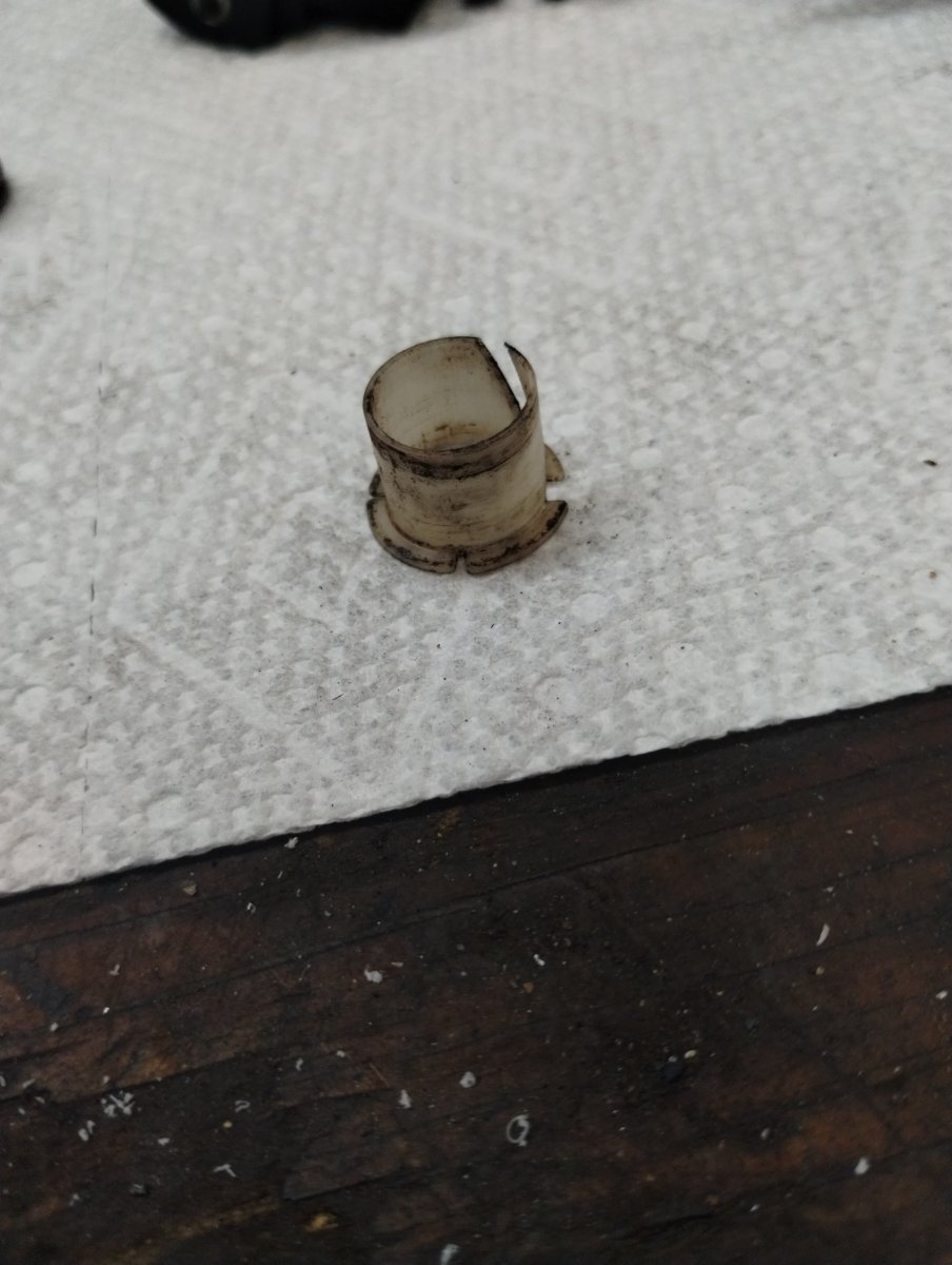

Does anybody have an ID/source for the brake/clutch pedal shaft bushings? I had rolled the dice on Dorman 74016, all of which are way too big.
I see a couple likely candidates, but preferably somewhere that sells them in real life. Although if I can't find my spare brake booster, this is probably going to become a multi-day project regardless.

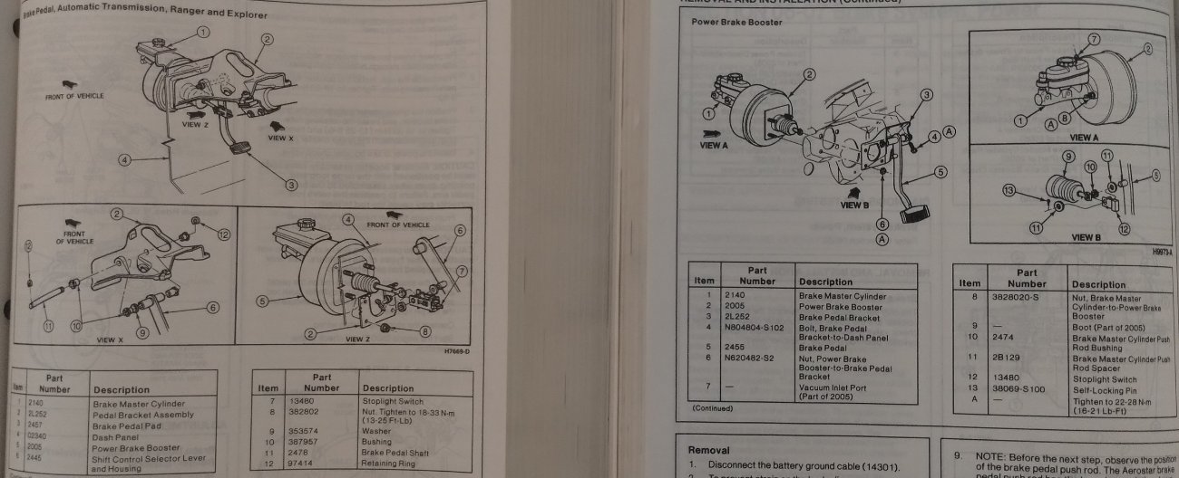

EDIT: '94 manual says 387957, which crosses to D8TZ-2471-A, which is '94-down, and the shoulder is bigger. Fordpartsgiant doesn't return anything for "similar parts that fit '95". I don't have the '95 body manual. No aftermarket crosses anyway.
EDIT 2: I decided I would get the rest of the '95 manuals when I needed something that was notably different from '94. Happened pretty soon. Unfortunately, the information I was looking for isn't in here:
'95 no longer breaks the components out of the pedal bracket assembly, so I guess from Ford's perspective you buy a new assembly and that's it. Obviously that's less than helpful.
Amazon has new Chinese pedal assemblies marked '95-'06 under the '06 part number 6L5Z-2455-BB for $45, $30 on sale. The Dorman bushing set was $10-$15, so it's possible the knockoff pedals are the move here.
I cut the black bushings from the Dorman set (medium ID, but thinnest material) down to the first slit in the shoulder to replace my inside two that were trashed, reused the outside two, slathered everything in white lithium grease, and sent it.

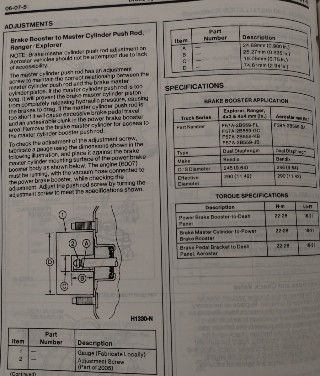

Brakes are working but take increased pedal effort after replacing pretty much everything: cruise master, booster, pads, driver's caliper, and everything in the rear. New booster is confirmed doing something (pedal softens a bit when I start the truck). No improvement after re-bleeding.
What's the culprit here? I bought the most bullshit discount master, but they all have the same bore regardless of 9"/10"/discs in the rear, right?
I believe there's an adjustment on the rod on the booster that goes into the master cylinder, it's been so long since I've dealt with it that I don't remember how to do it though...
I’ve had to fiddle with that rod on the town cars. Moving it just a hair can make a big difference, start small and work up. On the town cars, I can pull the master cylinder back far enough that I can adjust it without disconnecting the lines. If you make it a hair too long, the brakes will drag.
For what it’s worth
Thanks guys. Damn, I brought the old booster with me and traded it in directly for the reman, so I couldn't even match the rods. There seems to be a static spec of 0.98" for the length, so it's frustrating it would be wrong out-of-the-box:

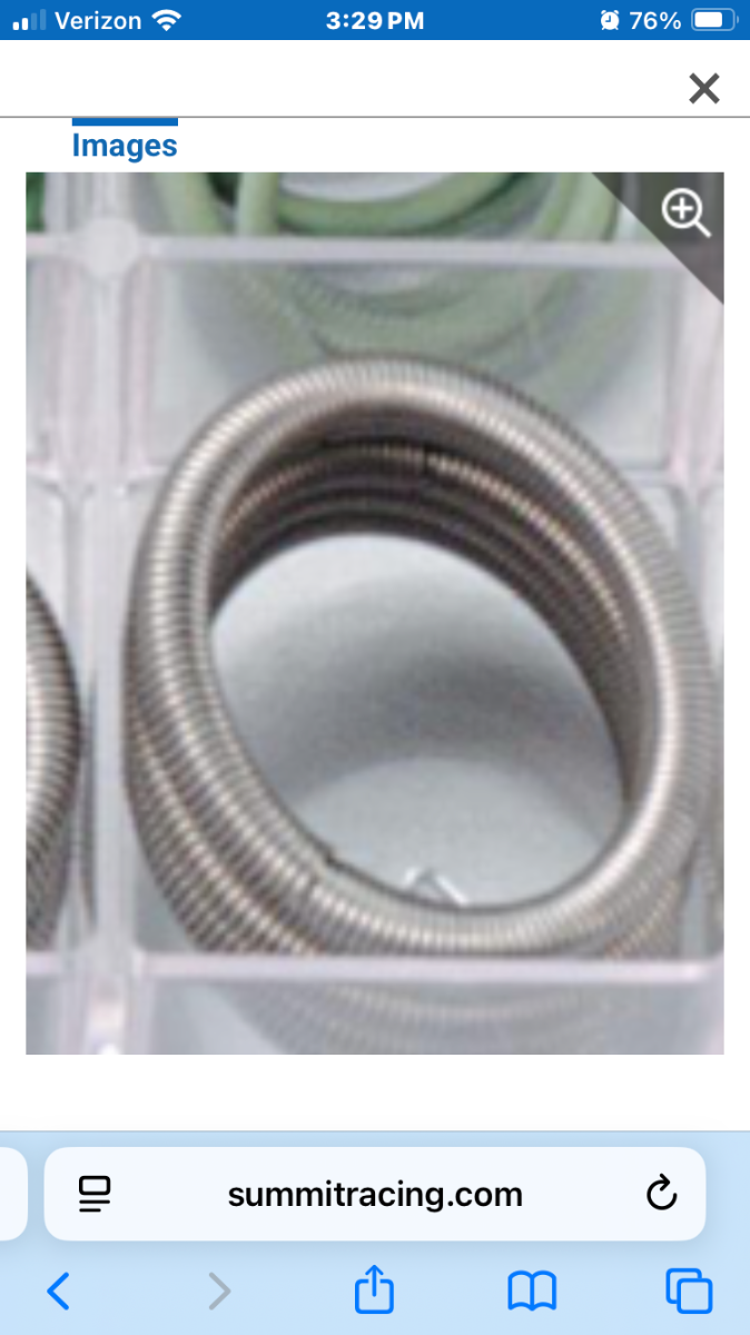

Understand what it is you’re trying to do. In the old days, there was an O-ring and a hard plastic/rubber connector piece that was about the same size as the O-ring, but it had a couple of edges to hold it in place. The O-ring made the seal between the inner tube and outer tube, and that slightly bigger different shaped piece locked the tubes slinky into the kind of double crimped end (think brake line), which kept the two pipes from sliding in and out of each other.
Most of what I’ve seen for the last 30 years, you still have the little green O-ring, but then the other connector part looks like a metal O-ring, but it’s actually a spring that looks like a teeny tiny slinky, connected in a loop.
This was the best picture I could find, but if you look in the lower left of the loop, you can see the coils of the spring.
When you’re sliding the little tool down in the fitting, you are trying to expand that spring ring a whopping 32nd or 64th of an inch to let the O-ring part slide out underneath it. On both the fuel systems and on the AC systems, and in industry we had them on some other things, the whole thing seizes up after a few years. So when you put the tool on there, regardless of the style, you almost have to tap it down gently to get that rubber ring or that spring ring to expand enough, so the O-ring can slide out underneath it.
