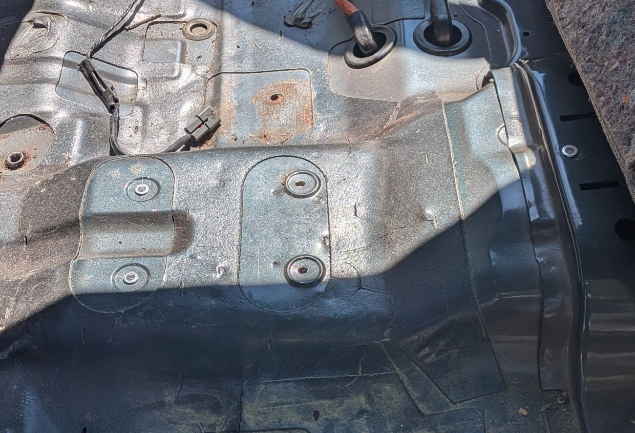

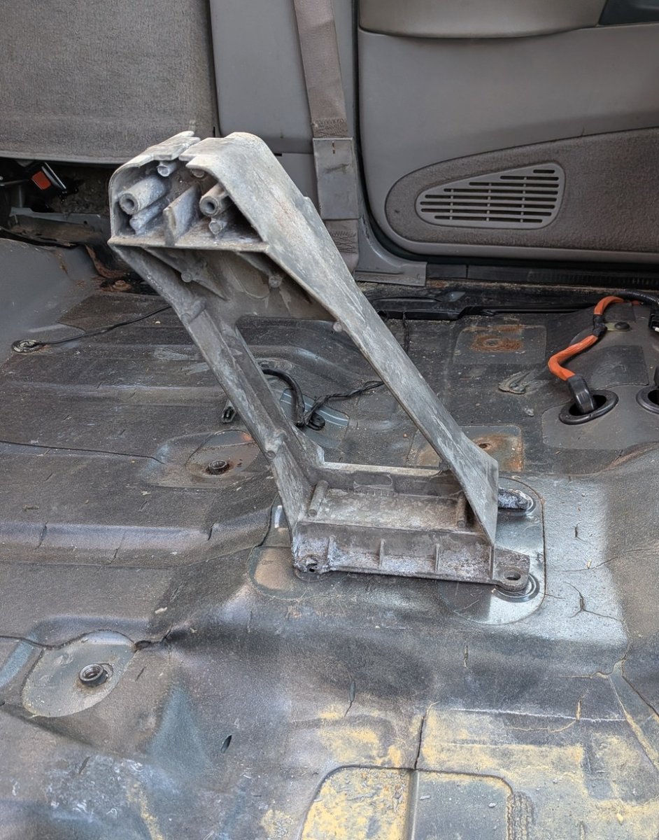

I don't know if originally the bolts go through at all. Might just be studs coming out of the floor. It looks like the front anchor wants to be a nutsert or a nut tacked to the bottom of a little rib inside the cab.
Let me just suggest you don’t have to use a half dozen half inch nuts and bolts to hold that down, and they don’t have to be in the corners, nor do they have to be run down the center. I bet you can hold that in place adequately with three or four decent size self drilling, and self tapping screws. After you punch them through, pull them out, put a little E6000/goop on them so they don’t vibrate loose, and snug it down. If you’re not playing Hoochie Coochie on top of it with your girlfriend, it’ll stay there forever.
If you have to run the screws through carpet, usually a utility knife and cut a tiny little cross for the screw to go through so you don’t snag a thread and put a run in the carpet.
I'm with @Rick W. 4 self-tapping screws, and maybe some washers. If you really wanna look professional, riv-nuts. You can shift it some to suit you better too. I never put mine in because of locating it. With the side by side cup holder far enough back to fit 2 RT44 cups and not be in the way of the shifter, it stuck too far into the back seat area for me.
Riv nuts might be the way to go there and would be easier than most other methods like nuts on the bottom... I think the whole rivnut kit from Harbor Freight is around $20...
Drilled & set 1/4" rivnuts in the two rearmost and one forward holes. Front armrest bracket holes are gonna stay long bolts and washers, I guess.

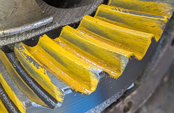

This came up when I originally built this diff, but is it normal in y'all's experience for the D35 TTB to want 0 to less-than-zero pinion depth shims?
Pinion's already got that enormous inner slinger, which is .035, and the race starts with the baffle which is .020, so even with "no shims" you've actually got .055.
When I installed the 4.56s, pattern was ever so slightly deep with zero shims. I didn't really see any other option, so I figured it's part-time 4x4 and ran it.
Setting up 4.11s now, pinion with zero shims is even deeper. Adding a .005 pinion shim literally results in carrier-to-pinion contact. I think it's too deep to say **** it, but it's also obviously not a good idea to ditch the oil control components. Shave down the ass on the race?
I can't see how that could be normal. Bad case?
Dunno. Got it from the junkyard. Ran the 4.56 for however many years and it never did anything weird.
Honestly, I'm probably just gonna run this one too. There is the option to buy a D30 slinger, which is .030 thick, 1/8" smaller OD, nominally smaller ID, and open up the ID slightly.
But, when I set up with .015 shims instead of the .020 baffle, the pattern hits the top of the tooth. Dunno how we ended up where .005 less shim is obviously shallow and .005 more shim is contact, but either that's life, or I'm dumb.

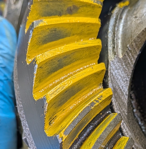

Here's where we're at with 0 shim (besides the slinger/baffle):
Real bearings (not setup) moved the convex side towards toe like that. Backlash is .008 and concave is towards heel, so it's not like it wants backlash.

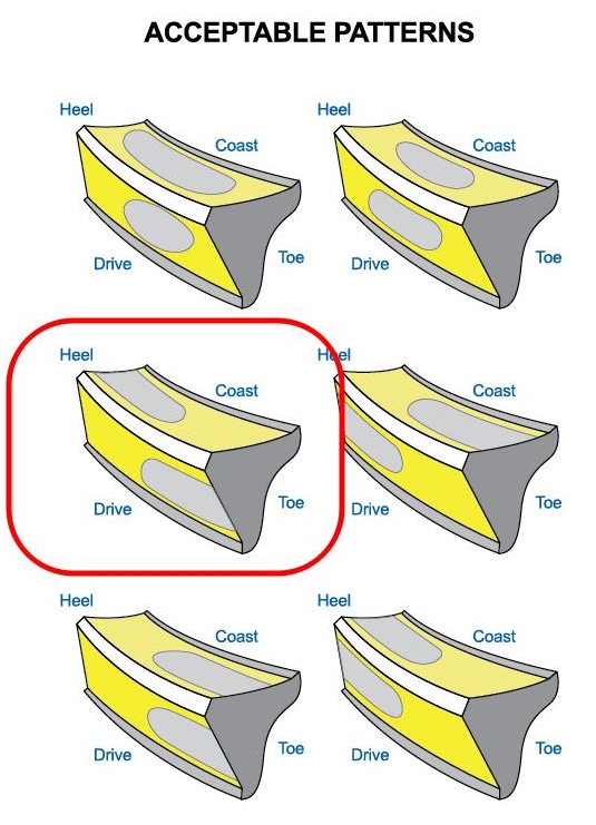

I'm hoping what we're looking at is close enough to this to survive:
But as always, input is more than welcome.
