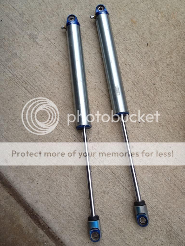

Freshly rebuilt Foxs for the rear. Getting ready for Silver Lake in two weeks.

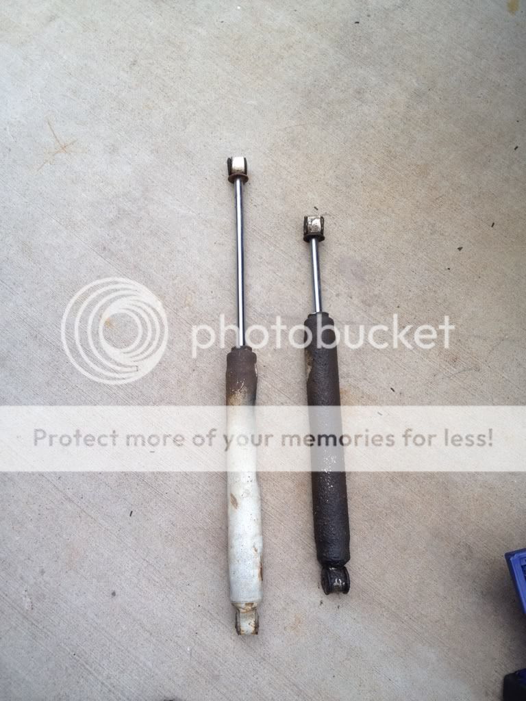

The temporary rear shocks didn't fair so well...the bent one won't compress past the last 5" of travel hahah
