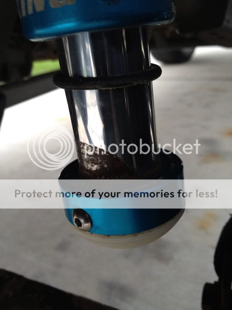

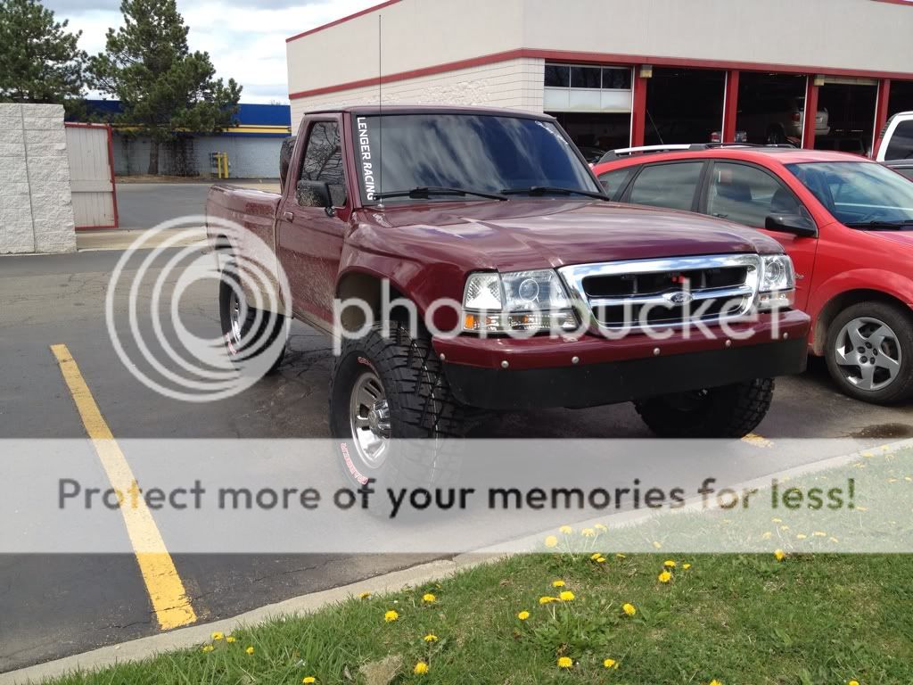

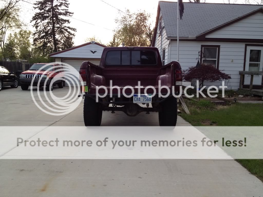

My guess is the frame cracked on compression, not droop. Way more force pushing the axle up than down.
I would agree it broke on compression but it definitely bent downwards from fully extending. I have a good idea of when and where it happened too. The dunes were real steep and I went off about a 15 foot near vertical drop in 3rd because I forgot it was there. It bottomed hard front and rear.
