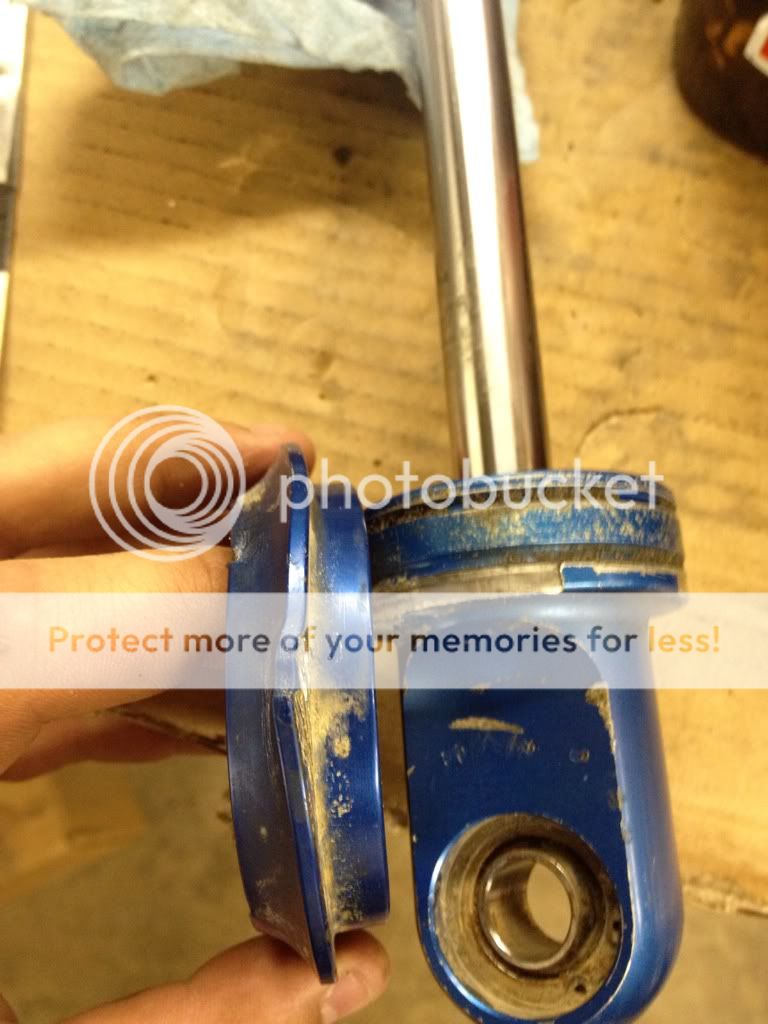

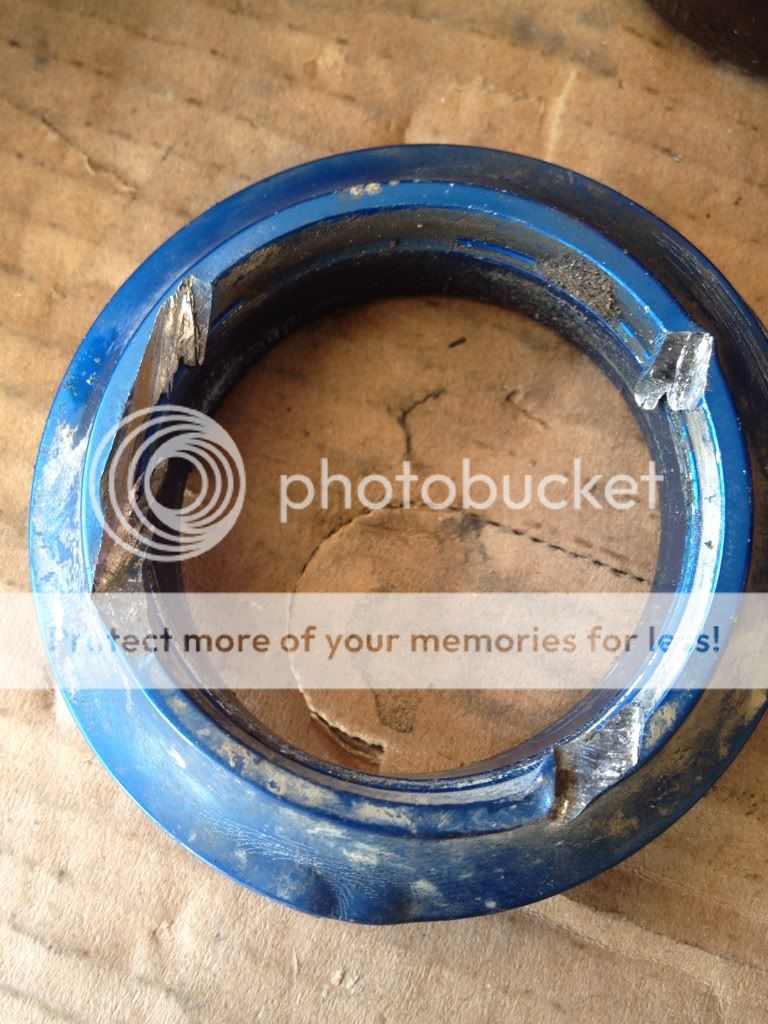

Here was the cause.

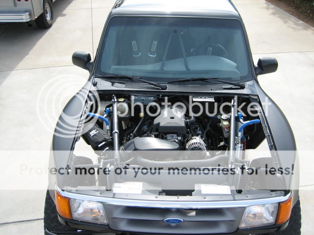

Any info or build thread on this truck? I'd be interested in seeing all the underhood clearances with the taller truck style intake and alternator. I appears to fit and I was worried I would have to buy an LS2 intake and accessories. I have a deposit on my Jeep and as soon as that things leaves my driveway I'm ordering my engine and trans.

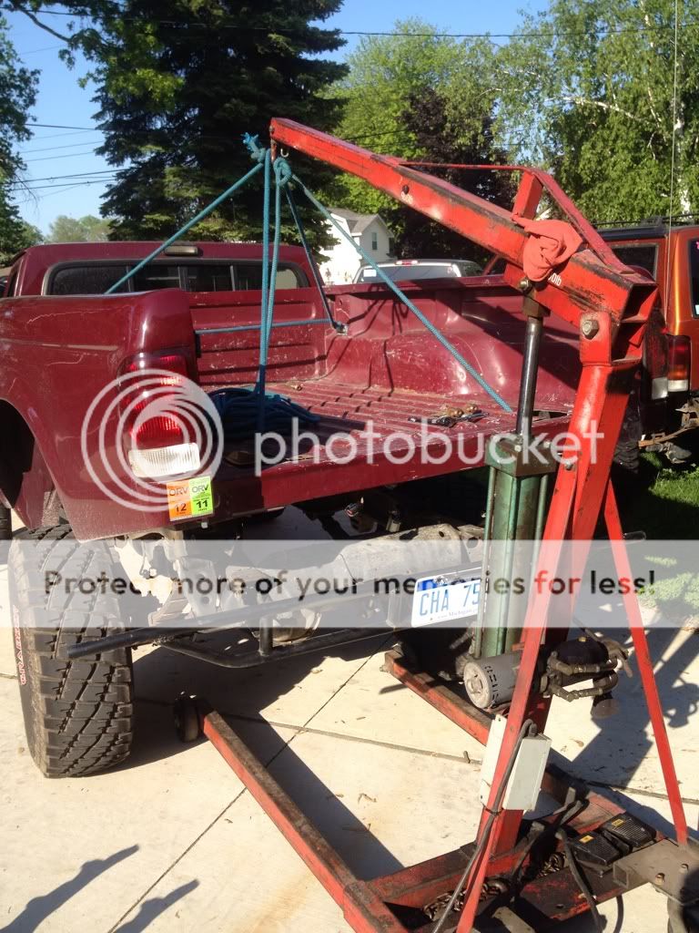

I'm getting way too good at taking the bed off. Just takes an elaborate system of ropes and my frankenstein hydraulic engine hoist haha

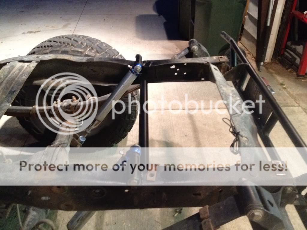

I cut my previous weld out and stretched the frame back to where it should be, pated the inside where it broke, welded in a cross tube, and tied the shock mount gusset into the new tube. It stiffened the frame substantially. I don't feel I'll have to worry about it again. Now time to find the next weakest link.
92 Pre-Runner Ranger
That welded in shock scares me. You should at least weld shock tabs off of the tube.
Mounting it like that is putting alot of force on the edge of the frame, and those will tear out with enough force. I remember you already seeing the results of that on the frame once. Dont forget to strap the rear, those are very cheap insurance, and you really shouldn't jump without them.
this is the only pic i could find of what i mean. welded to the frame may work, but its single sheer and bro fab if you ask me.
