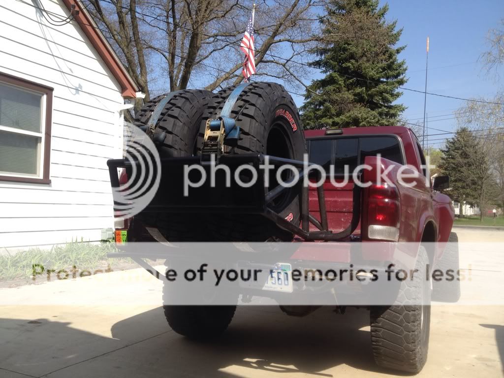

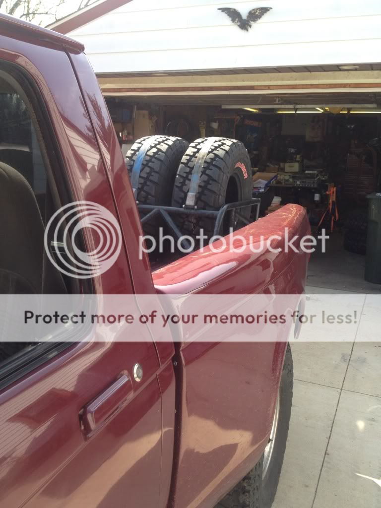

I'll be running a standalone MegaSquirt ECU and all the tuning software is already on my laptop along with a baseline tune that with this same setup running 22lbs, made 580 WHP thru an auto trans. I'll be running a T56 6 speed and 15lbs. I'm shooting for 500 WHP. The guy that sent me the tune is estimating way higher. Should be fun. Oh and I also have a stack of spare tires :3gears:
