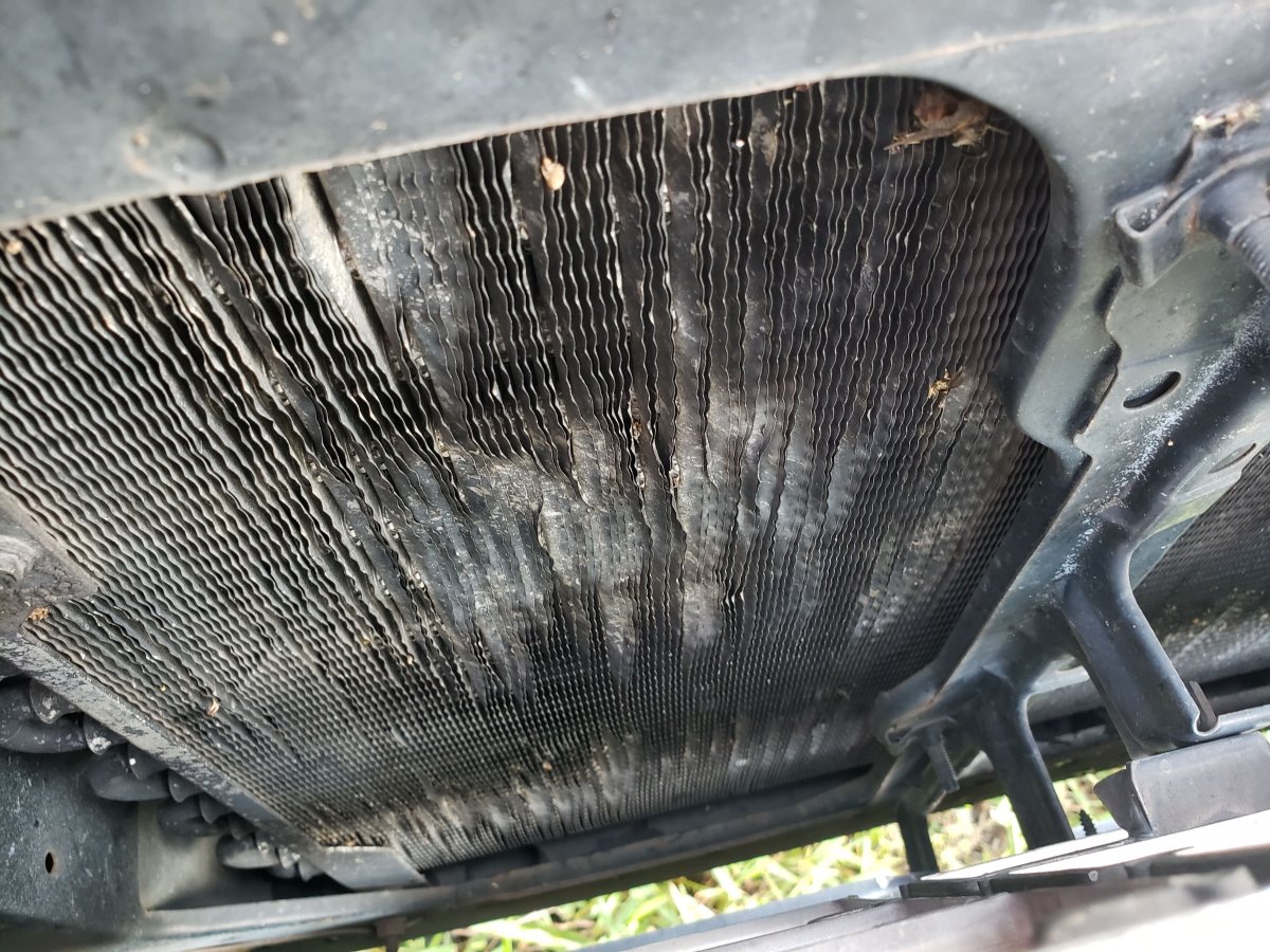

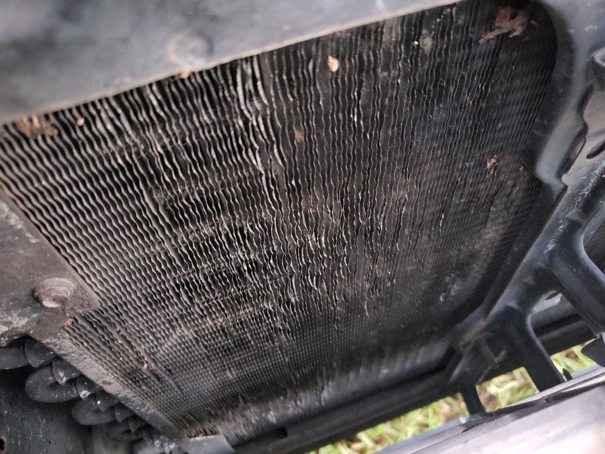

The condenser fins were all jacked up, which may have been contributing to my truck running hot in city traffic so I used a screwdriver to straighten it all out as best as possible.
Before-

After-

Definitely should have more airflow now.
