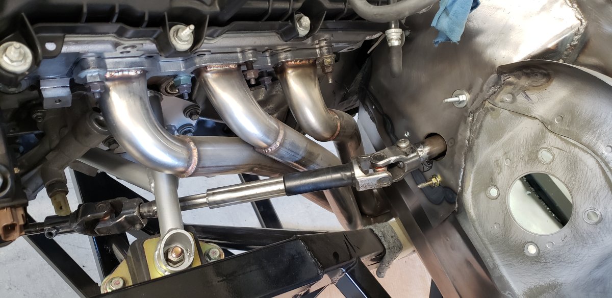

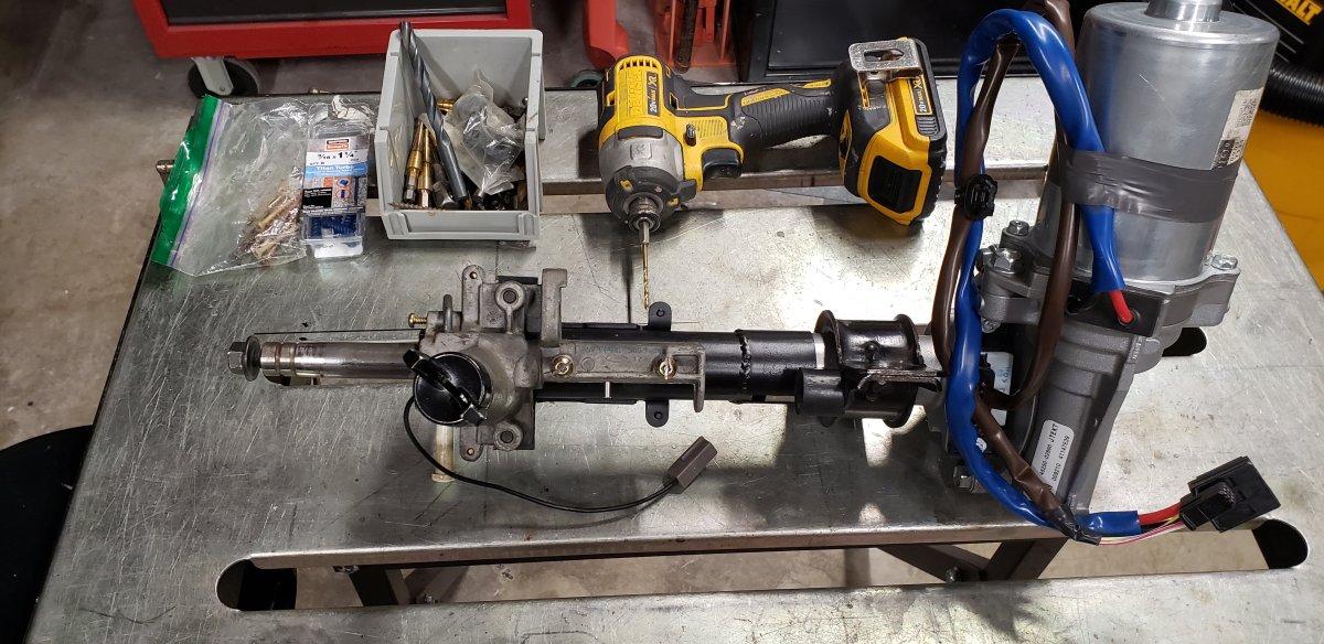

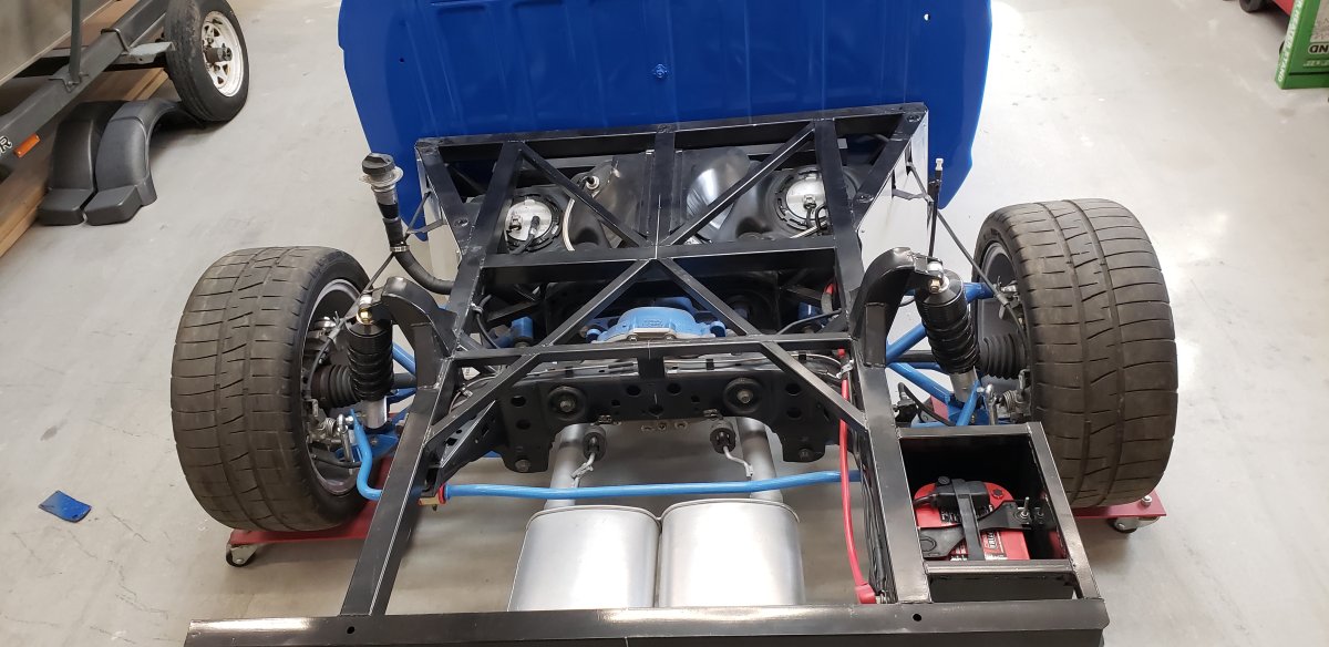

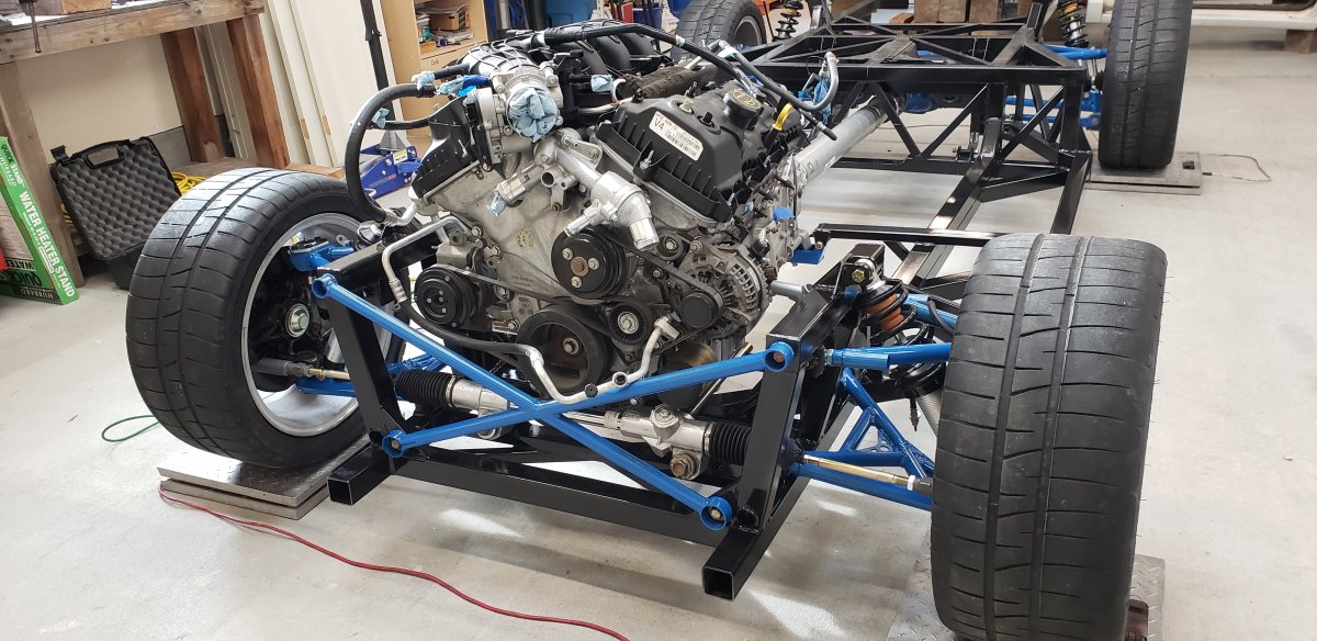

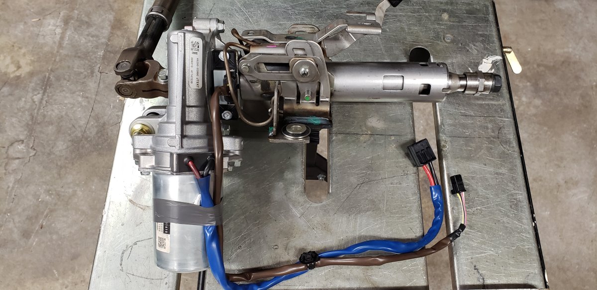

This is a complete Ground up build, currently working on electric power steering. 3.7 cyclone powered.
  • 87 Ranger GT (DD autocross Truck)
Cool truck @JimO
I am moving this over to the mini truck forum.
I'm guessing this thing is no longer on beams?
The EPS conversion is cool, but give us some more details on the build overall please.\

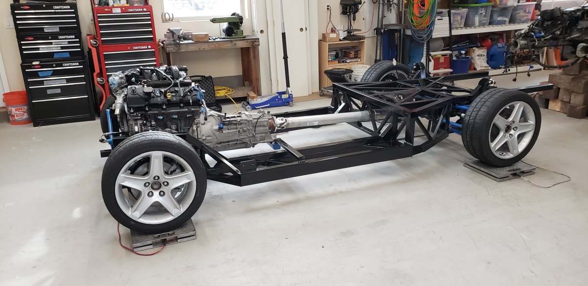

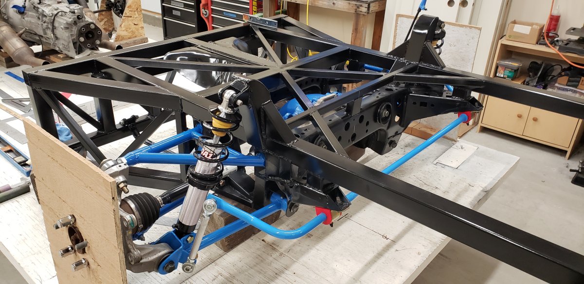

The chassis has double A-arms front and rear.
I've attached some pictures.
The chassis, suspension and steering geometry was a deep dive for sure.

Hey, thanks for checking it out. I've posted some more info. Feel free to ask any questions.

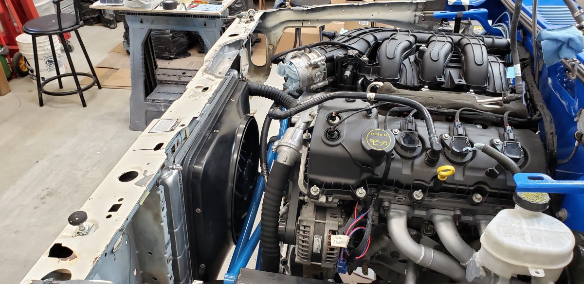

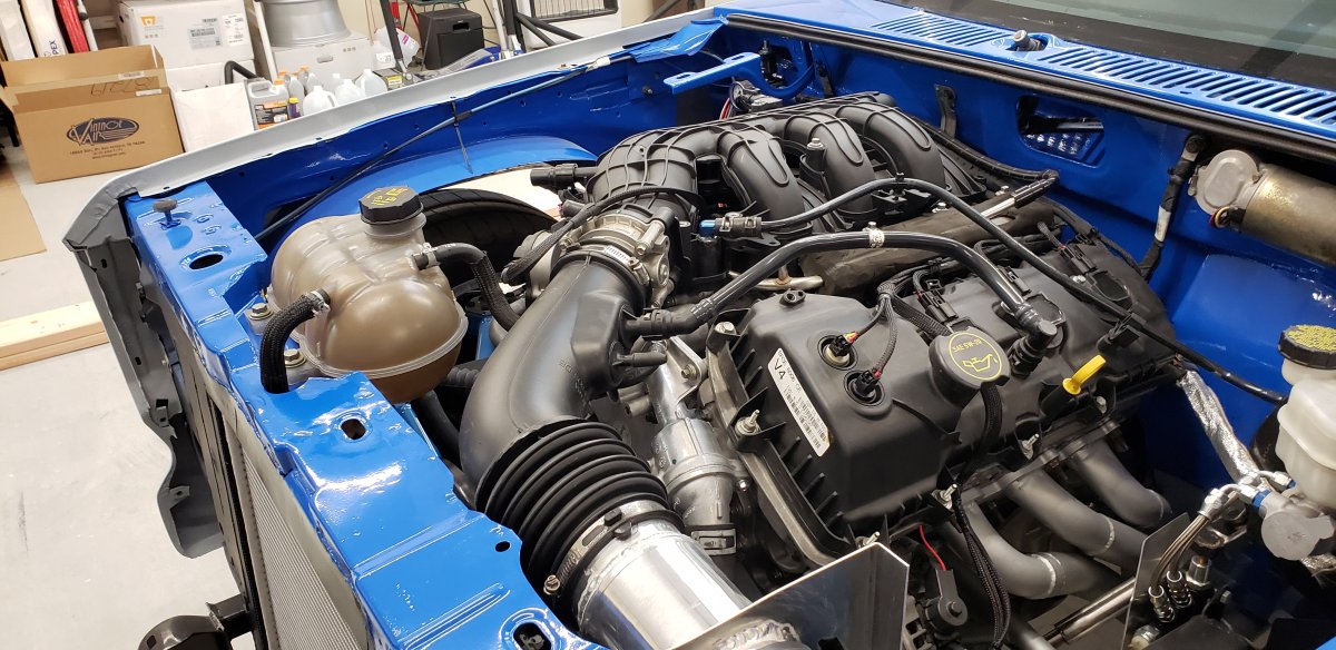

@JimO I am more interested in a minimalist engine swap with a Cyclone 3.7L V6 instead of 90% new fab (great work, btw). Could you elaborate on space and clearance:
1. Your fully assembled engine bay photo (114150.jpg) hints an electric fan for the radiator, true?
2. Do you think one can keep all stock A/C components?
3. Does it have a catalytic converter, and if yes what is from?
Hey, Thanks for checking out the build, the 3.7 is a great engine, it has the same forged crank and rods as the 3.5 eco boost.

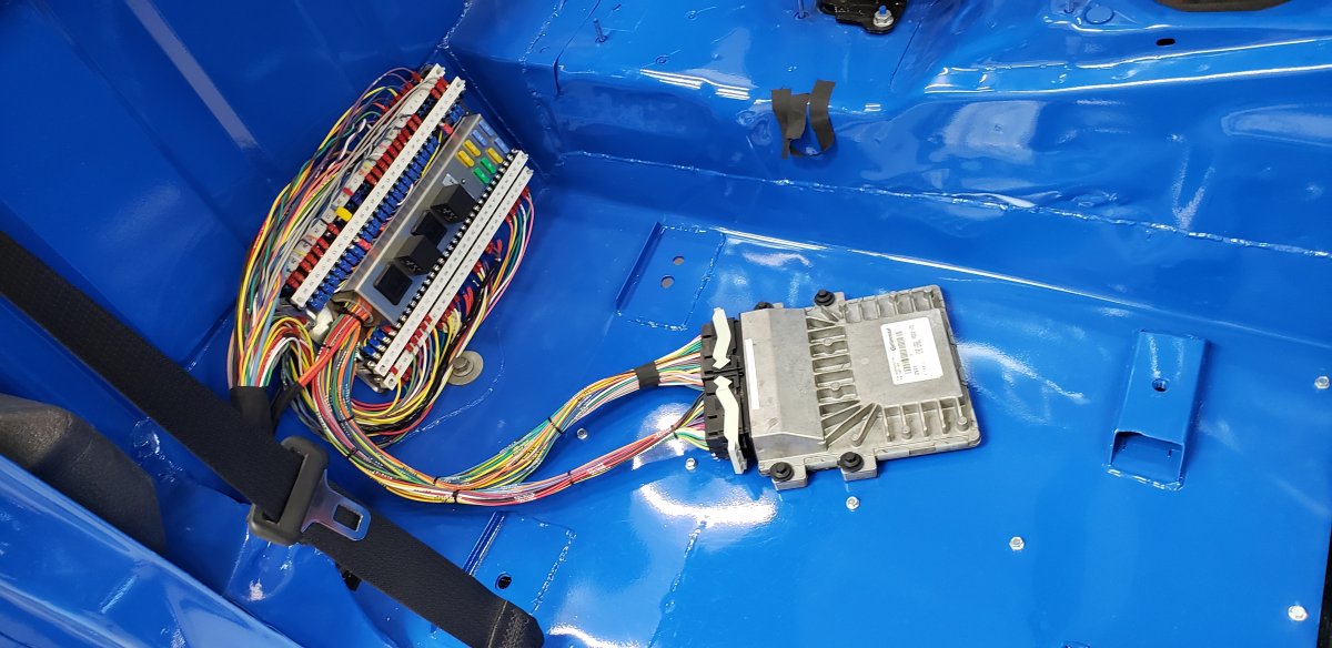

1) I run the stock PCM, so Electric fan is the way to go. I use HP tuners software too. I can program the fan temp. and all engine parameters.
2) I plan on running A/C with the stock compressor and a vintage air kit.
3) No, but it can be used if necessary. HP tuners can set the exhaust parameters too.
I have the engine dimensions from a web site some where. I'll post them if I can locate them.

@JimO Great shot of the fan without the intake and coolant reservior, plenty of room.

i probably would have went with the transit FEAD and conventional powersteering rack....
but i am a big fan of the cyclone. very under rated..... and potentially very cost effective.....especially as the hp tuner data base grows.
