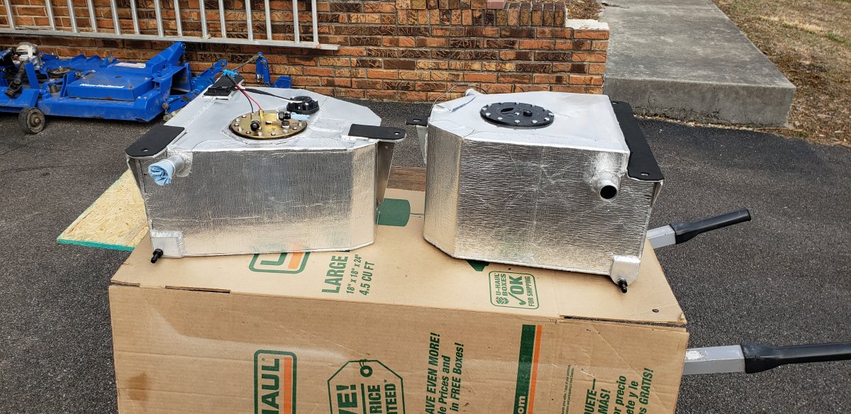

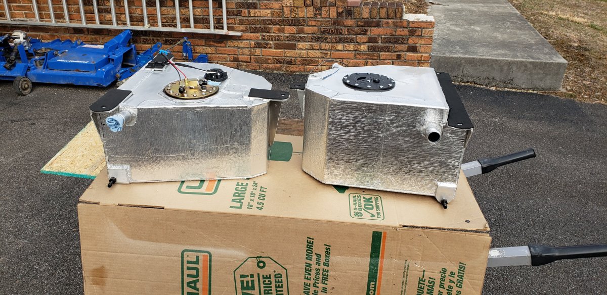

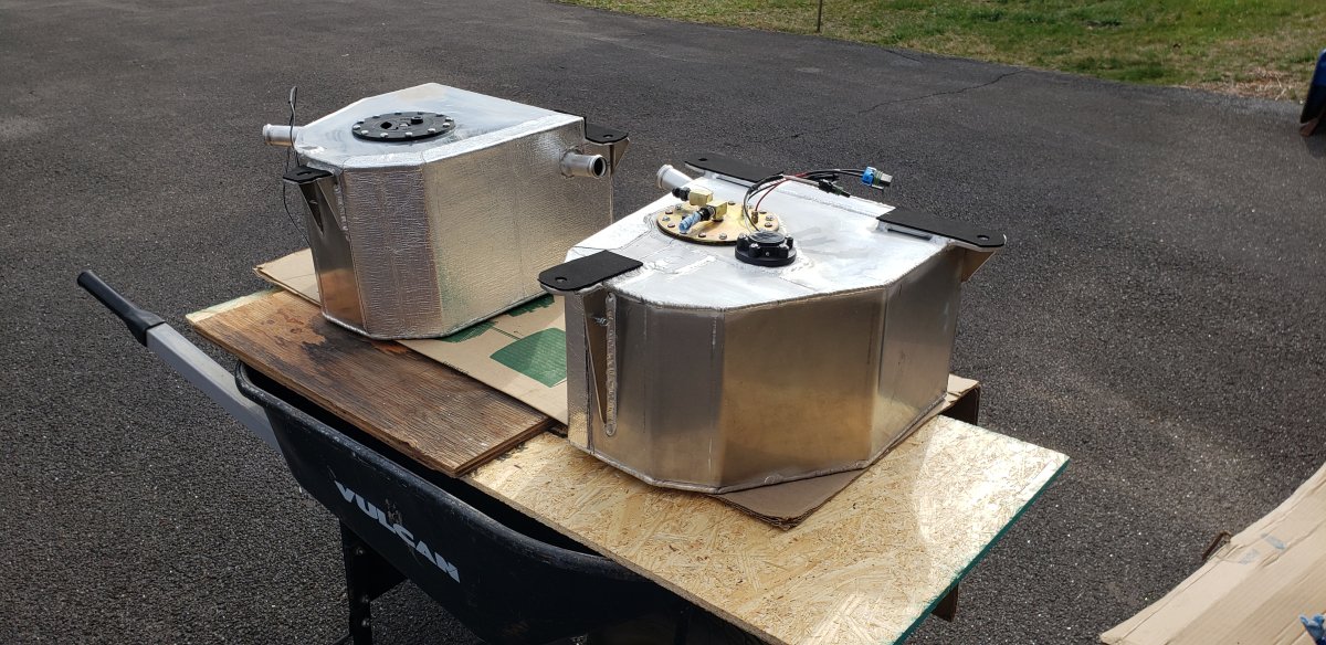

I'm currently building custom fuel tanks with a better fuel pump and fuel sender float. I'll post when I get close to completion.

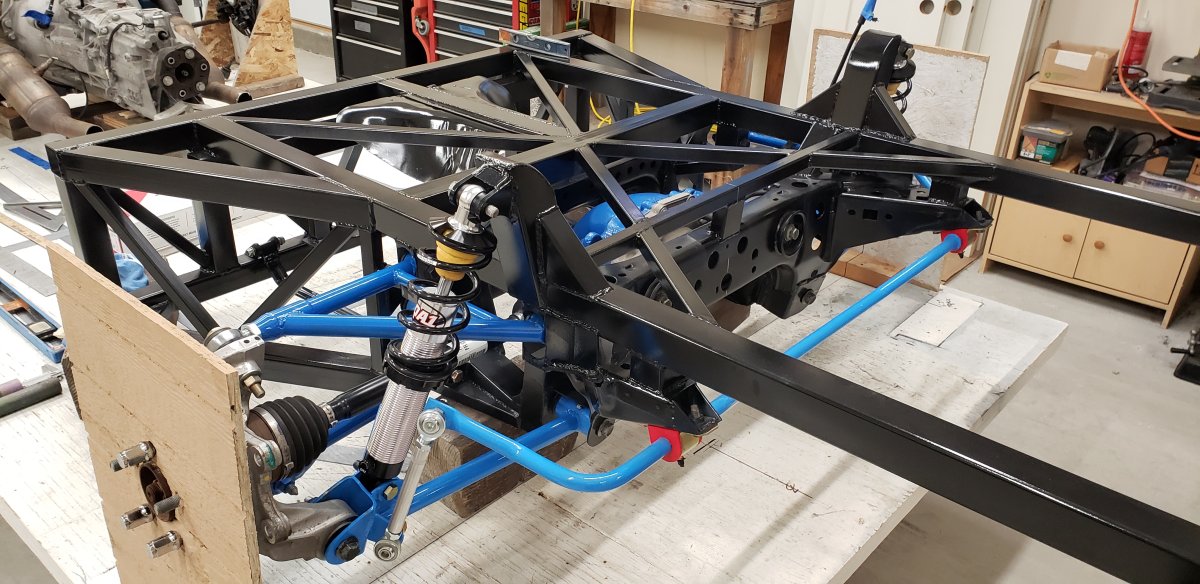

IRS is from a 2017 mustang. The rear suspension is a custom double A arm design.

Thanks and awesome job on your Ranger, very clean. I'm looking forward to completing the exterior this summer, one color, lol. I've scaled the truck a few times to corner balance (you can see the scales in the photo above) and it weighs between 2940 and 3050lbs depending on the wheels, tires and fuel level. I have some long nuts welded to the chassis, so a steel plate can be added under the rear mid section of the chassis as needed (you can see them in the photo above). When I build the composite hood, front bumper and install my race seat I may need to add ballast at that point.

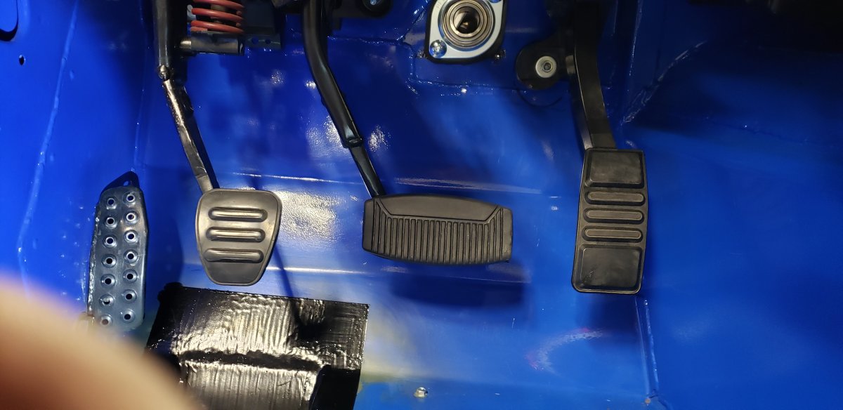

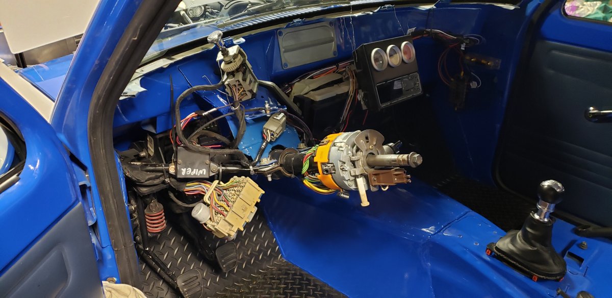

Hey Jim, here are a couple interior pictures. I'm in the prosses of hooking up the Vintage Air heat/AC as well as rebuilding the pedal box and fabricating the Electric power steering unit.
