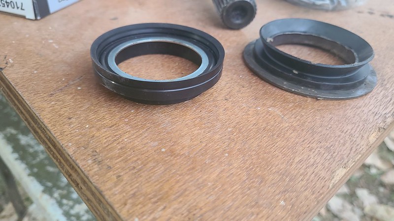

The cheesy little POS that I think is the cause of my fun.
'85 Ranger Restomod
Maybe a solid axle swap to something that uses a better seal design? But if your like me you prefer the t.t.b. even with the issues it comes with.
I think that area is an issue with everything.
The kerfuffle is the axle goes in and out of the spindle slightly as you steer so you have that to account for, it isn't just a shaft spinning in a housing.
We fought and fought that area leaking on tractors too (they have gear reduction in the front hubs and had hydraulic oil in the hubs to leak out) They had a fancy "bellow" seal that actually required break-in.

My truck had a flat-ish plastic ring/slinger that backs up that seal. One of them is missing and I doubled up that seal when I did mine a few weeks ago. I haven't checked stuff yet to see how mine looks after the trip. How are your big o-rings on the back of the hub? I could send You a couple new ones if you need them.
Yeah, the spindle bearing kits came with new seals, plastic spacer washers, dust boots and spindle bearings.
'85 Ranger Restomod

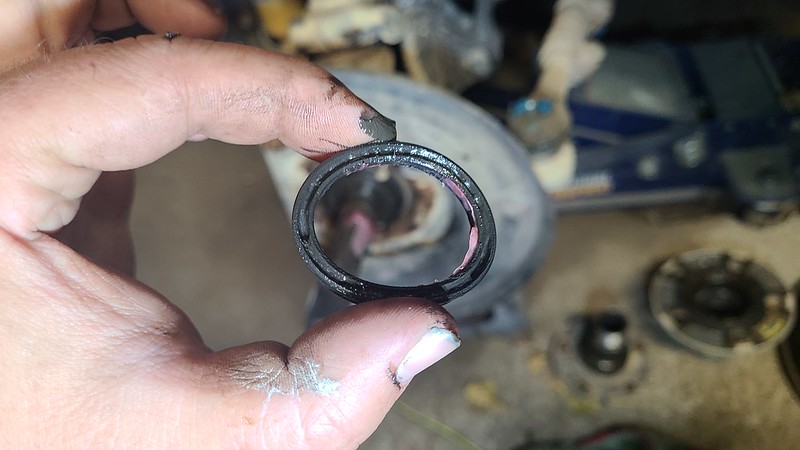

The back side of the seals were nasty too. The dust boots are nearly worthless imo.
One hub o ring was new last December, second was has been on the truck since August.
And I know when you play in water this kinda goes with the territory.

Cleanup/inspection continues, I thought I found a better dust seal but it doesn't go on the shaft far enough, leaves like a 1/16" gap. They don't show this seal for a '94 front axle, I swapped the axle shaft last winter so I wonder if it is machine differently for this style seal to work on the newer axles.

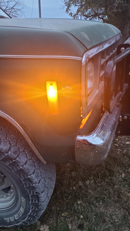

Last week I won a new set of bulbs from @LASFIT's Halloween giveaway:
How Did You Decorate Your Vehicle for Halloween Last Year? Let’s Share Ideas! 🎃🚗 | The Ranger Station
I have tried LED's in my front marker lights before, generic white ones wash out the amber lenses so I stuck them in for my license plate lights and went back to incandescent. So when given the option this time I chose amber bulbs in hopes that it wouldn't overpower my lenses.
194 168 2825 Amber CANBUS Error Free Side Marker Turn Signal Light (lasfit.com)
I received them pretty quickly, they shipped out of California Thursday and showed up today.
'85 Ranger Restomod
'85 Ranger Restomod
Well it is certainly still amber...
'85 Ranger Restomod
And slightly brighter than the old incandescent.
